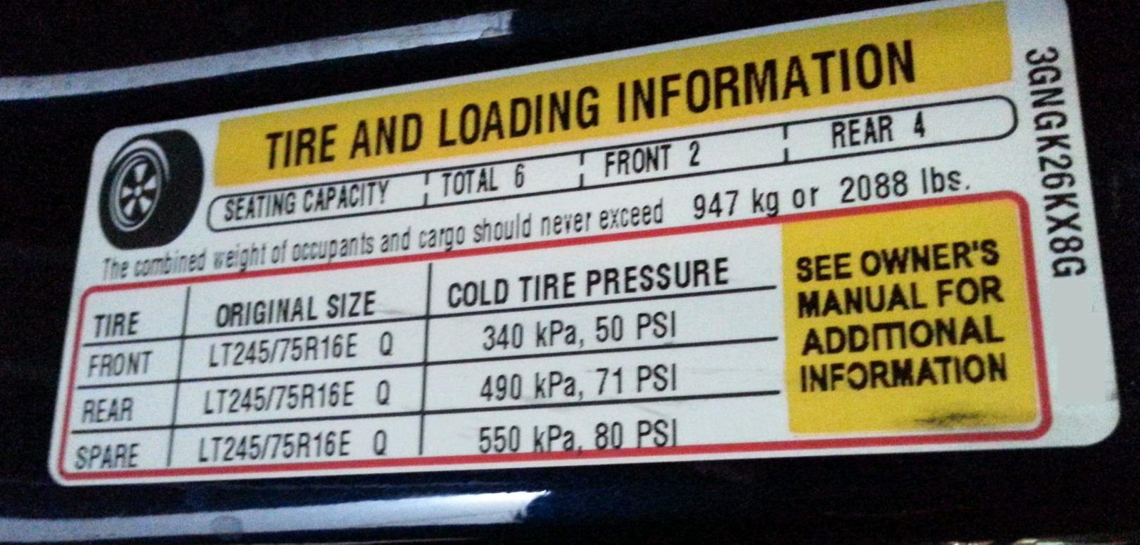

2500 recommended pressure is 50psi front and 71psi rear.
1500 recommended tire pressure is 30psi for 17" wheels and 32psi for 20" wheels.

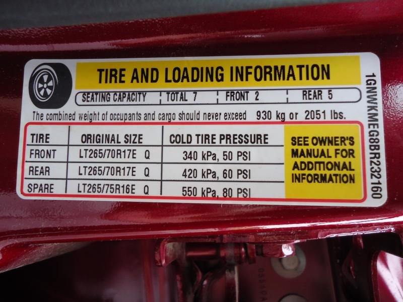

71 or 60?

71 or 60?
Posted by @intheburbs if I remember correctly.

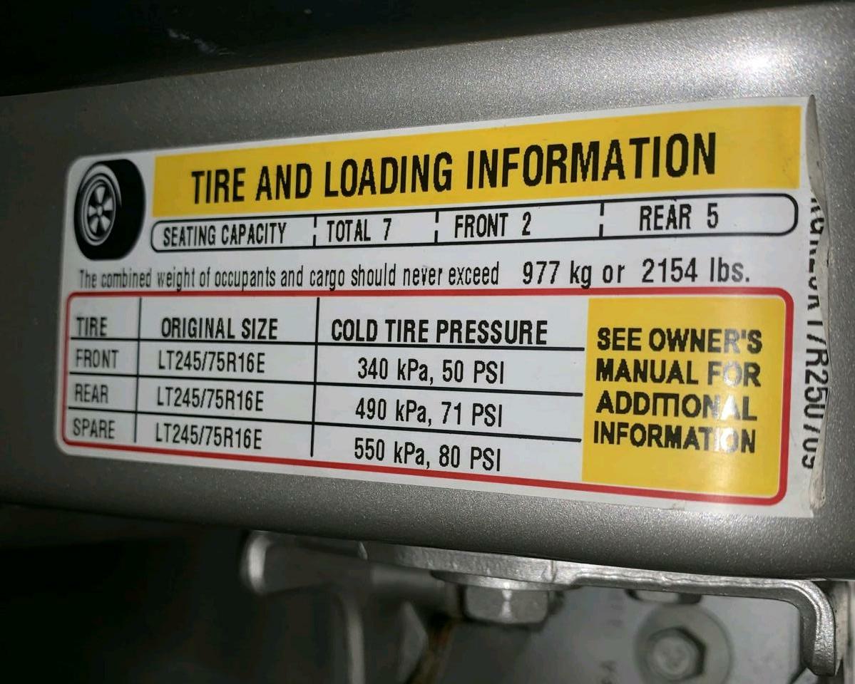

I'll see your Tire and Loading Information with 16" tires and raise you 17" wheels!
We got quite the knowledge base here!
Well technically the OP has 18" wheels but that is irrelevant because his truck will still be looking for whatever PSI the BCM was programmed to look for. Whatever his door tag says is what should be followed.
My bet is the tire shop set his pressures at 35psi as that is pretty SOP around most tire shops.
I think you're right Ken! Totally missed that!
Does he have 265-65-18s? Another door sticker to get hold of!
