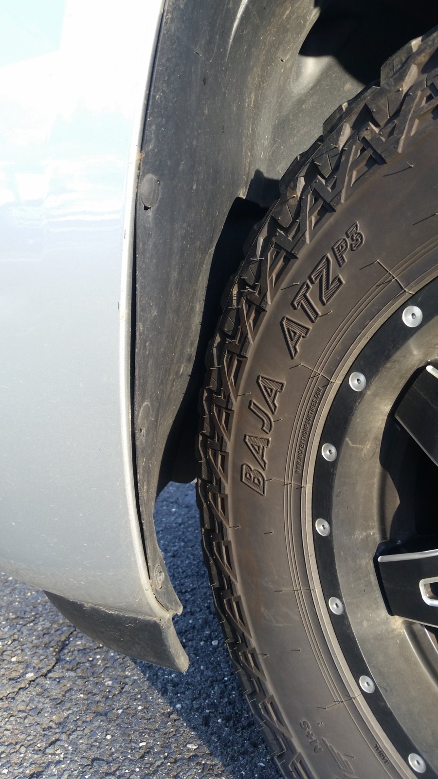

I bought a 2007 Yukon XL
2500 and the previous owner had installed some brand new Michelin 275/65/18 tires. They look real nice but rub when pulling out of the drive way. What are my options? Is this normal for these to be rubbing?

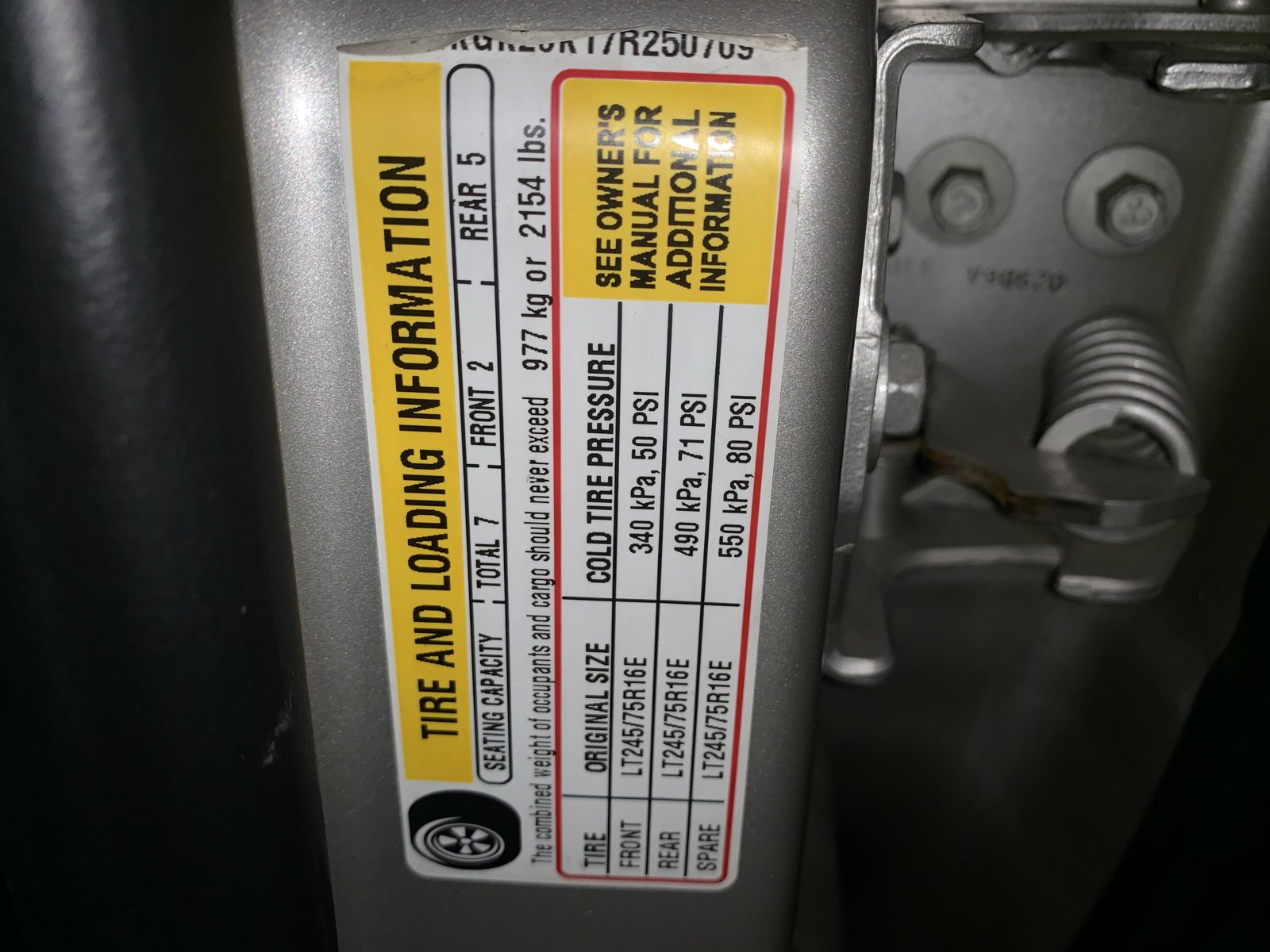

Check your drivers door jam and see what the original tire/wheel size was.
If I'm not mistaken I believe the 2500s came with a 16" wheel. So it's quite possible that with the bigger wheel/tire that the overall height is taller.

The sticker I am referring to will be inside the drivers door jamb. It is the factory sticker that tells you the tire size and pressure.
It should look like this...
This one ^^^ was posted by @intheburbs in another thread. He has a 2500 as well.

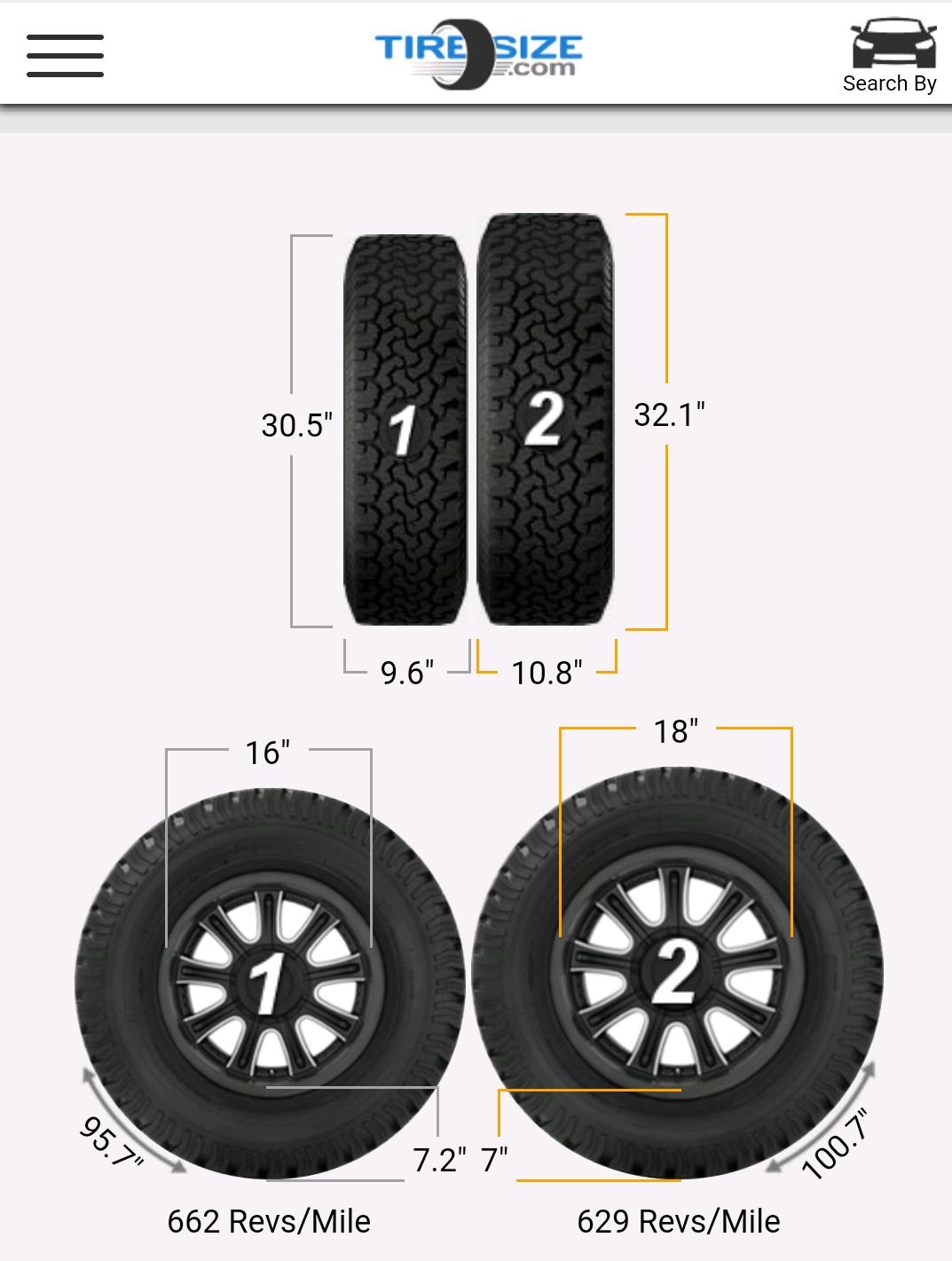

Here is some more interesting info to chew on...
A little over 1" wider and a little over 1.5" taller, which would only equate to .75" closer to the fenders in any direction.
It also affects your speedometer if the truck wasn't retuned to compensate for it.

Here is the sticker from
the door jam

You have to see where its rubbing. Spacers help if you're rubbing the frame or sway bar, which is common when running larger tires on stock wheels.
Those wheels probably have a more negative offset then stock which normally caused rubbing on the fender liner. Adding spacers in this case will make the rubbing worse. You might be able to raise the front via torsion bars .5-1" (then get an alignment)... might be just enough.

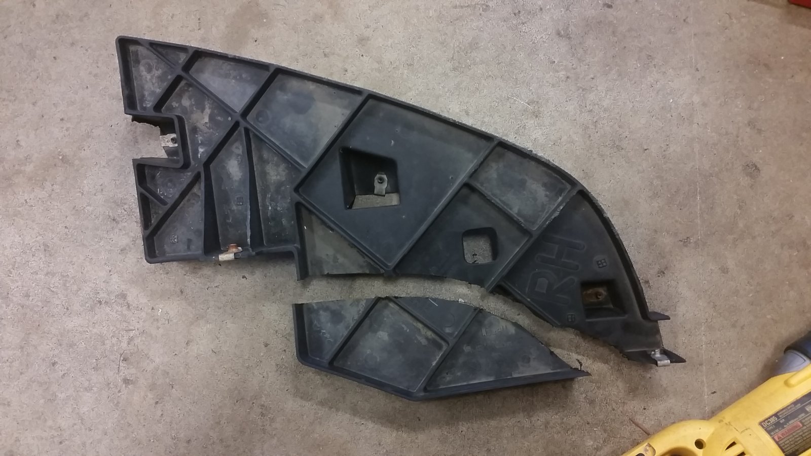

If you're rubbing the front fender liner you can trim the bumper support bracket and reshape the liner

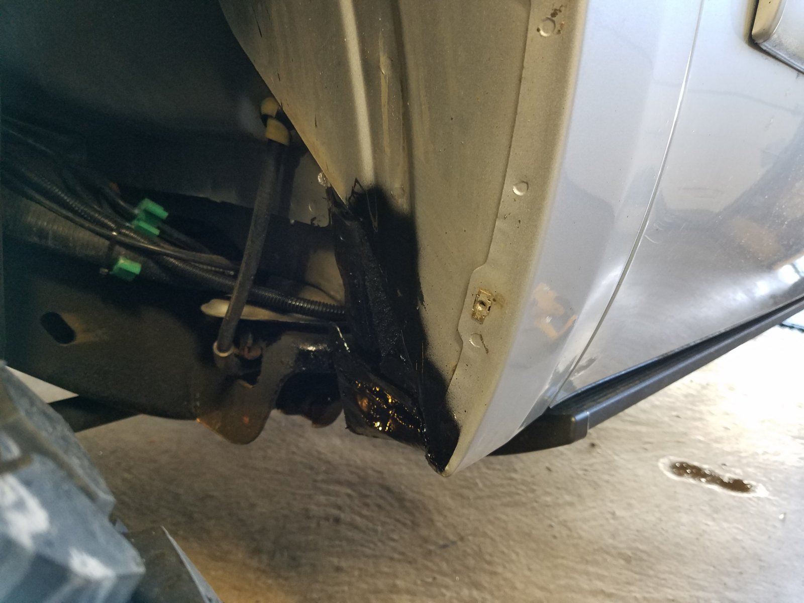

If you're rubbing the rear fender liner, you can do a large or small "norcal fender mod" (google for instructions). When done correctly everything looks factory and you gain a lot of tire clearance. I've done this on all 3 of my GM trucks (and a few friends trucks)
Before putting the liner back on :
