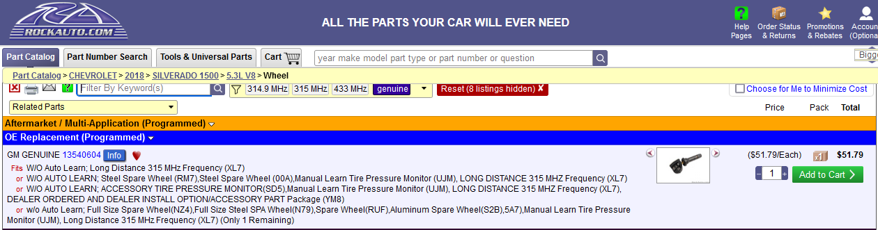

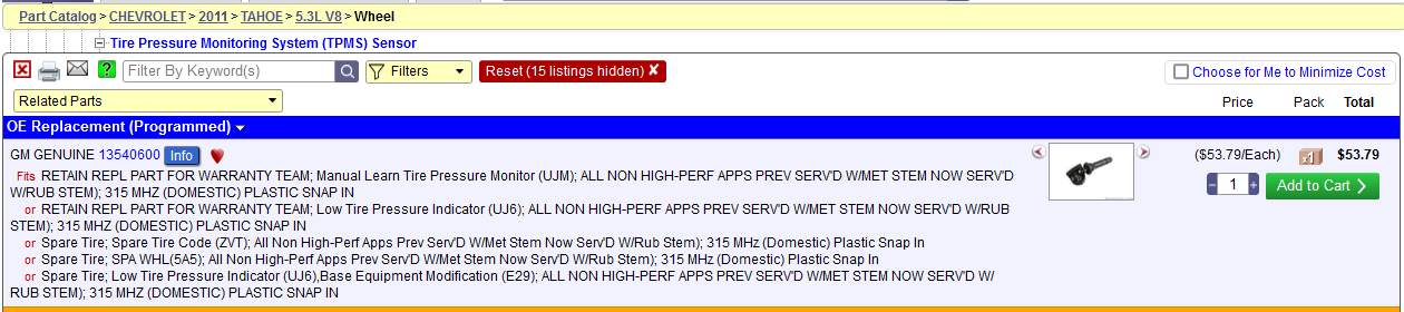

FWIW the GM TPMS sensor part numbers are different between 2011 and 2018, even though they're the same frequency. Not sure if that's a problem.
2018:
2011:
