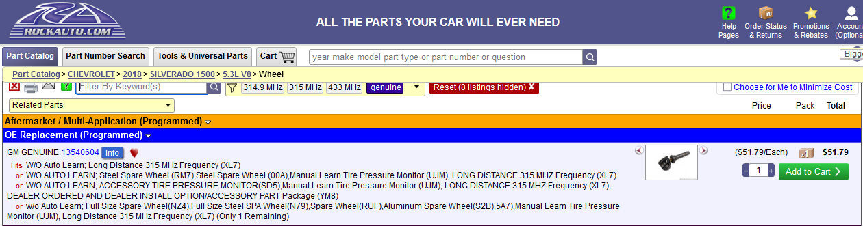

I purchased a used set of 2018 Silverado rims, and tires. Both sets of rims claim to have the same frequency sensors, 315 mhz. after installing these rims and tires, I'm left with the same result. Can not re learn tire position, and when checking the pressure readings on the DIC, I just get blanks.
