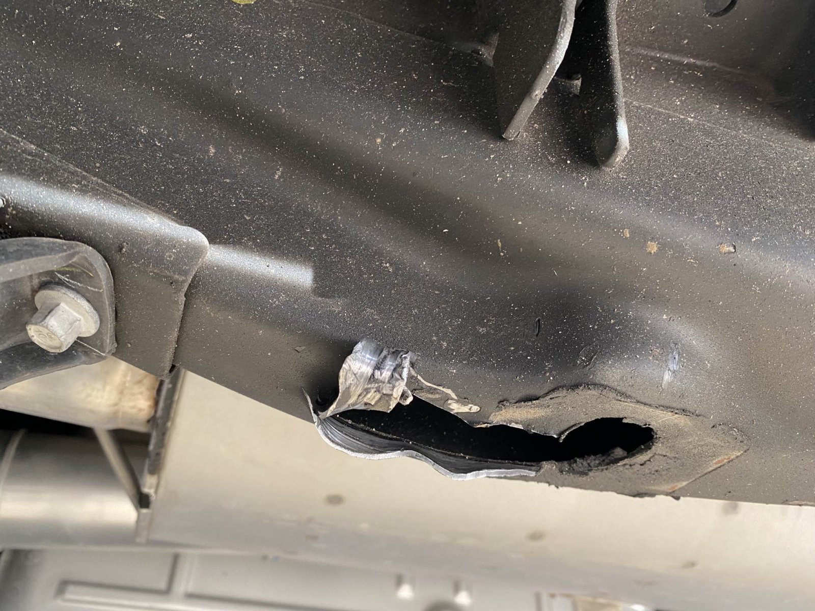

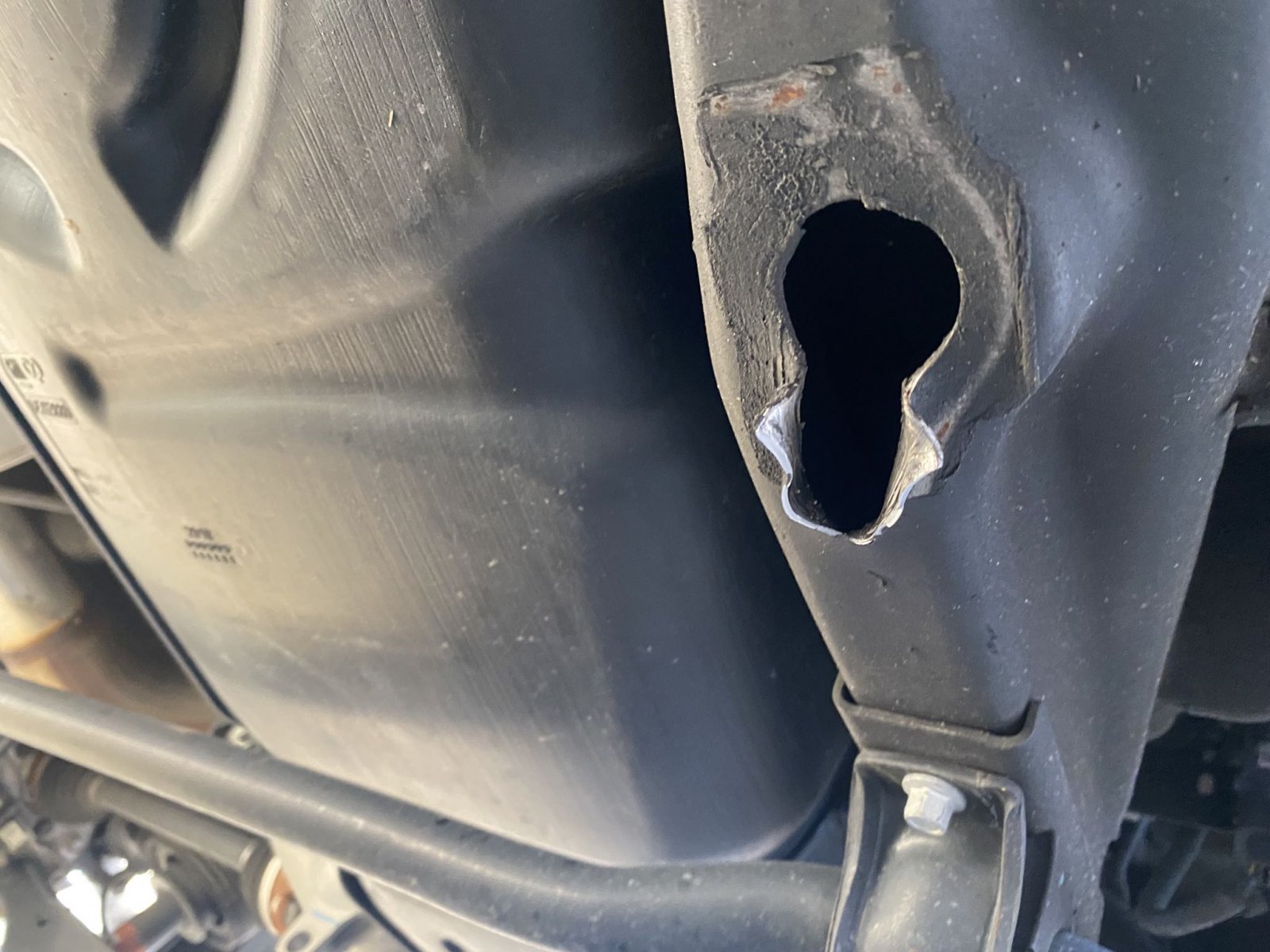

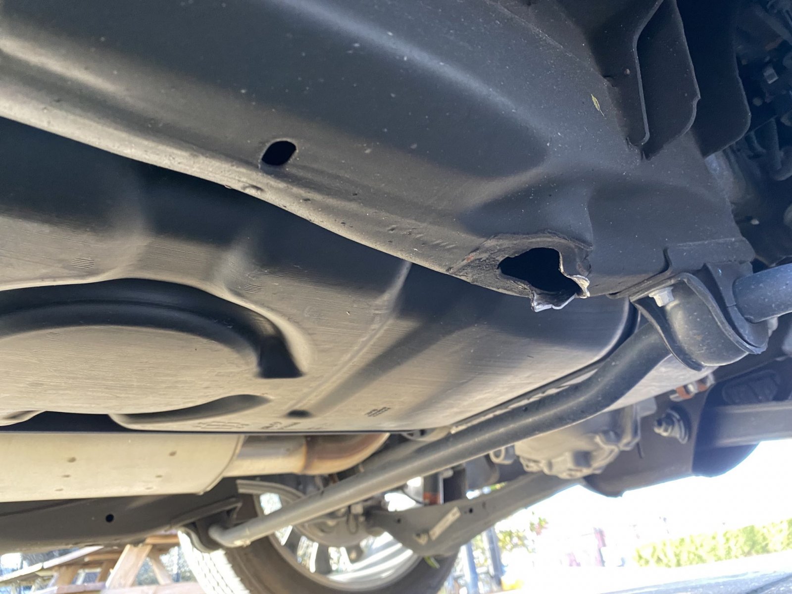

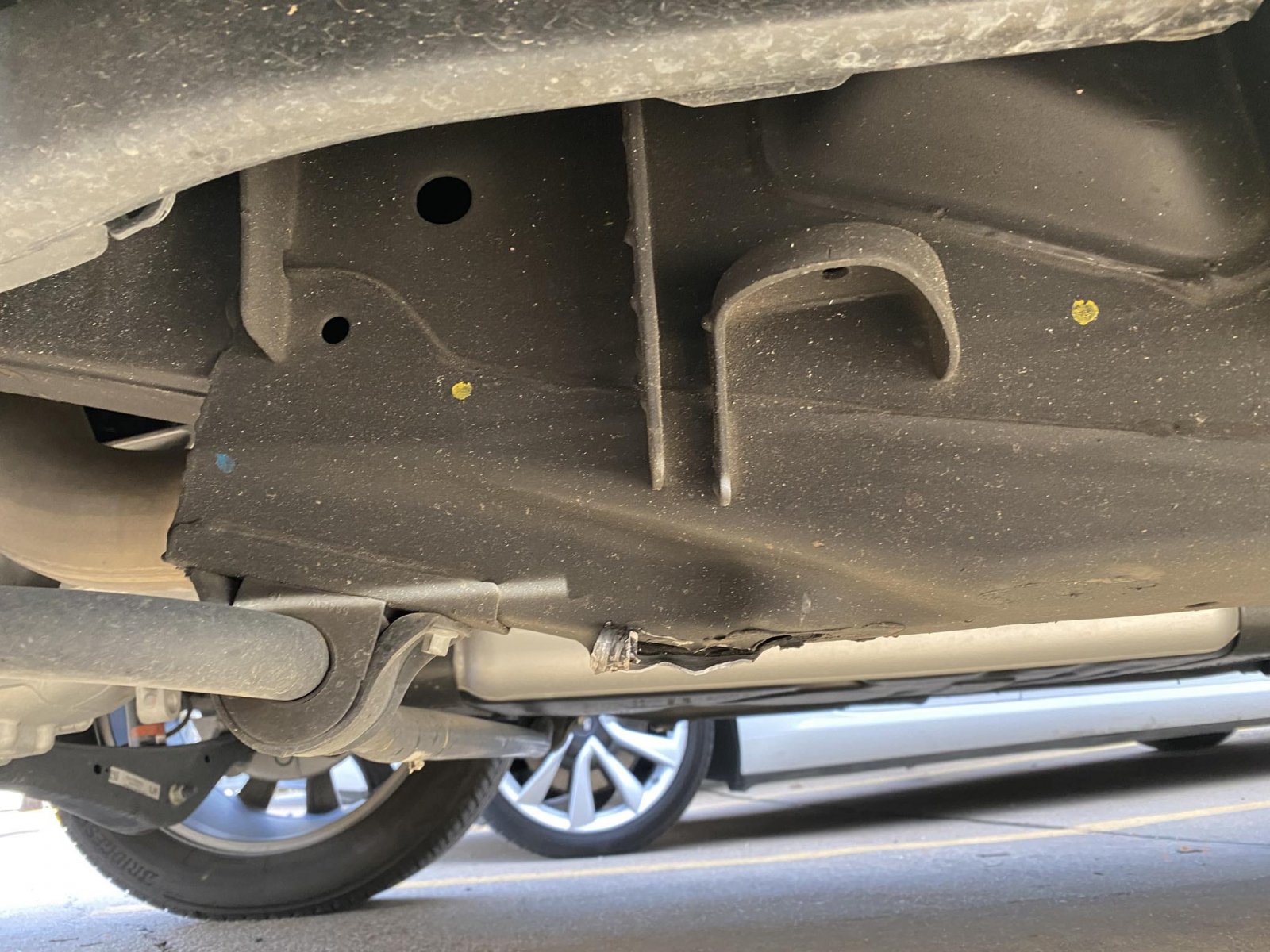

Hi All, I will save the long backstory, but I had to have my 2022 Yukon towed in with a failed lifter. In the process, the tow driver ripped through my frame on both sides from hooking up the rear of the truck on a flatbed and then tightening them too much on the winch. GM roadside, which is not run by GM, is a nightmare to deal with so I went to two body shops to get the prices started. The first said it should not affect frame integrity and could just be cleaned up for looks. Another body shop said the entire frame needed to be replaced. Any current or former body shop guys with an opinion?
It’s going to be a fun new year sorting this out with GM roadside.

The towing company ought to pay to have that fixed. I would not say that the frame is compromised but would put it on a machine to be measured on their dime just to be sure. The guy who did that did it deliberate, jerk.

This is not a question for your average body shop IMO. I would be wanting to hear from someone who does frame repair, a body shop with a frame rack.
By my eye, given that it is in a bend on the frame, that is already a natural weak point. I would not say it were intentional on the part of the rollback driver... those winches have a lot of pulling power and it's easy to go too far on accident. Certainly negligence, though.
To me, the frame is torn. The tear needs to be cut out, the end of the tear radiused, and a plate welded over the section to reinforce. A lot of shops won't weld on frames anymore, would rather get you (or someone) to pay them for a frame replacement, but this is a pretty simple repair. Look for a welding fab shop to do the structural repair and then take it to whoever the dealer recommends to get the factory undercoating re-done in the repaired area. That, or have the whole undercarriage re-coated.

Back in the day, I did my fair share of towing. I wonder if the driver used the J hooks or the T hooks, but either way, when you set tension, you just need to hunker down the suspension as little as 1" and all is good and that may well be the thinnest frame gauge I have ever seen. Bet the guy was high. Idiot.

As I stated in other post OP has this is Dealer GM problem, they sent roll back to retrieve vehicle it's their problem needs to demand new vehicle or buy back those holes and slots are used to straighten frame that are racked from collisions I would bet frame is tweaked with that much pull put on frame. Bad situation but need to get with service manager to get GM regional manager involved.
