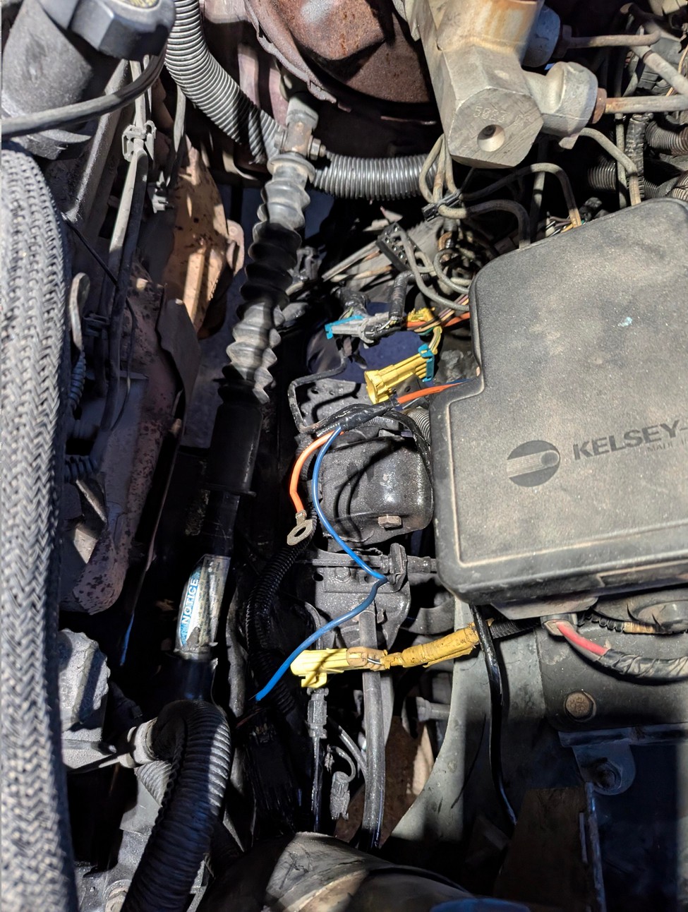

Intro photo is just a nice shot, second photo is where i need the help.
I have two yellow female plugs that look like air bag plugs and i have no were near by to plug them into, fairly certain the harness is in the wrong spot from the body shop that did my frame swap.
Second issue is the blue and orange cable that run from here to the tow hookup that are also not connected to anything. No idea where they need to be plugged in at or if theyre an aftermark something or other that was uncovered during the frame swap.
Overall im really stumped as i have no brakes and no rear lights and i dont see anything obvious as to why aside from the photo, and one pigtail with no mate near the tow hitch that gets 12v on one of its 4 pins

The blue and orange are most likely the power and brake signal leads for the trailer connector. Blue would go to a brake controller if you install one and the orange to the fuse block stud for aux power. Be sure it's fused.

I looked at our 97 Tahoe and the yellow connector goes from the frt. harness to another yellow connector from the main through firewall harness.

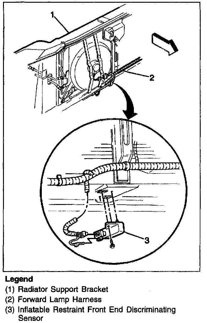

Check your front end for crash sensor for air bags, you might be missing that front harness.
As far as brakes, lines were disconnected for swap. Bleed them and ABS.
Possible to get a photo of that. I'm not seeing a mate near there

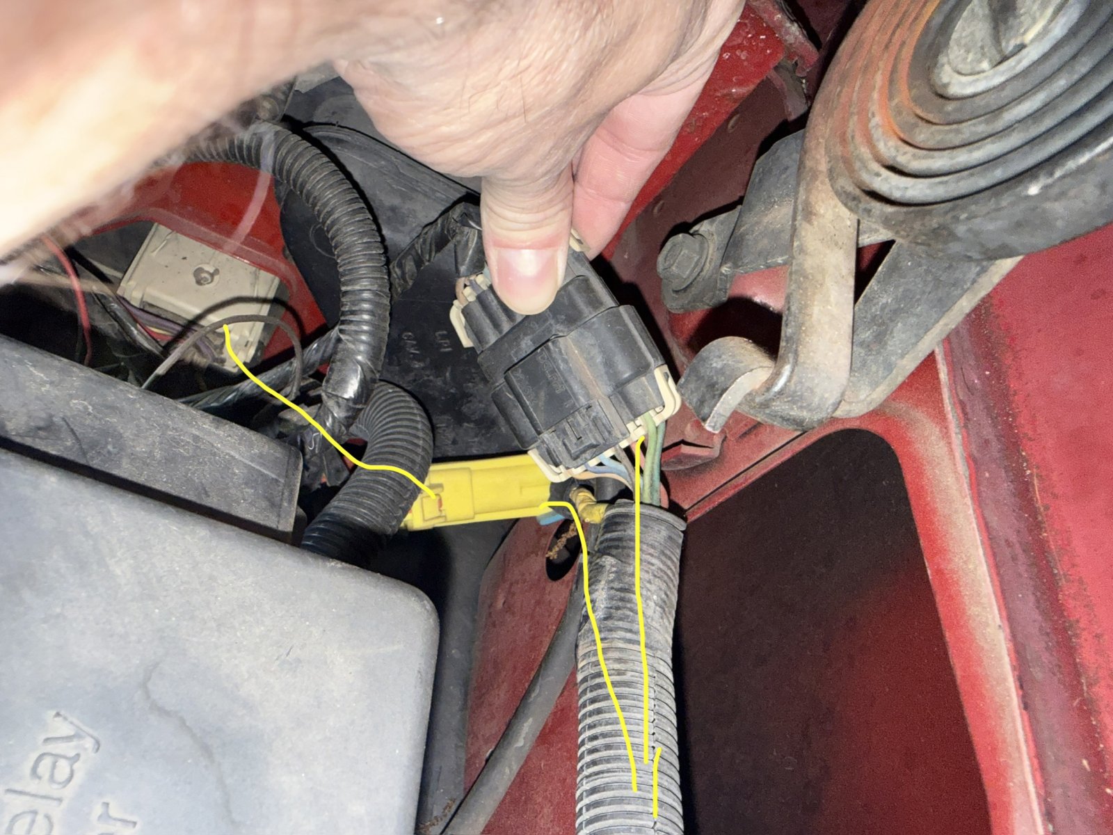

Not sure if this will help since mine is a 98, but the airbag impact sensor is behind the grille. There’s a connector right at the firewall. The picture isn’t the best, but I drew where the wires go.
Very odd. On my truck that's a 2 wire yellow connector and it's complete, but I have a harness coming from under the cab that has an empty 4 wire connector and an empty 3 wire from the harness going to my ABS
