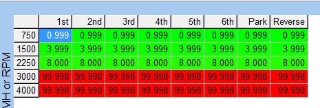

Here is a stock table, the numbers are % of throttle allowed. You can see it is very restrictive down low. If you do decide to change this we would love to help, feel free to call or email any time.

Naomi, may I ask where you got that table from? Granted my experience rooting around with tables in EFI live is somewhat limited, but that does NOT seem right for a regular Tahoe or Suburban...at least not based on the tables I've seen before.
Perhaps Jenna can chime in with her opinion on this, she'd be a far better judge of that table's accuracy that I am.
Yeah, there's no way that's right. I would "guess" that 1st gear would be around 60-70%. But not less than 1%. The truck wouldn't move......

First of all yes this is a stock table from your generation truck. The reason you can't see it is because you do not have a workshop version edition. And like you said your experience is very limited which is why you should trust me, the person who knows what she is talking about. If you want advice please don't knock down the correct answers. I went out of my way to open the file and find the one you want, so a thank you would be more appropriate.
What's with the attitude? Not necessary...especially as a brand new forum member who's trying to drum up business. Not all of us are complete idiots when it comes to EFI Live and reading tables. On top of that, you DO NOT need a workshop edition of the software to view the stock throttle tables, the software is available for free on EFI Live's website for anyone to use and access and works just fine. I literally just looked about a half hour ago, sitting in my truck.
I was basing my post off of the fact that for 2007-2009, the throttle percentages are 100% across the board for the 5.3. The delay, for whatever reason GM decided to put it in, was introduced in 2010. Be that as it may, the data you posted still isn't accurate for a 5.3 Tahoe, even a 2012 like the OP owns...at least not based on what I'm looking at. Besides that, the chart only tells you the rate at which the throttle opens, not the maximum amount of total throttle % allowed. I have a 2007 (so admittedly that is what I'm familiar with), hence my question asking you to clarify. I wasn't trying to be an ass, I was asking you to clarify what vehicle the data came from...and you come back with a rude and dismissive post essentially calling me a moron?

Op did not say a model year so I grabbed a file from a 5.3 tahoe of this generation that shows typical throttle restrictions and sent it to Naomi to use. Even in cases where the restrictions in this table are less than this they can be found elsewhere in the program. I stand behind her original answer that there is a lot of power management in that area and a noticeable difference in performance comes from eliminating these interferences. I also stand behind her other comments as she was rudely addressed even after working to help answer someone. As far as answering a lot of threads that is her job and she does know much more more about these matters than most members. She is due respect and will continue to prove it, your judgement of her life style etc is not needed here.

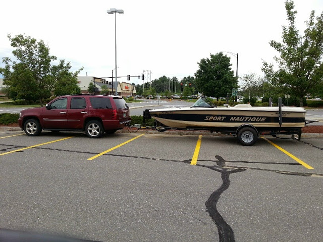

Thanks for following up Jeff. Nice boat! I tow a 21' ski boat with my Tahoe, I figure 4,500 lbs. total, and it pulls it easily. Your boat is obviously quite a bit heavier at 6,000 lbs. total, so I can see the 6.2 doing the job for you better, though still would have expected the Avalanche to tow it ok. I'm guessing you do more boarding than skiing with that boat.
Here's mine behind the Tahoe:

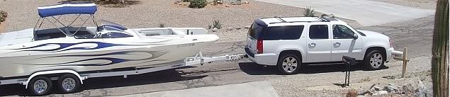

Yea I would say that something was a miss. I towed my 8.5X20ft V-nose with out a problem with my Tahoe. Empty it weighs 4100lbs. but when I moved the whole set weighed 17K. Yea I know thats a lot more than i should have towed with the Tahoe, but it pulled the trailer from SC to NV with out a problem. But I was not in a hurry and didn't push the truck. I never plan to do that again just so you all know.
