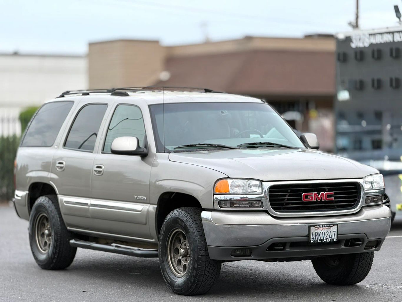

I am now a 2001 Yukon SLE owner, and OF COURSE I have a couple of questions.
The driver's seat suffers from the left buttcheek sag and it could use new foam. I don't want to use a janky looking booster seat, so am I looking at an upholstery guy to do this (I know a good one) or does anyone have suggestions? Good news though, it's a cloth interior and the upholstery is in really good condition.
I noticed it pulling a bit to the right sometimes when coming to a stop. I've yet to check PSI but the (matching) tires are all in good shape. The alignment seems fine other than this, get the alignment checked or something else with the front end, camber etc to look at? No vibrations, weird behavior etc otherwise.
The oil pressure needle jiggles a bit on some bumps, it's working ok, so I assume this is just a funky old gauge that might need replacing.
Things to do: the PO installed a huge godawful Android tablet so I might go back to an OEM radio or find a small screen dealie that actually fits in the radio slot. A couple of broken/cracked interior trim pieces that shouldn't be to hard to find at the Pick N Pull.
Anyway, nice to be here and here is a pic:
