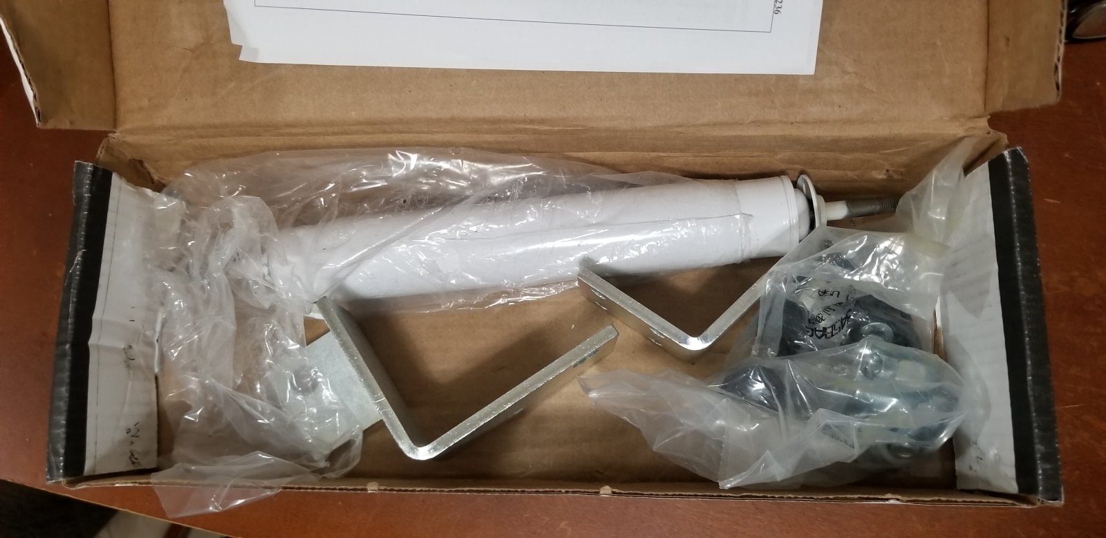

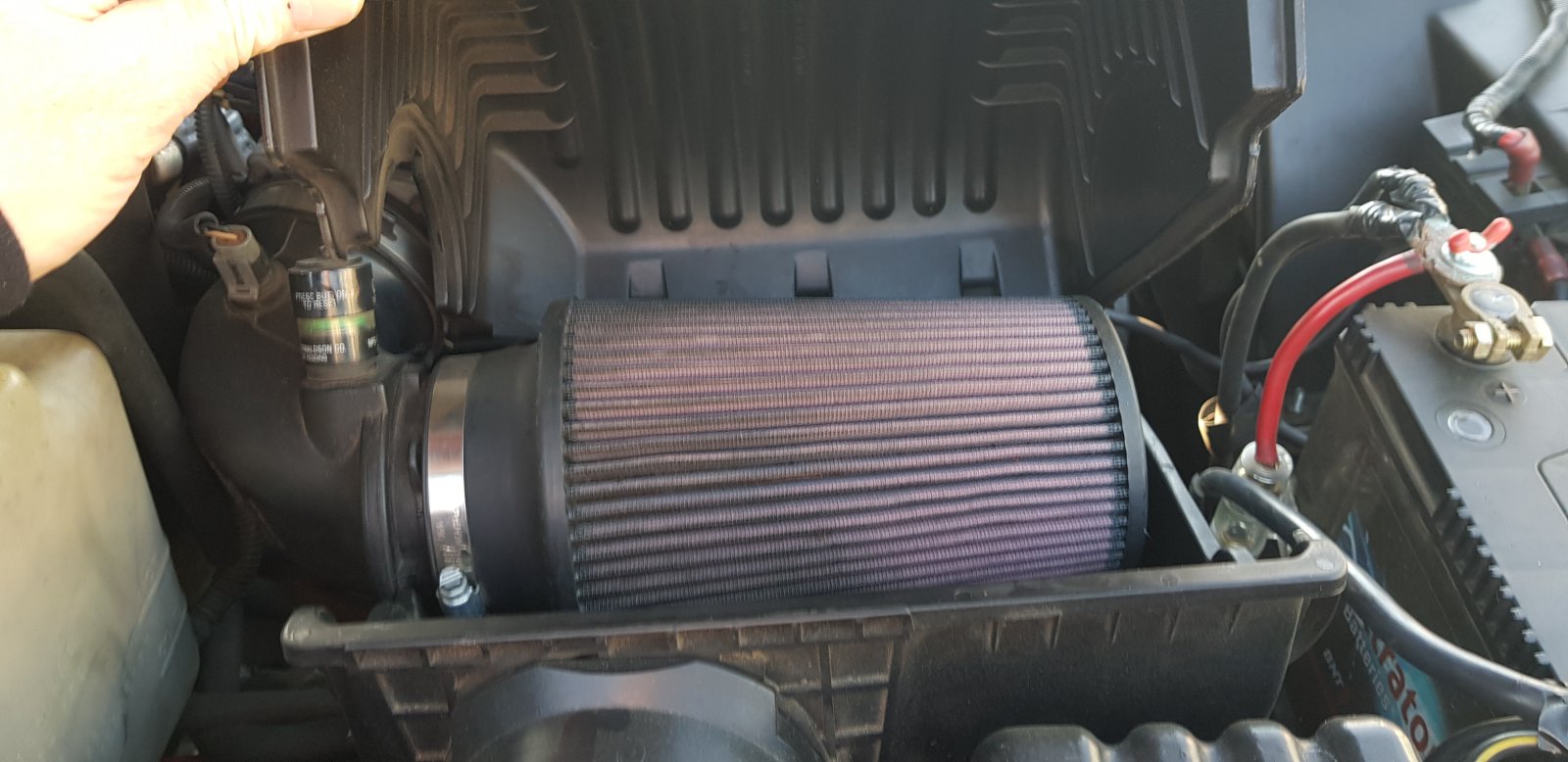

Hey :D
I am still running a stock airbox in mine but when i changed my airfilter out i replaced it with a K&N serviceable cone filter. Has been really good.
This is how it is set up. Just had a look,needs a clean.
Thanks for the reminder. Air is important. Will be great if thats fixs your issue.
Cheers

Hey :D
I am still running a stock airbox in mine but when i changed my airfilter out i replaced it with a K&N serviceable cone filter. Has been really good.View attachment 377894This is how it is set up. Just had a look,needs a clean.
Cheers
