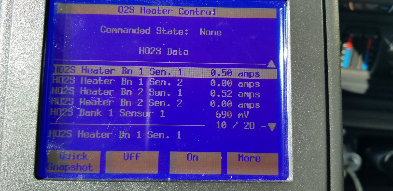

Might want to see if that O2 sensor works and, if it does, monitor it for a little while. It would be good if the a$$ didn't weld it to the bung. SMH
I already called Advance, and I'm gonna exchange it out. Only problem is I gotta get it out, try to take the slag off--and it's supposed to snow tomorrow--again, and the bottom of the truck is covered in trans fluid, along with the entire back of the truck!

I got this while idling. There's only upstream O2's.
So it is reading--according to this.

Is the recent new bung on the driver's side (Bank 1), or the passenger side (Bank 2)?
The screenshot shows that the heaters on both are drawing current and Bank 1 is at 690mv, but what about Bank 2's actual sensor?
