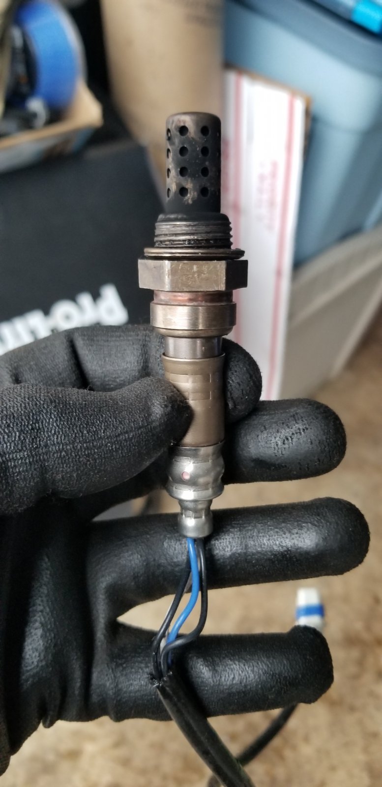

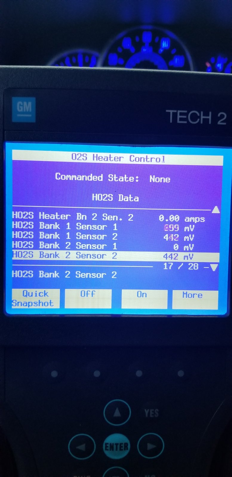

Is the recent new bung on the driver's side (Bank 1), or the passenger side (Bank 2)?

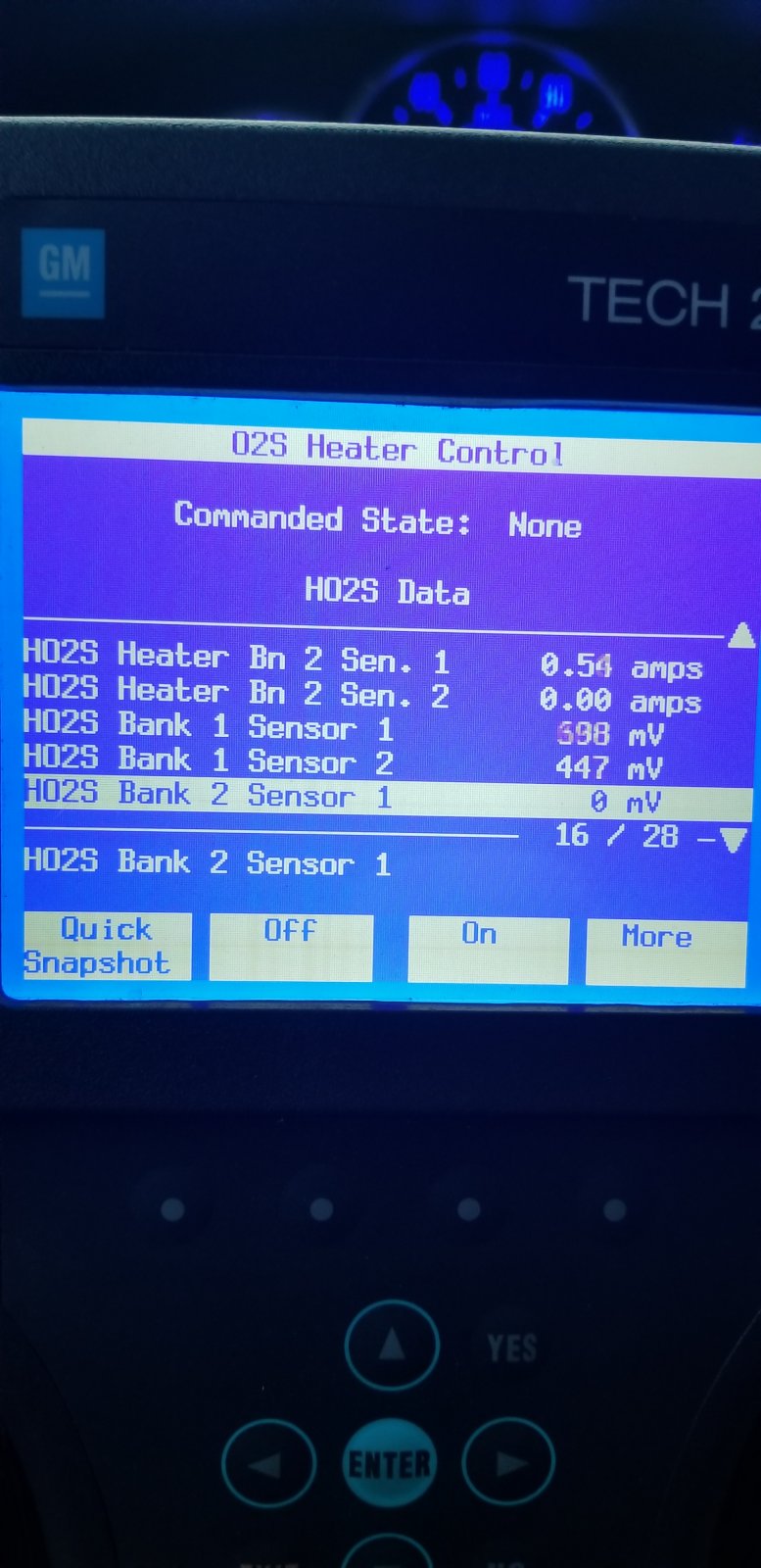

The screenshot shows that the heaters on both are drawing current and Bank 1 is at 690mv, but what about Bank 2's actual sensor?
New one is bank 2--passenger side. How does it look to you? All I see is numbers so I assumed it's working.

Your Tech 2 screen shows the heater values for both, but not the actual sensor for the Bank 2 O2. Need to do that again and get to the next page.
Most likely it isn't working then? Since that's the only thing that's questionable in this whole scenario.

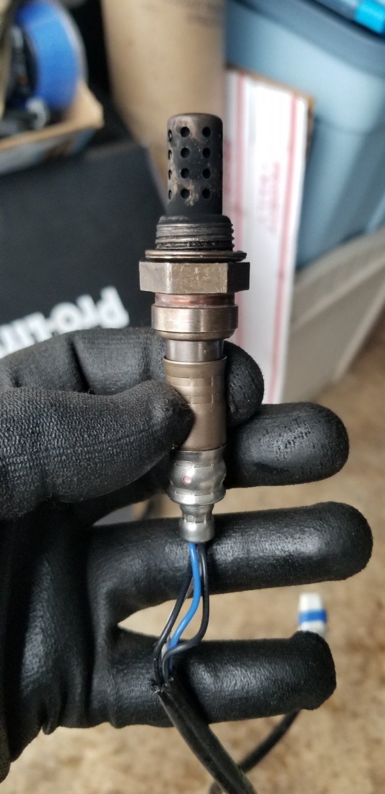

At 1st they didn't want to exchange it for me. Told me they're only allowed to exchange it once--not 3 times. I told them it wasn't my fault that it was a piece of crap that didn't work. I said where's it written?
They said I have to talk to corporate lol. That's all they can come back with. If this is messed up--I'll be back!
