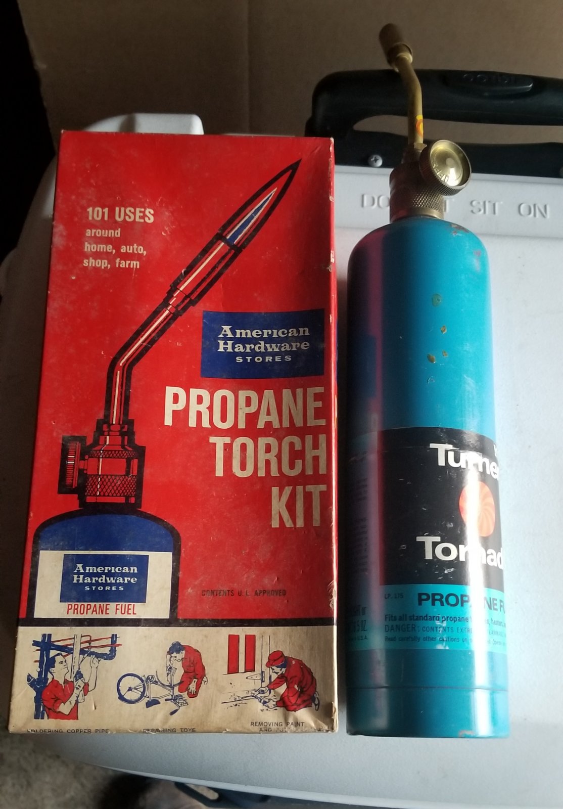

Lol, sort of. I tore my garage apart looking for a grill I've had for years--finally gonna sell it--if the buyer doesn't flake out, and I sold some Ford Fusion oem seat covers. Had to dig that crap out too. I'm still contemplating my next move with the O2. I def wanna pick up some map gas, and maybe a box wrench. I think it's a 7/8 or 22 mm, but now that it's a little rounded idk now.
Funny what you find when you're not looking--
The tank is 1/2-3/4 full, but the flame only stays lit if I'm holding a lighter to the tip. As soon as I move the flame, the tip goes out, but the gas is still coming out.

yeah the cold freezes the gas up, the valve can freeze up too.
most you have to light em with a little gas, then you can open the turn screw up little by little till you reach the bluest pointed flame you can. turning the bottle on its side can mess up the flow as well. so get it where you need it, then adjust the flame.
