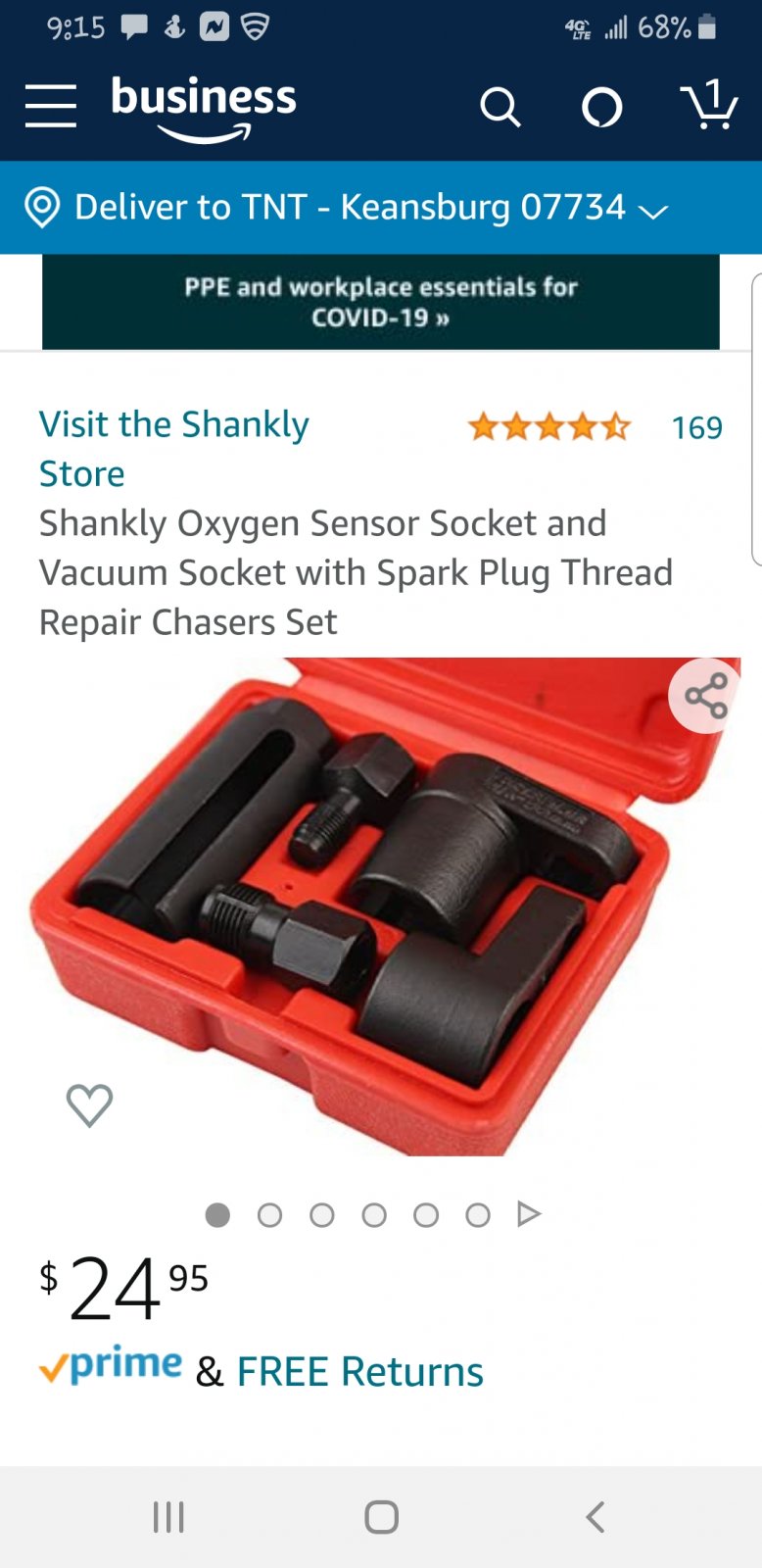

I'm thinking of getting this set--
https://www.amazon.com/dp/B076WM7DLK/ref=cm_sw_r_cp_apa_i_ZuJcGb9J1WE2X?_encoding=UTF8&psc=1
Any opinions?

Those special sockets are great for the install, but can spread on the removal. The thread fixers are nice for cleaning things up after the removal battle.
I did read that about the split sockets--the spreading. Would you be concerned about that Wade?
Yes. I've experienced that and remember the pain of slamming my knuckles when it happened. That is why I would recommend a 6-pt box end or 6-point socket, cut the harness off the sensor and put the binders to it.
Afterwards, clean up the threads with something like this.
https://www.amazon.com/gp/product/B000XETMW0/ref=ppx_yo_dt_b_search_asin_title?ie=UTF8&psc=1
The sensor is toast, so commit to removing it and cut the harness and put the best tool for removal on it. If need be, drill out the center of the sensor and then put the binders to it.

I started to round it out, that's why I stopped. I was using a big adjustable too.

@wjburken is right. commit to it, cut the harness so you can get a good wrench or socket on it and apply some real heat if you can.
I usually don't even bother to try without heat. I make that bung cherry red before I even try. Once it moves I quench it with PB blaster and work it back and forth until it works loose.
You are to the point that you need to soak that SOB in Kroil or PB Blaster overnight and then just commit to getting it out. Keep spraying either one while you are working on it.
You know that an adjustable wrench has it's place, but putting ugga dugga's into something is not it's place. I would strongly suggest you drill out the center of the sensor and see if that releases some of the binding. Then you put a 6 point deep well on it and with either an impact or a 24" breaker bar, alternate between tightening and loosening motions, work that damn thing out of there. You have to be more stubborn that then sensor and I am willing to bet you can be pretty damn stubborn.
I know you are afraid of damaging your collector pipe, don't be. Your choices are a stuck sensor, a potentially damaged bung that is fixable at an exhaust shop and a sensor that is out and then some threads to clean up and then put a new sensor in.

I second the kroil best shit ever! You got this, a new bung is less than a $20 fix even if you really mess it up.

I don't have any Kroil but I do have some PB Blaster.
Next $12 you have to spend on something dumb get a can it's like magic. But Blaster is great as well, tap with a hammer all around it after you apply the blaster. The side impact and vibrations work wonder on ball joints and I'm sure it will help in this situation. If you dont have the right size wrench go to harbour freight and buy it cheap. I have a bunch of odd sized wrenches that dont match any sets because I did the same thing and have mostly retired my adjustable wrenchs to hammer duty.

I have an Oxy acetylene torch but before I had that I used one of these lil guys. worked well when I needed it, this would help you.
https://www.fleetfarm.com/store/detail/bernzomatic-welding-cutting-brazing-kit/0000000342883/5000
Definitely. You need a small torch at least! I probably have 4 or 5 nozzles around the garage and shed and a few bottles. Super convenient for many things. I think I paid around $20 for a kit with the nozzle and tank at Home Depot. Harder to get MAPP now unfortunately..
