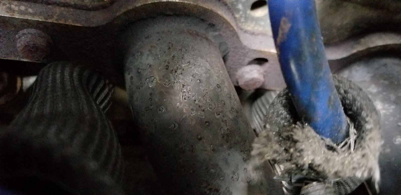

Here's a vid of the noise.
Here's what the header bolts look like also.
Opinions on the vid?

Could be an exhaust leak, like I said they sound almost identical. Use something as a stethoscope like I said. If it’s in the valve train it will be super noticeable from one side to the other. Compare by listening to both sides and compare. If the ds isn’t making way more noise that the ps then it’s an exhaust leak. Any of those bolts could be broken and you don’t know it until you try to loosen or tighten them. When you did the other side, did you break any when changing the gasket? Those look like they’re not in good shape. You should use ARP or stainless ones when you re-do the gasket.

I should've done both sides at the same time--even if it was just the bolts. I didn't notice how bad those header bolts were until today. When I did the ps, the bolts were still in good shape, so none broke. I did replace those with grade 8's iirc. Those bolts are still in good shape.
