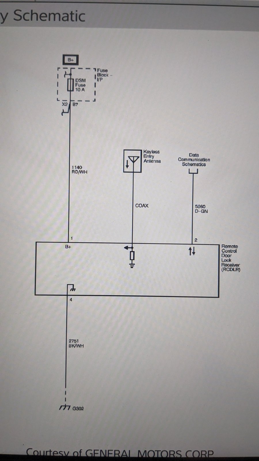

that fuse should be in the box at the left end of the dash. could check that.

I looked at the dsm fuse and it looked good but I changed it anyway. Still have the same problem. Is there a receiving module or controller that gets the signal from the tires and fob that might be bad that I could replace without to much hassle.
j91z28d1
Feb 28, 2022
4,680
5,942
it's the module in that pic.. you might search RCDLR and see what you find. I would guess it would be have to be flashed when replaced.
I don't know much about it. I don't even know where it's at. if you find it, you might check the connections and for power at it.

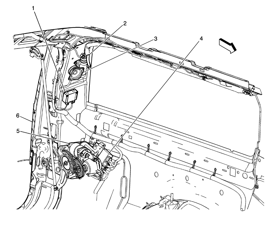

So is it accessed from under the vehicle or is it accessed from taking off some of the interior molding. Also is there a way to try and reset this module? Can I do what I have seen on YouTube where I disconnect the battery and short the neg and pos cables together for 10 min. Would that do any good or does that mess stuff up.
The RCDLR module is under the D-pillar speaker on the driver's side and a new one must be programmed to the vehicle.
To get at it, you pull down the upper trim panel in the rear door and then pop the little cover off the D-pillar to get at the 7mm screw and then gently pry it out. Of course there are some wires attached to it for the speaker.
It's number 1 in the picture.
