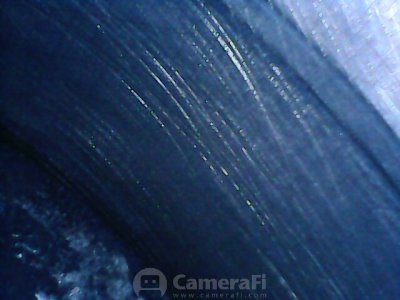

I bought one of these a little while ago: https://www.amazon.com/gp/product/B07ZH9P8QH/
Handy little bugger!
I have used it for many things,
inspecting cylinders of a new to me riding mower (v twin).
Sticking into a wall in my house while trying to figure out why the F i couldn't get a new external faucet to thread into the pipe.
Found out the installer decided to do a shit job soldering directly into the pipe for an unknown reason, resulting in me having to cut a bit square on the inside half of the wall so i could solder a threaded end onto the pipe...
I would have been lost with out that tool!
:yuno:
And most recently, replacing the pressure sensor and screen, was unable to get the screen out.
Used the scope to see if i even had one in there.
Saw the image showing me a Yup!
Handy!

I used the one I bought on Amazon for about $16 or $18 and was able to watch my sensor leak under pressure. Just clean it off good beforehand. I also used it to check out the cylinders on on of my motorcycles. They take great pics!
