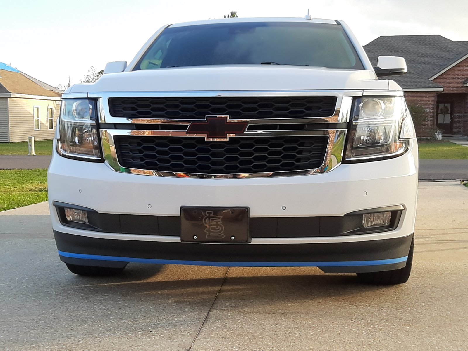

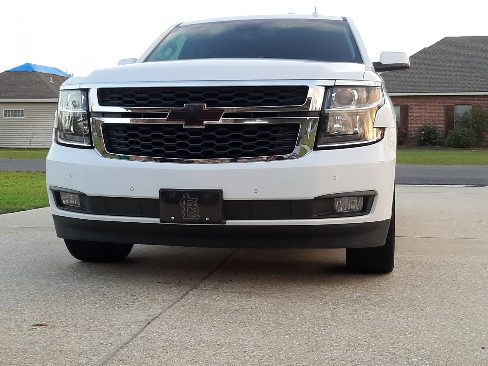

Here is a reference line right at the top of the lower wing 1.5" / here it is trimmed, literally 20 minutes total time
After four years of dealing with the front dragging on curbs, and my ramps, I followed your cutting line images today and removed the lower wings on my ‘16 Tahoe.
Used a cutting wheel (OK, two cutting wheels) on my dremel. Cleaned up with a utility knife ( removed melted sticky residue), then cleaned up edge with a sanding wheel.
Thanks for the images.
