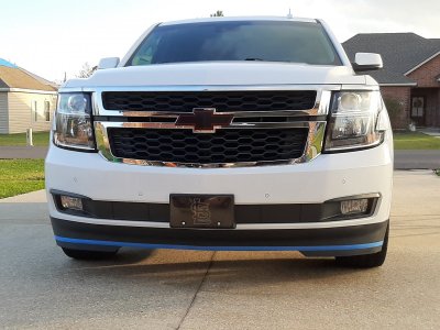

I just installed this on my lowered Suburban. Here is a comparison of the ground clearance from both deflectors.
Stock height and stock air deflector:
7 13/16in. Of clearance at the sides of the deflector. And 9 5/16in. of clearance at the center of the deflector.
Lowered height (2/3 drop) with PPV deflector. 11 11/16in. Of clearance at the sides. And 11 1/2 in. In the middle. It slopes slightly inward towards the middle.
Amazing how much clearance I GAINED with this even though I’m lowered. Win win !!!

We just finished putting on GM Part # 23365760
It is the Lower Deflector that comes on Tahoe PPV. it is about 1/4 of the length of the stock piece.
It's a small mod but I believe it has changed the look on our suburban quite a lot, we like it.
I got it at, for 281 plus shipping
https://www.gmpartso...lector-23365760
The main reason was to gain ground clearance, for these off-road times, like when parking at a mall to clear curbs
Also already helps on steep driveways and coming out of parking lots...
The removal of the old piece and installation of the new one was quite simple. Remove some bolts/ torque screws, pushing down some clip, partial removal of front wheels liners.
I can't comment on any decrease in MPG on highway, as we use this truck in town.

nope. remove the stock one, put on the other one.
Be Careful to use a clip/retainer removing tool, along with amazon cheap trim removing tools, bunch of tongues of various thickness.
I choose to take mine to a body shop and it took them an hour to take care of it.

Haha was just reading through some of these. It's really simple to cut the lower air dam while it's on the vehicle. Just roll it up on some ramps and use a dremel. I had put some blue painters tape above where i planned to cut in advance and just free-handed it and it came out great. Don't fear f'ing it up - it'll turn out fine. Just be sure you measure how low you want on each side first and let the dremel walk itself through. no stress. good luck. A guy could also make a very light cut with an xacto or box cutter and gradually cut deeper and easily bend/break it off too. Sand the rough edge with your dremel or by hand after and it'll come out great - have confidence in yourself
Oct 2, 2020
84
79
Absolutely agree with that ^ I did it on my Escalade a week or two ago and I was definitely afraid I was gonna eff it up (even though I pride myself as being fairly handy). Came out great. Just measure before you cut and take your time
