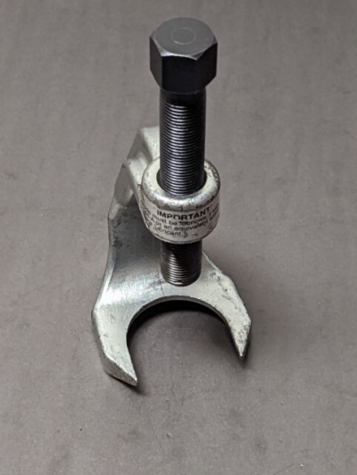

I know you already ordered a tool but a run of the meal puller should have worked fine
even a harbor freight one. I have had a adjustable one in my tool box for a few decades
something like this, if you need it shorter or longer a quick trip to the hardware store for a bolt with the same thread is all it takes
can be a puller or pusher

If I was in your shoes, I’d use a pickle fork and a BFH. They have never let me down, even with PA rust. If you ruin the boot, rent a C clamp press and press a new ball joint in.

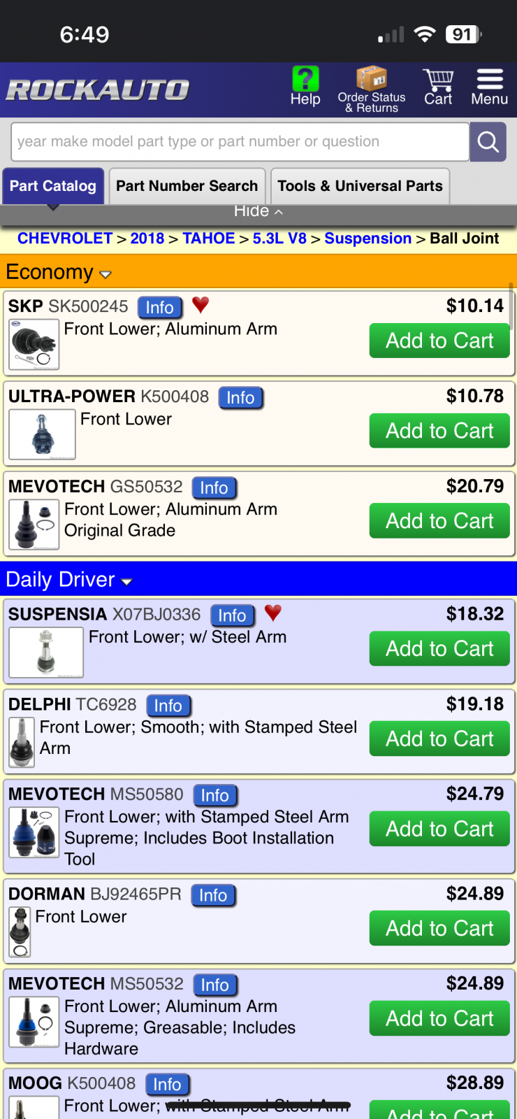

IIRC, the BJs are non-replaceable. They look welded into the LCAs to me, and while I haven't specifically looked, I haven't seen a separate listing for just the BJs. But if that's an option, I'll cut the ones on the current LCA and replace with the spindle.

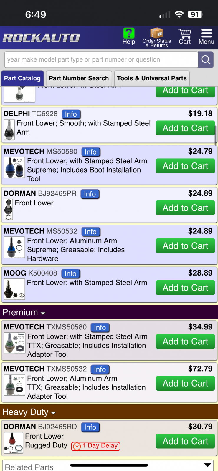

I think its the other way around. bottoms are serviceable and the tops are not. however, rock auto list upper and lowers available for sale.

Weird. As I said, they both look welded on to me.
