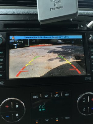

Wanting to put a rear facing cam on my 2011 Yukon Denali, would anyone happen to know which wire in the lift gate harness is switched? There is a tight bundle of 30ish some wires going in and didn't want to poke holes in 29 of them if I didn't have too.

This guy uses the wiper motor switched power wire.
5 factory 12v in rear wiper motor, thick pink w white stripe, cut it and splice it back together but first one of the cut sides with the new camera power red wire

Nice! Thank you I'll go digging for that one. I could snake a wire up from the dash but seemed a pain if 12v switched could be found nearby.
