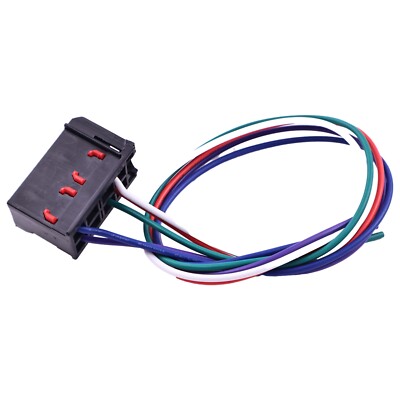

My dash cam pulls power from the connector that goes to the rearview mirror. Pins 1 and 8, black and red/white (if memory serves) and has power all the time. This way sentry mode works when the car and camera is off.
