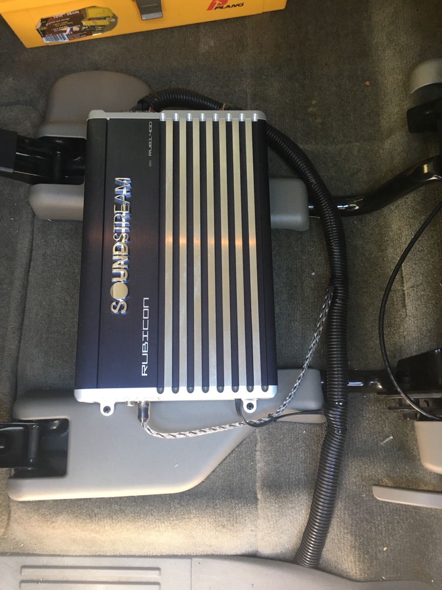

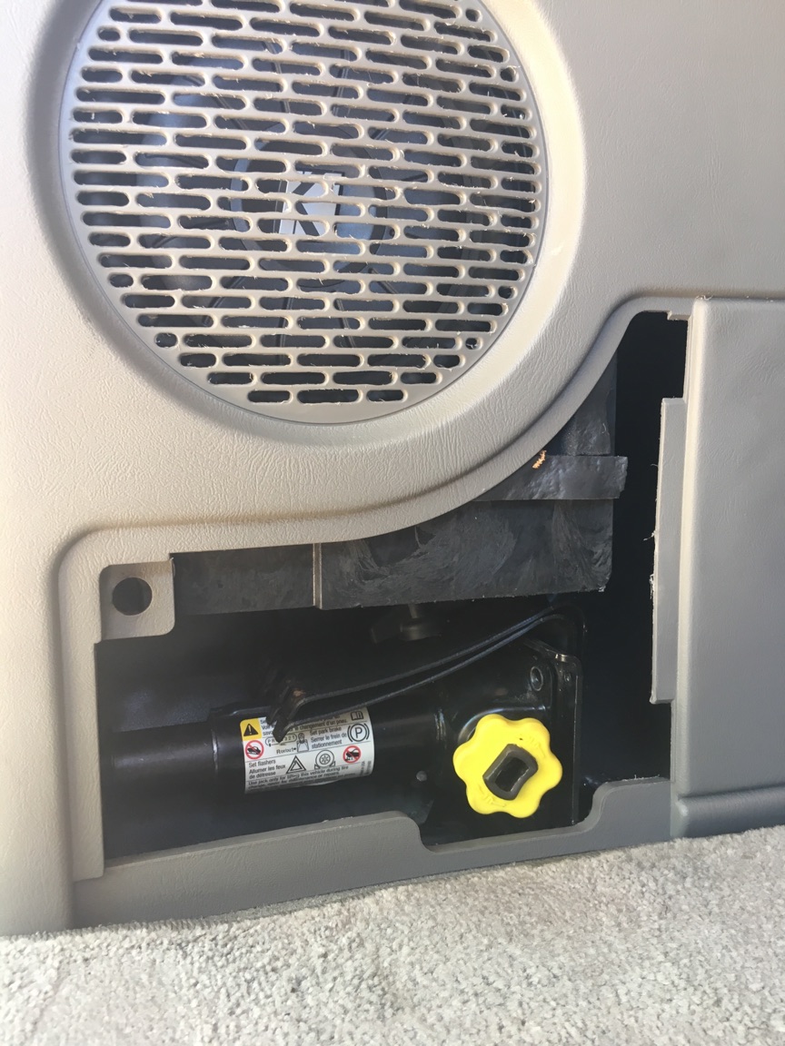

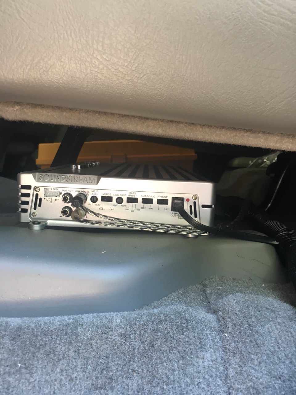

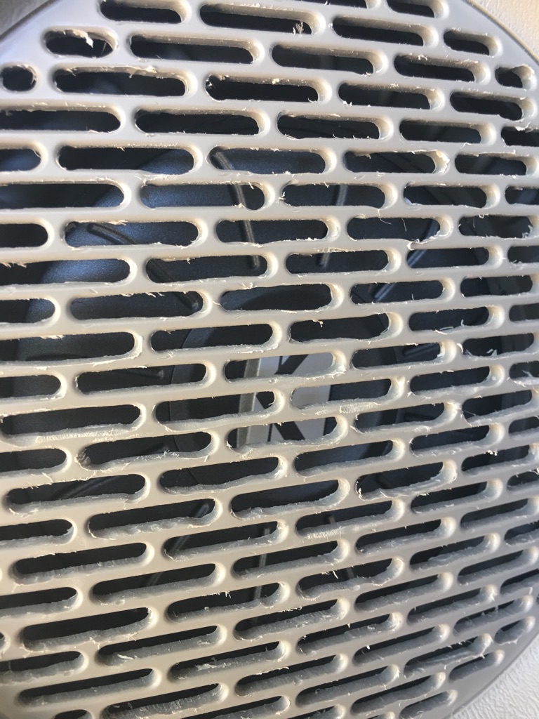

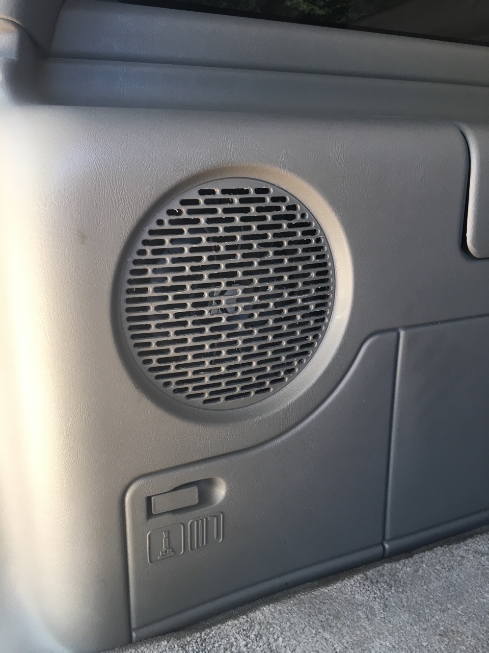

I put a factory box out of an 02 tahoe into my 04 tahoe with bose, already had the center console sub but i wanted a little more bump in the back. Used a kicker shallow mount 8 inch sub, and dremmeled out all of the indentations in the fake speaker grill back there. Since the 04 jack is mounted in there I had to drill 1 hole in the back of the sub box to accomodate a mounting stud and go the dealer to get the factory mounting nuts and bolts for the 02 sub box on top, they pop right into place on the 04 sheet metal. As you can see the jack still fits in there fine and i can get the mounting bracket on the jack still but it's tight. A little sticky weatherstrip foam from oreillys and it doesnt vibrate against the panel at all. Put the amp under the second row.

Awesome! Are you using stock Bose speakers? How did you mount the amp under the second row? How does the kicker sub sound (does it hit good on the lows)?

@bluebear15 Yes I am using stock bose everywhere else. Amp is mounted just using some black #8 screws into the plastic that covers the seat rails. The amp lined up nicely with the plastic I think I got 3 of the corners mounted securely. If I really wanted to get crazy I could have made a rack or stuck it in the quarter panel somewhere but I like it where it is. I think the kicker sounds decent, if I turn the gain up it definitely hits more than the stock amp but I'm not super into car audio so it could probably be adjusted better if I knew what I was doing lol. I used a line output converter tied into the wiring between the head unit and the stock amp, I heard it gets a better signal that way if you still use the stock head unit, rather than using the wiring between the stock amp and the stock sub.
