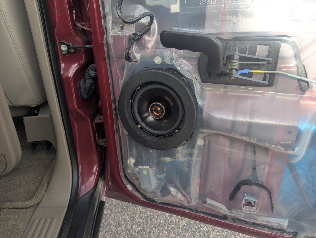

Hi all,
A lot of info out there and I figured I would post what I did on my XL. This setup allowed me to keep the factory Bose amp.
First, I am an old guy and have been a die-hard rock and metal guy since my older brothers were unwrapping their new Sabbath and VH1 albums! I have been installing systems for a long time in every car I have had and I have never grown out of it.
The factory Bose system in this was in perfect shape! But, I needed to modernize and get phone connectivity. Plus, the sound quality factory system just did not cut it! 20 years ago, maybe…
I was on a mission to spend less than $1k on everything. This is a fishing rig after all! All of the main components below came out to $930ish. I had pretty much everything else (wire/cables, sound deadener, box materials, etc.) on hand.
The setup – all part information for the system is detailed below.

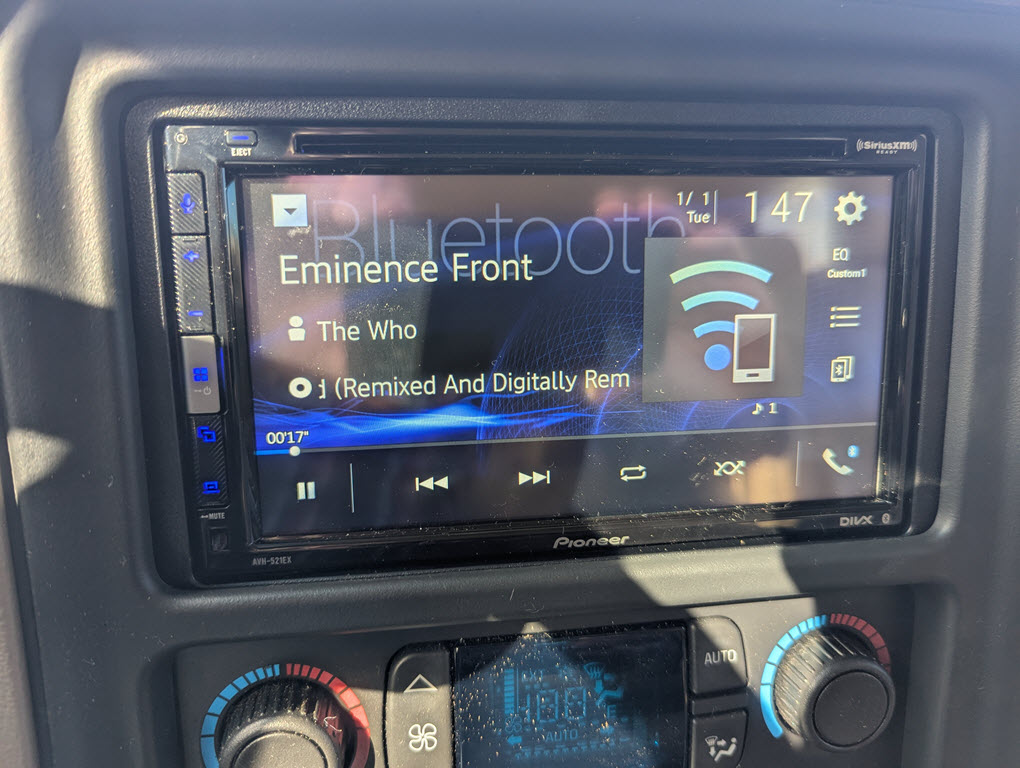

I kept the factory Bose amp and sub in the center console. All factory speaker wires were used. I installed a Pioneer DVD head unit and all connectivity was done through a CRUX interface. Everything worked perfectly!

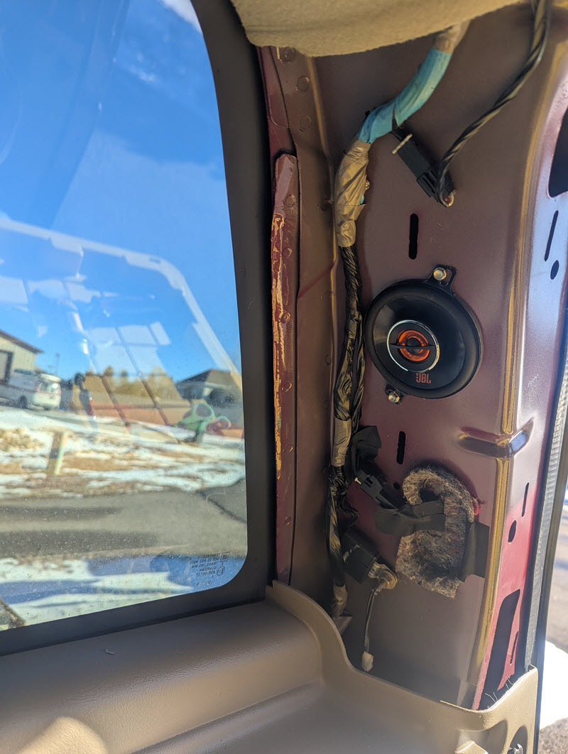

New speakers vs. the Bose amp ohm issue – The Bose amp has a 2 ohm output. Major issue with most aftermarket speakers being 4 ohms. The NVX front components are 2 ohm, Infinity rear door speakers are 3 ohm and the JBL rear quarter speakers are 2.3 ohm. Sound deadener added to all 4 inner door skins.

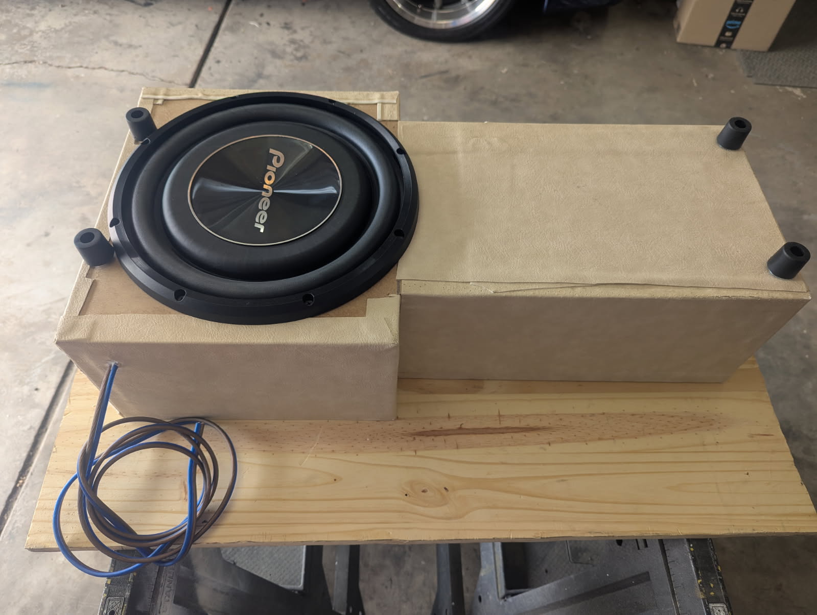

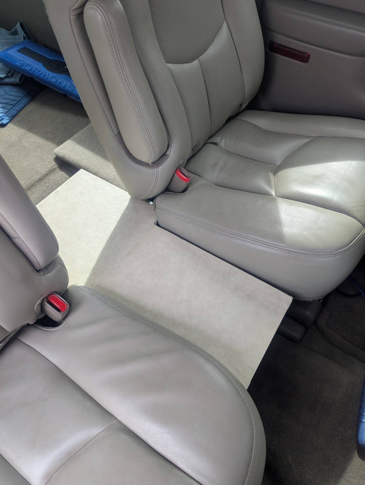

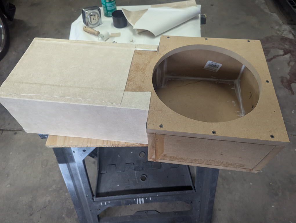

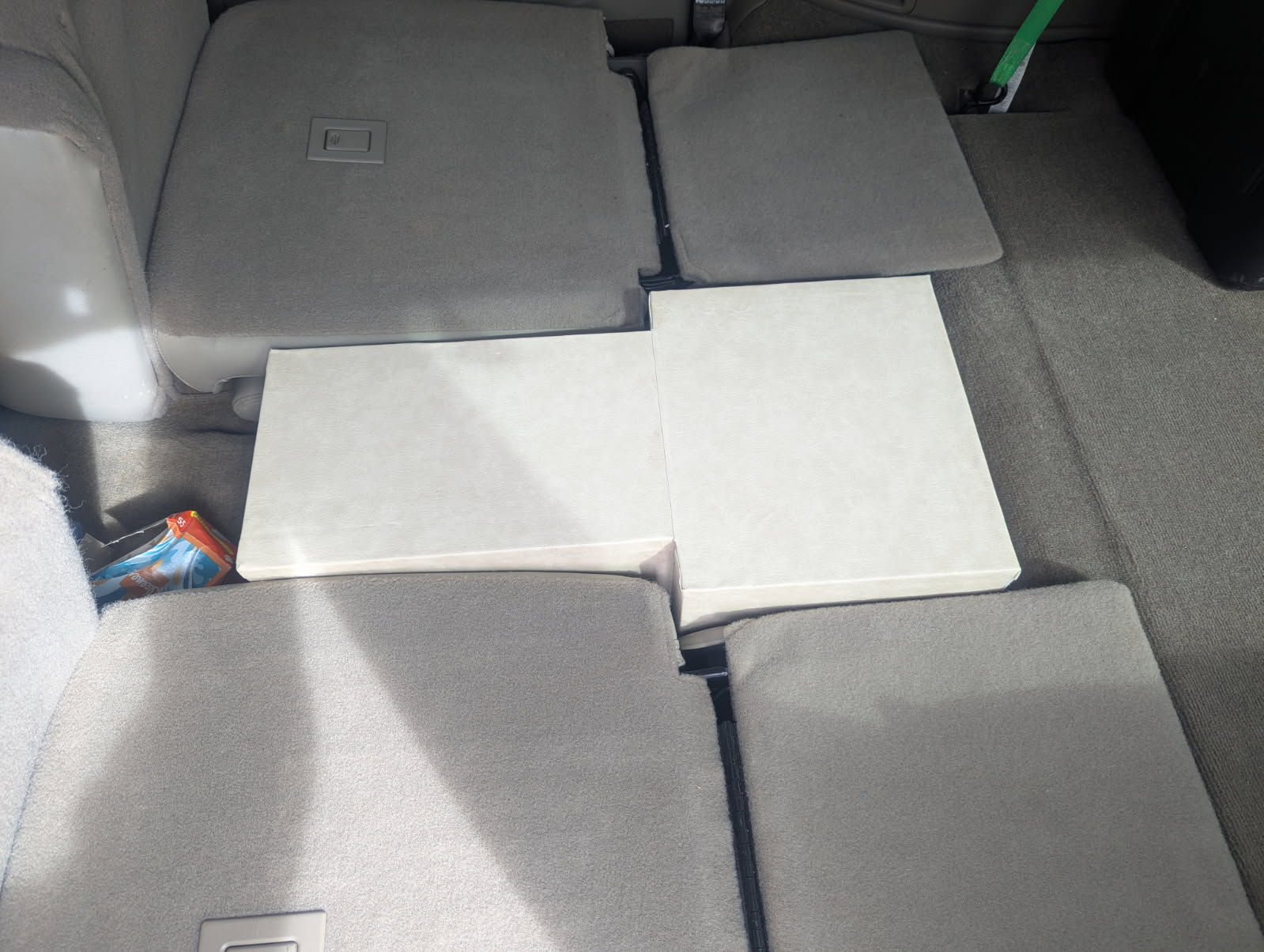

I built the sub box to fill the hole between the rear seats and make the area flat from front to back when the seats are down. and started with a 10” sub. Then, realized I could go to a shallow 12” Pioneer. The box volume is perfect and it has worked great. I will re-cover it at some point to match.
While this is not going to win any sort of a SPL contest, the sound quality blew me away! Even with the mis-matched brands! Great lows out of the sub(s). Super clean mids and highs. The rear quarter speakers really add some high end definition.
The sub was very tight when I first installed it. It broke in VERY well and is very musical. Hits great lows and is very punchy. Far better than I expected it to be! Due to the location, the “feel” of the sub(s) is great! The remote volume control helps a lot.

Head Unit: Pioneer AVH21EX DVD Head Unit ($300)
Front Speakers: NVX VS65KIT2F 6.5 Component set. Recoil BB-T Bass Blockers installed on tweeter. Tweeters in A-pillar OE location. ($120 + $8)
Rear Door Speakers: Infinity REF-5032cfx ($70)
Rear Quarter Speakers: JBL GX328 – 3.5” with Recoil BB-35 Bass Blockers ($ 65 + $9)
Subwoofer: Pioneer TS-A3000LS4 12” Shallow Sub – 1500w max ($115)
Subwoofer Amp: NVX VAD10004 Monoblock Class D w/remote – 1000w ($145)
Interface: Crux CX-GMC2 Steering Wheel Interface ($100)
Sorry - No front speaker pics. I thought I had them, but...

Agreed! The majority of the improvement is from the Pioneer head unit. Everything is controlled through the head unit (EQ, Crossover, Sub Output). You would not get this level of improvement using the OE head unit. I am shocked at the clarity of the OE Bose amp. The Focals will definitely push harder, but from a sound quality standpoint, it is hard to complain at all. I am actually hearing some additional details that I have not really heard in the past. As crazy as it is, I am linking that to the rear quarter speakers as well. They have a great "fill" effect.
Having the sub right behind the front seats is great. I picked my granddaughter from school the other day and I always torture her with Metallica or something line that. I hit her with some Pantera and she yelled "my butt is shaking"! Perfect! :rotflmao:

Last, the subwoofer between the 2nd row seats definitely makes a big difference. I love the massage that the subwoofer vibrations give me as I drive. Please disregard the white hair all over the place in my photo, as my Swiss White German Shepherds love to sit/lay on the subwoofer and look over my shoulder out the front windshield when we go for a ride. Subsequent to this photo, I've added a flat carpet covered deck extending beyond the rear of the subwoofer, but still attached to the subwoofer itself, to allow my dogs to fully lie down and literally drive beside me.

He has front speakers that are 2 Ohm. The rear, door speakers are 3 Ohm, so those are going to not push as much volume. The rear quarter speakers are 2.3 Ohms. They will be less loud than stock, but unlikely to be noticed. It looks like he added an additional amp to drive his subwoofer.
This is correct. The ohm levels of the speakers that I installed pretty much align with the channels on the factory Bose amp and will not over-drive it. Not a lot of options out there, but very happy with this setup.
I installed a small 500 watt NVX mono sub amp. Cheap, but drives the Pioneer sub very well. This is controlled through the Pioneer head unit and runs independently at 4 ohms.
