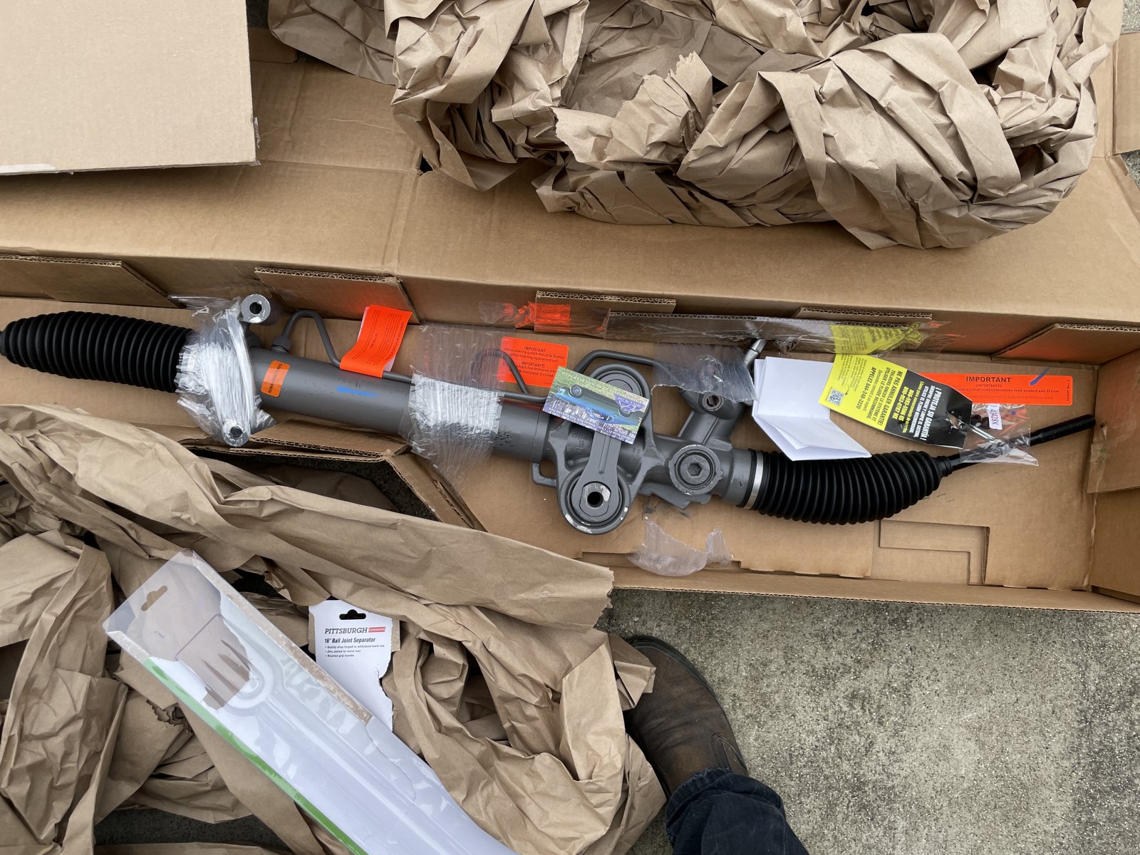

Got the new rack installed, filled it up and turned the wheels back and fourth a few times and refilled it until it stopped going down. Then I started it and turned the wheels and the power steering was groaning and the reservoir was empty so I filled it again and now everything seems good but there’s a lot of foam from the initial start. Will that go away or do I need to drain and feed I’ll the system again?
B-train
Sep 12, 2022
2,710
4,920
Lift up the front and cycle it back and forth by hand, lock to lock a number of times without the engine running. Once or twice won't cut it, do many cycles. Slow and steady back and forth.
The foam will go away after it sits for awhile.....just like a beer
Dustin Jackson
Dustin Jackson
Aug 9, 2018
1,788
2,065

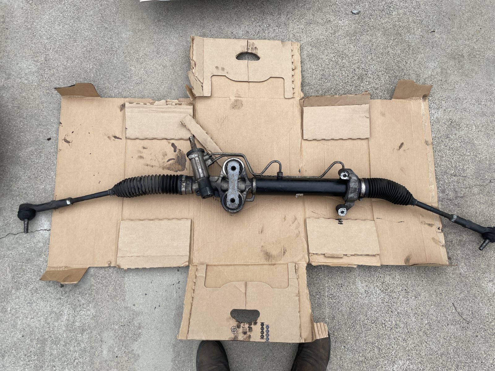

Took it on a shake down test drive and man does it feel good. Steering is nice and tight, no rattles or knocking when driving over bumps and dips.
Getting the old rack out was very hard with the tie rods on (diff drop puts the diff right in the way) but I wanted them to stay on for measurement, could probably remove them next time. Tie rod ends were on about 18 turns both sides. I ended up getting the rack down and then pushed it out the driver side a bit to get the passenger tie rod under the control arm and then slide the rack out towards the passenger side on my chest. Installing the new one in reverse order was pretty easy, only weighs like 30 pounds so if I can do it anyone should be able to do it. Just be sure to keep the long mount bolts near by so that you can pin it up when you are lifting it. I had to steer the rack a tiny bit to get it to mount up to the steering shaft. I understand you don’t want to turn the steering wheel to line it up. (?)
My old steering joint was in bad shape and was binding in rotation so I ended up putting in the new Dorman joint.
While the joint was out I pulled the steering shaft out of the firewall all it could and greased the part of the shaft that goes into the firewall boot with some blue synthetic brake caliper grease. This is supposed to help eliminate a lot of chatter in the steering shaft and column.

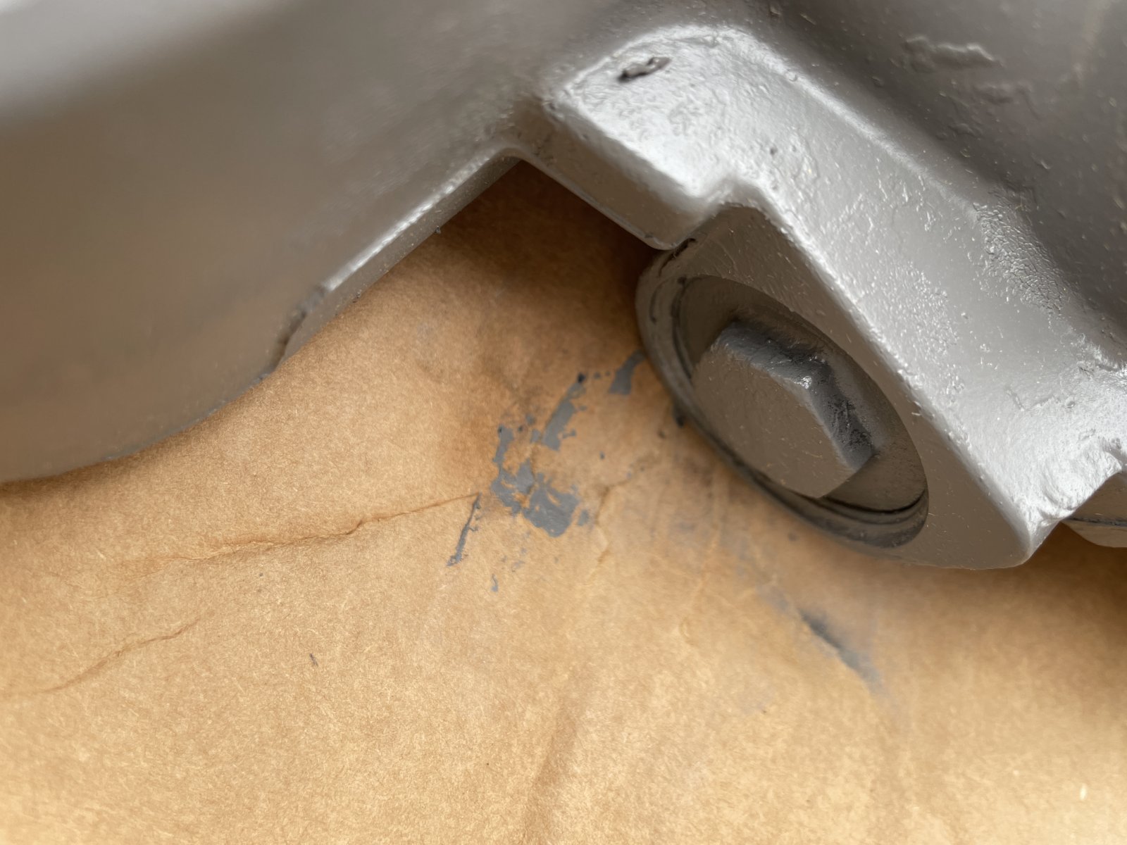

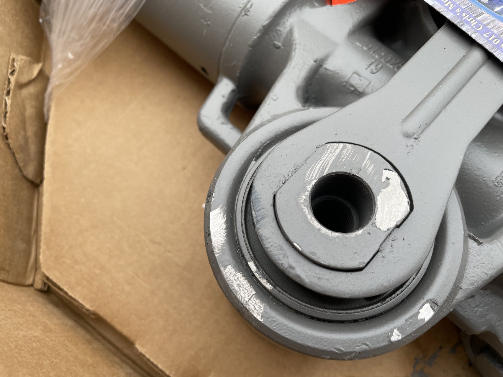

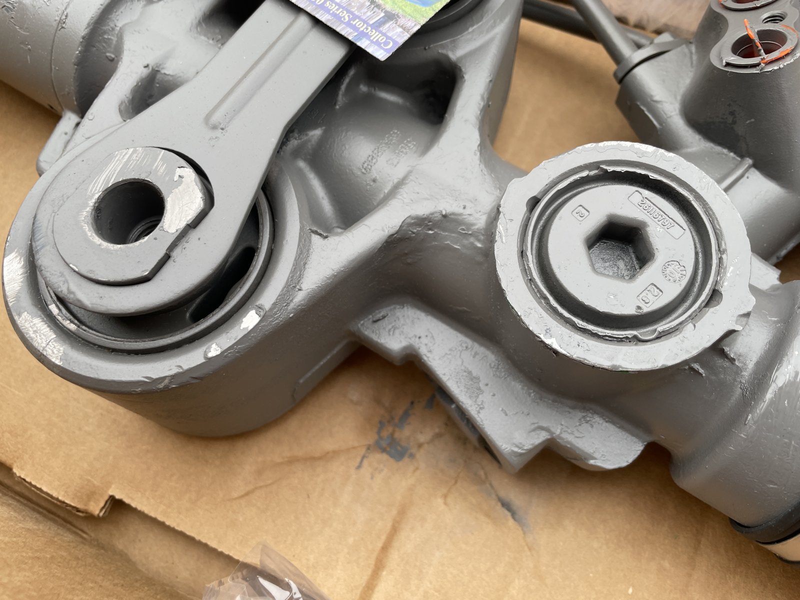

The reman steering rack looked suspicious on the outside but seems to be operating just fine.
Can’t wait to get an alignment and tire rotation.
