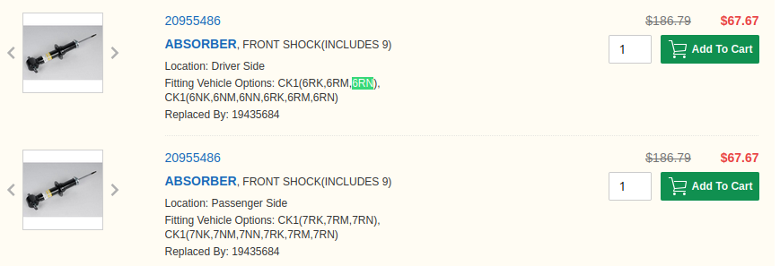

Looking on www.gmpartsgiant.com, the shocks look like they'd be available as P/N 19435684, but it would be best to check with @915_Tahoe first. If you use that site, enter with your VIN for the best accuracy. I do not recommend ordering from that site, due to the experiences that other members have had.
