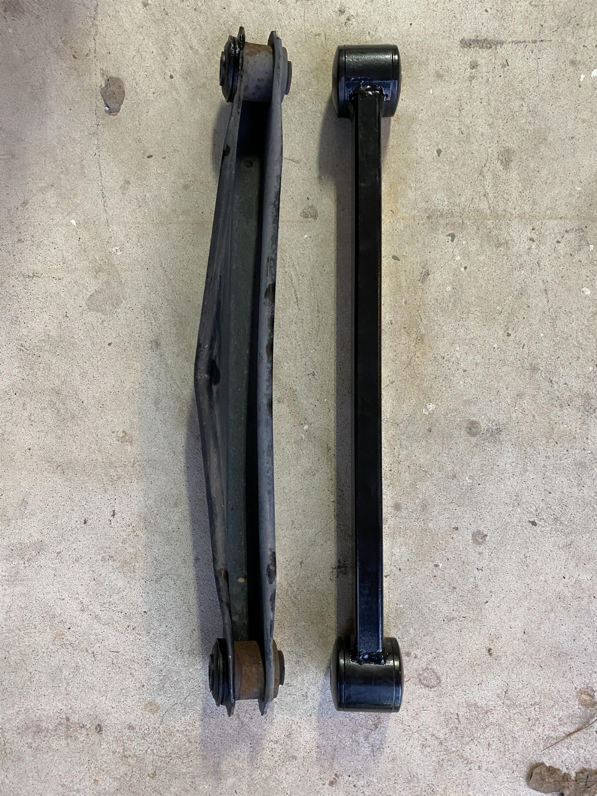

I couldn't find any other options either. Ended up with Spohns boxed lowers because I didn't want the spherical joints or adjustability. Haven't found any good uppers either but I am working on a set of custom adjustable uppers.
45,014
I plan to extend and box some new stock lowers and make my own adjustable uppers. The noise and harshness of spherical joints just isn't necessary unless you're at the track trying to hook 1,000 HP at the wheels.

I have the Spohn boxed LCA, great fit and finish.
BUT they can be noisy when going in and out of driveways and stuff. Where they're boxed, it eliminates some of the articulation that you have with the OEM LCA and rubber bushings. I still need to order the uppers at some point

I installed the Spohn lower boxed control arms in my rig.. I did it to help
deflection and tighten up the rear while towing.. I also did the bigger sway bars
front and rear. Everything is greaseable. So you have to make sure to do the
maintenance. I think it helped. For a "stockish" set up, just replacing the
the stock pieces is fine.. You'll get new bushings and that's what wears out
