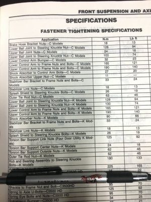

Looks like you got it, 133ft lbs according to my GM C/K truck manual I attached a pic of the page, hopefully it works.
