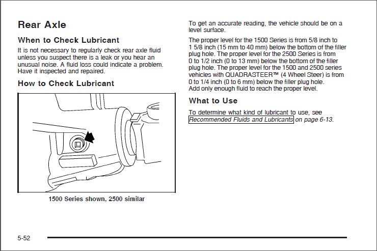

Start with your owners’ manual to get the basic information about your specific rear end. There’s limited information in the manual, but it’s still useful. These two pages are from my 04 Tahoe manual.
It shows where your filler plug is located as well as the proper fill level. My fill level is 5/8” to 1 5/8” below the bottom of the plug hole.

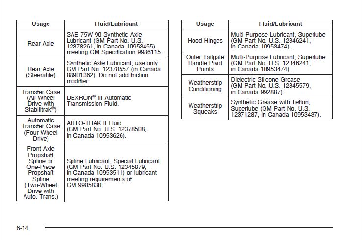

Under the title “What to Use” for the oil, my manual specifies SAE 75W90 Synthetic axle lubricant GM part # 12378261, meeting the GM spec 9986115.
You will also want to identify if you have a limited slip differential or not. If you do have a limited slip, you need a “friction modifier” to add to the oil for proper operation.

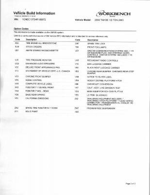

When I was at the dealer, the service manager took my VIN and ran the build sheet for my Tahoe (I suggest you get a build sheet for your vehicle). I was given the print out on my build, nowhere in the codes does it mention a limited slip differential, so it doesn’t have one – I don’t need to add friction modifier.

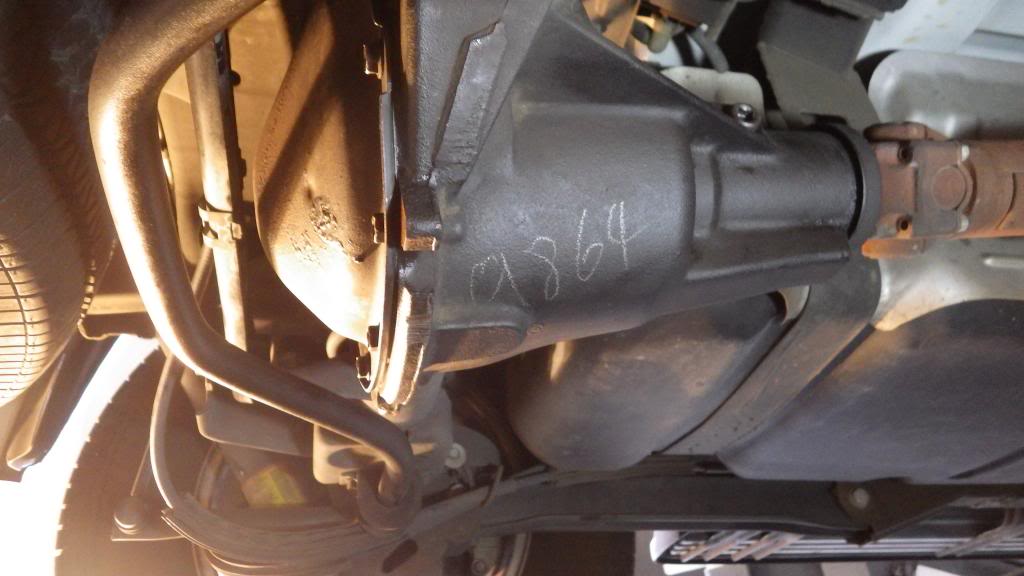

Since the results listed two different potential rear ends, with a different amount of cover bolts, I got under my Tahoe and counted cover bolts – I have 10. The 8.6” has 10 bolts and the 9.5” has 14 bolts, so mine is the 8.6” rear end.

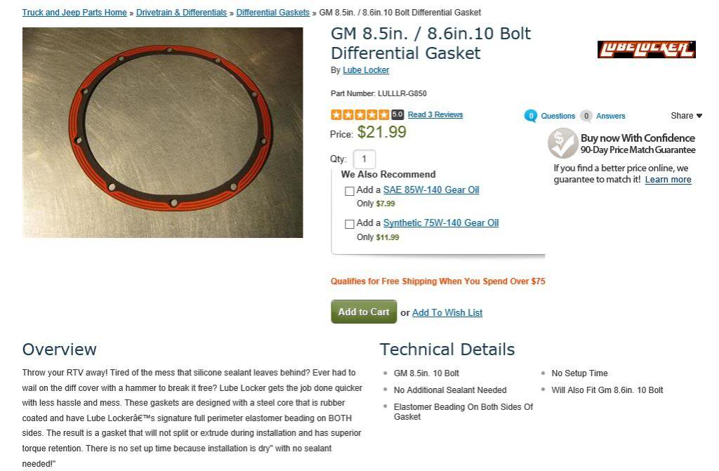

I have used differential gaskets in the past (on my old Jeep) called a “Lube Locker” gaskets and they worked GREAT! No silicone to mess with and the gasket is re-usable. I found the gasket and ordered it online. It’s a little more expensive than a single use gasket, but re-usability and no messy silicone makes it worth it to me.
