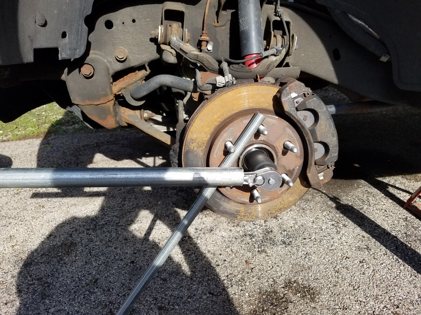

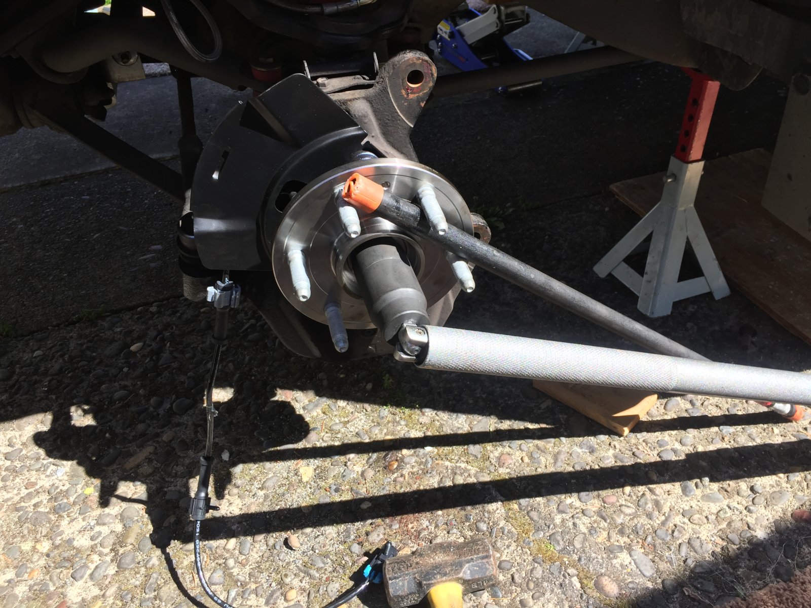

On my 02 I used a short length of pipe in between two of the wheel studs, like this:

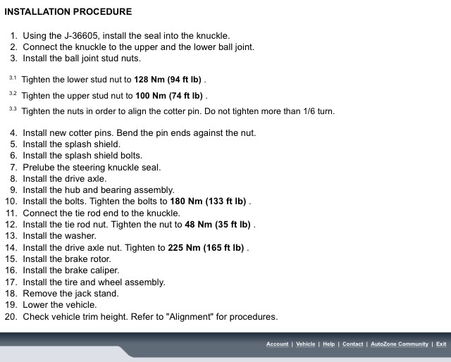

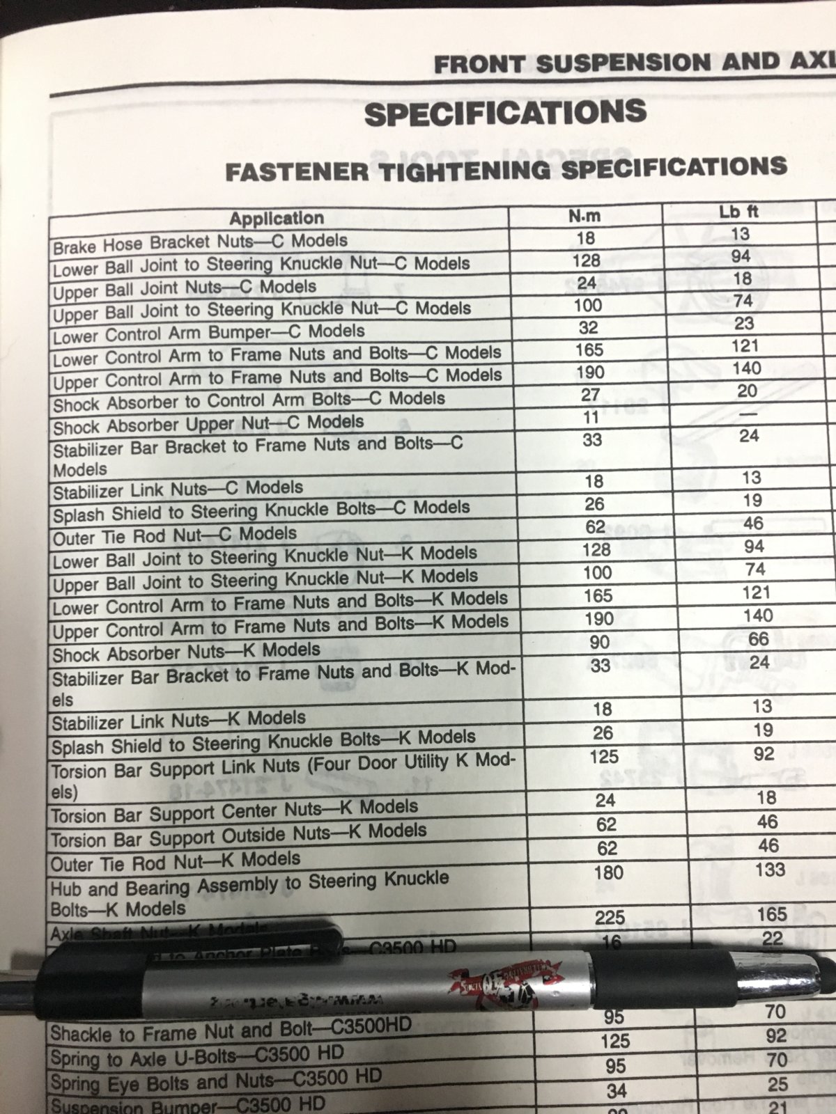

Looks like you got it, 133ft lbs according to my GM C/K truck manual I attached a pic of the page, hopefully it works.
