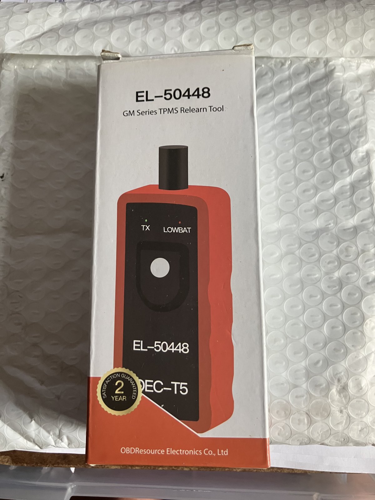

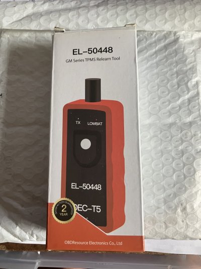

What relearn tool are you using and are you following the instructions? This relearn tool is what I use. I got it on Amazon for $13. Good luck!
That very same tool, actually! It learns the sensors fine; once I shut the truck off, it forgets them.
