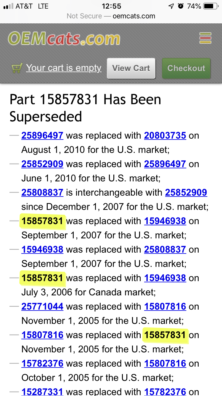

These are known supersessions for the 15857831. There are possibly others, but these are direct replacements
