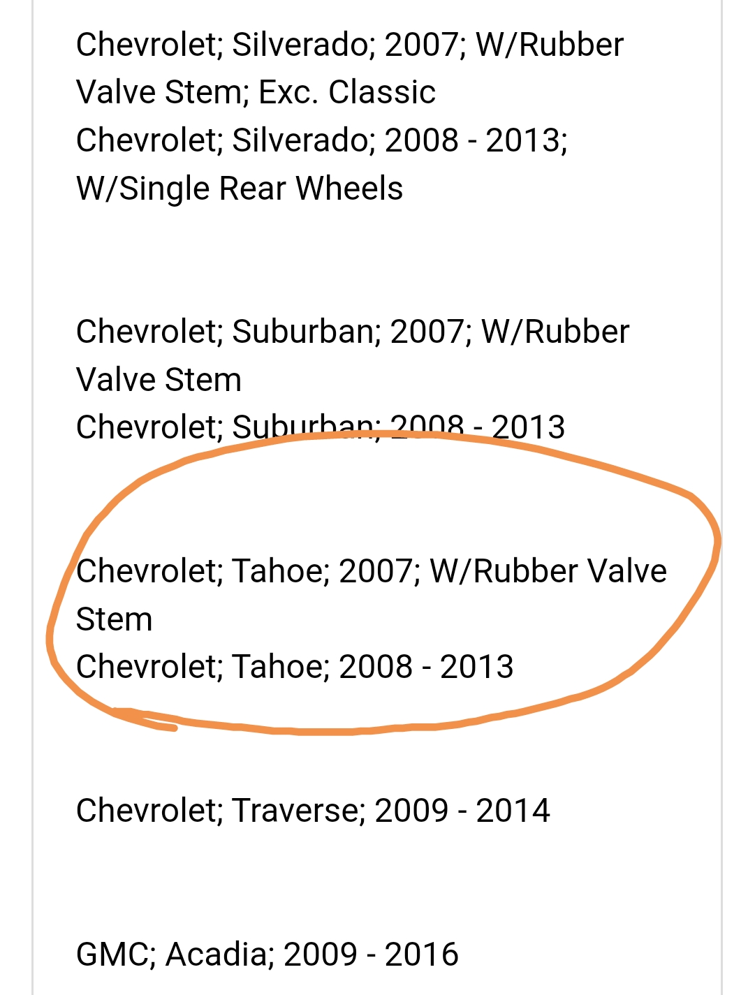

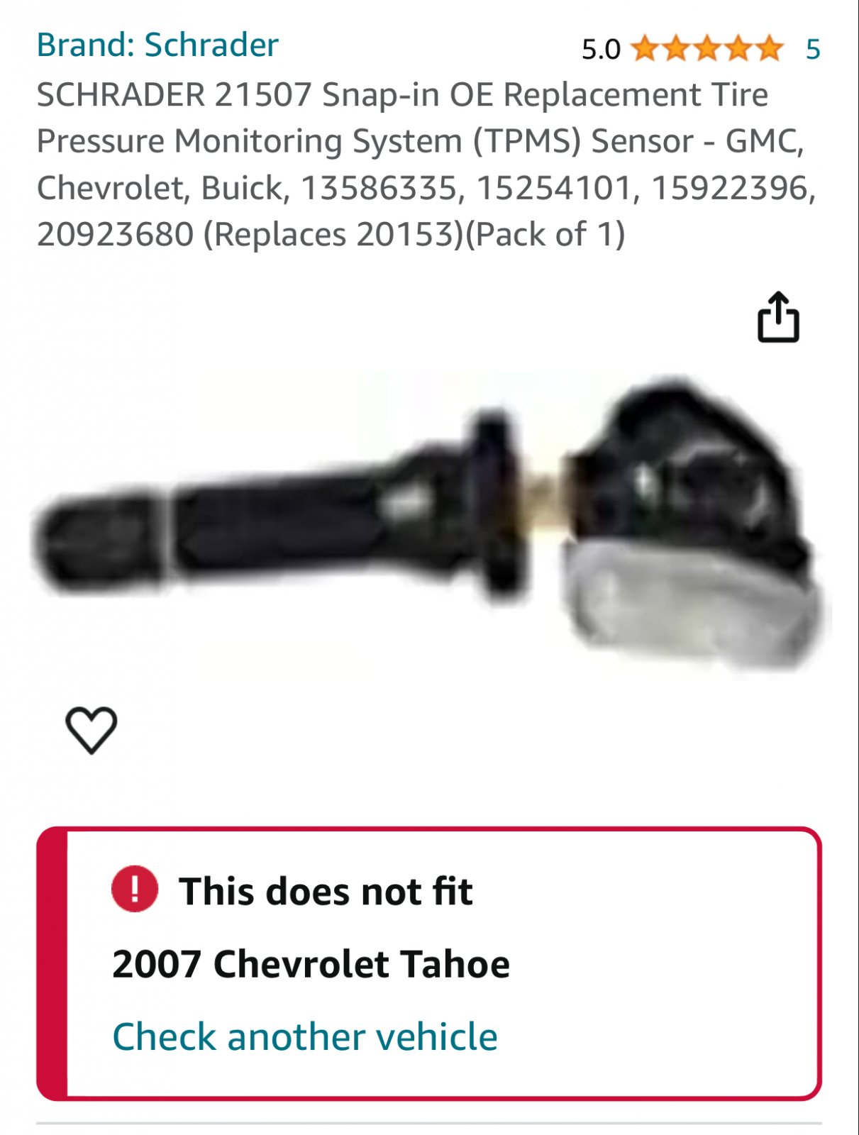

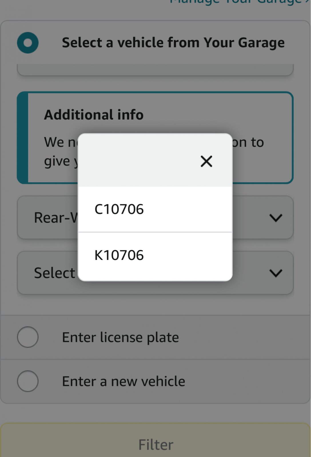

Amazon wants 2 or 4WD and a body code to verify fitment.
Unfortunately, I order from Germany and have to rely a lot on the specifications here. Amazon is not the place where I like to buy spare parts. Especially since many fakes are sold. I have now sent a message directly to Schrader asking for clarification. Because somehow you have to be able to trust as a customer, especially with RockAuto

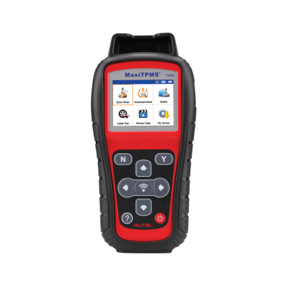

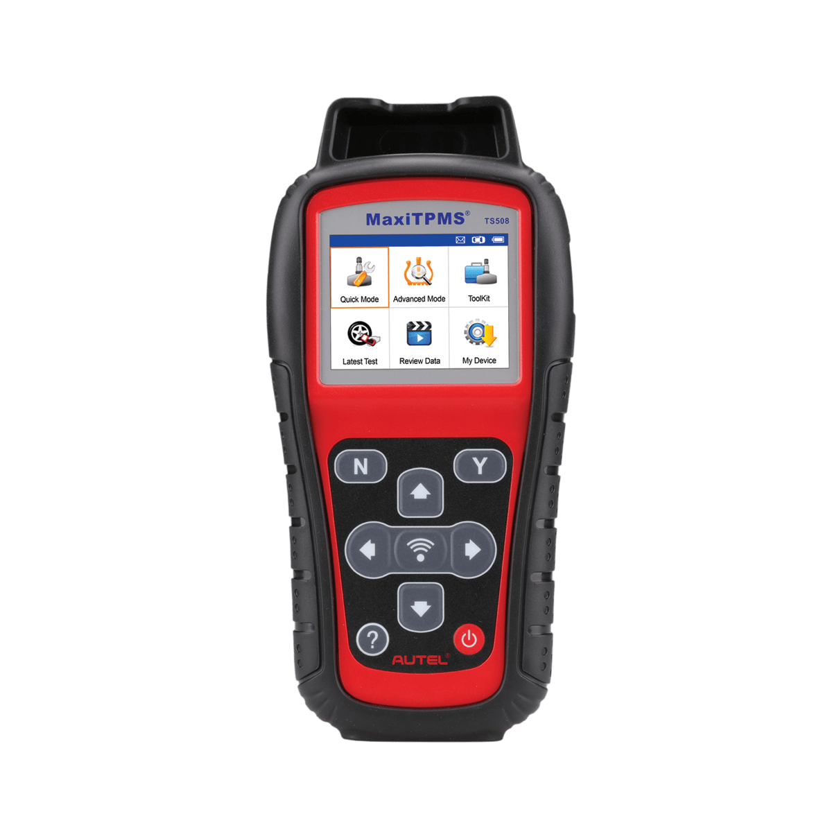

Hello dear friends here in the forum.
Today I can share with you my solution to my Schrader 21507 sensor problem.
I bought the MAXITPMS programming device TS508 from Autel. Apparently my sensors
1. weren't awaked and
2. The ID wasn't stored in the ECU.
With this device, it was super easy to read out all the sensor IDs and then store them in the ECU via the OBD2 interface with the included cable. The device was currently on offer for €150 and I snapped it up. The advantage here is that I have a lifetime license and updates. I cover the US, Europe, Asia and Australian markets. I can access all of this in the device. Furthermore, I think it's nice that I can clone all the sensors, which helps me in the winter when I install my winter tires. So I no longer have to learn everything again, but I have the same IDs as for the summer tires. The device can do much more. Therefore, the purchase was more than worth it for me and my fleet.
If anyone needs help with this, I would be happy to provide information and of course I would be happy to help you. I still wanted to thank everyone here who tried to share their knowledge with me. Everything works again and I'm reassured that I didn't buy the wrong sensors.
Many greetings to everyone and happy Easter from Germany
Markus

Like I said, Amazon isn't always reliable. Contrary to the information from Amazon, the Schrader 21507 are perfect for my vehicle. You just can't easily teach them with the China Tester. I used the ****-TPMS TS508 for this. They had to be woken up and the ID#S saved into the ECU via OBD. All sensors were recognized within seconds and stored in the ECU via the OBD2 interface. Everything now works perfectly.

Thanks for your answer. I used the same tool as you. But unfortunately, this tool didn't work. It wasn't until I bought the Autel TS508 Maxitpms that I was able to wake up all the sensors and then save them via OBD2. I think the Schrader 21507 are absolutely worth the money. Because I often bought Chinese sensors, and they were defective after less than a year. That's why I invested a little more money this time and bought something good.
