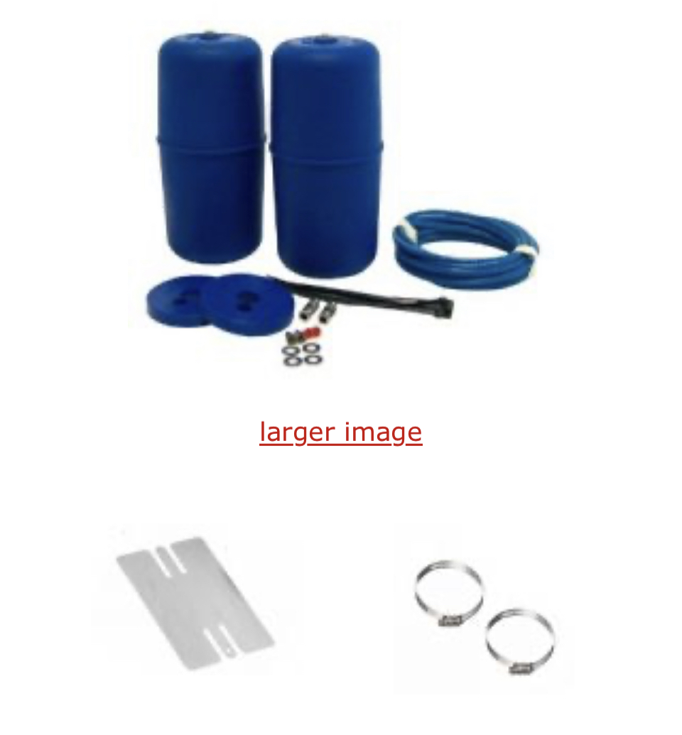

Installing new Skyjackers c25r. Wondering if anyone installed air bags with these for towing? I looked online but saw very few options. Any thoughts?

I have used these springs but not with bags. Problem with bags is most are short. There's a set for use with stock springs in our trucks but they would be too short with lift springs. You'll need to install the springs and measure there length at ride height unloaded and find a set around that length

Right on Carl. That's what I was thinking. Them bags are short and are likely made for stock springs. I'll keep checking around.
