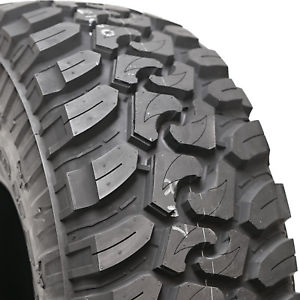

Personally,.. I think I prefer old school looks with a lot of sidewall, the new look with tall rims and no rubber is just not appealing to me,... plus true off-roaders (not that I am, but like the look) would want plenty of sidewall for protection against rocks ect. Also im not a big fan of ALL black wheels,.. some black mixed with chrome/machined looks w/bead locks are ok. But anyways,.. love to see what you guys are running. The picture below is one set that Im seriously considering.

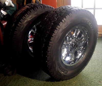

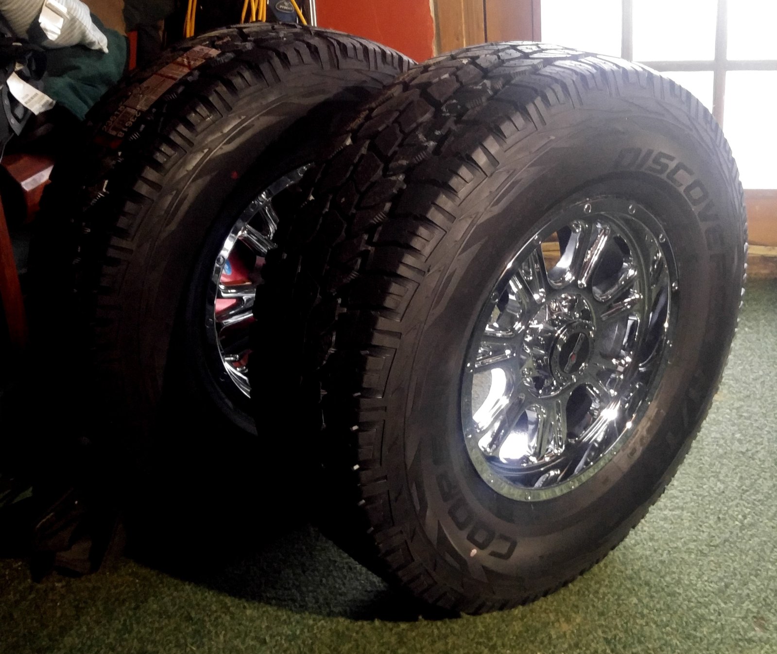

Tires/rims came today,.. I like them but Im getting prepared for some trimming,....With the 0 offset I was hoping for a bit more lip, but when you see the back of the wheel you'll see why the spokescooper 34.jpg
are so far forward, not sure why they do that.

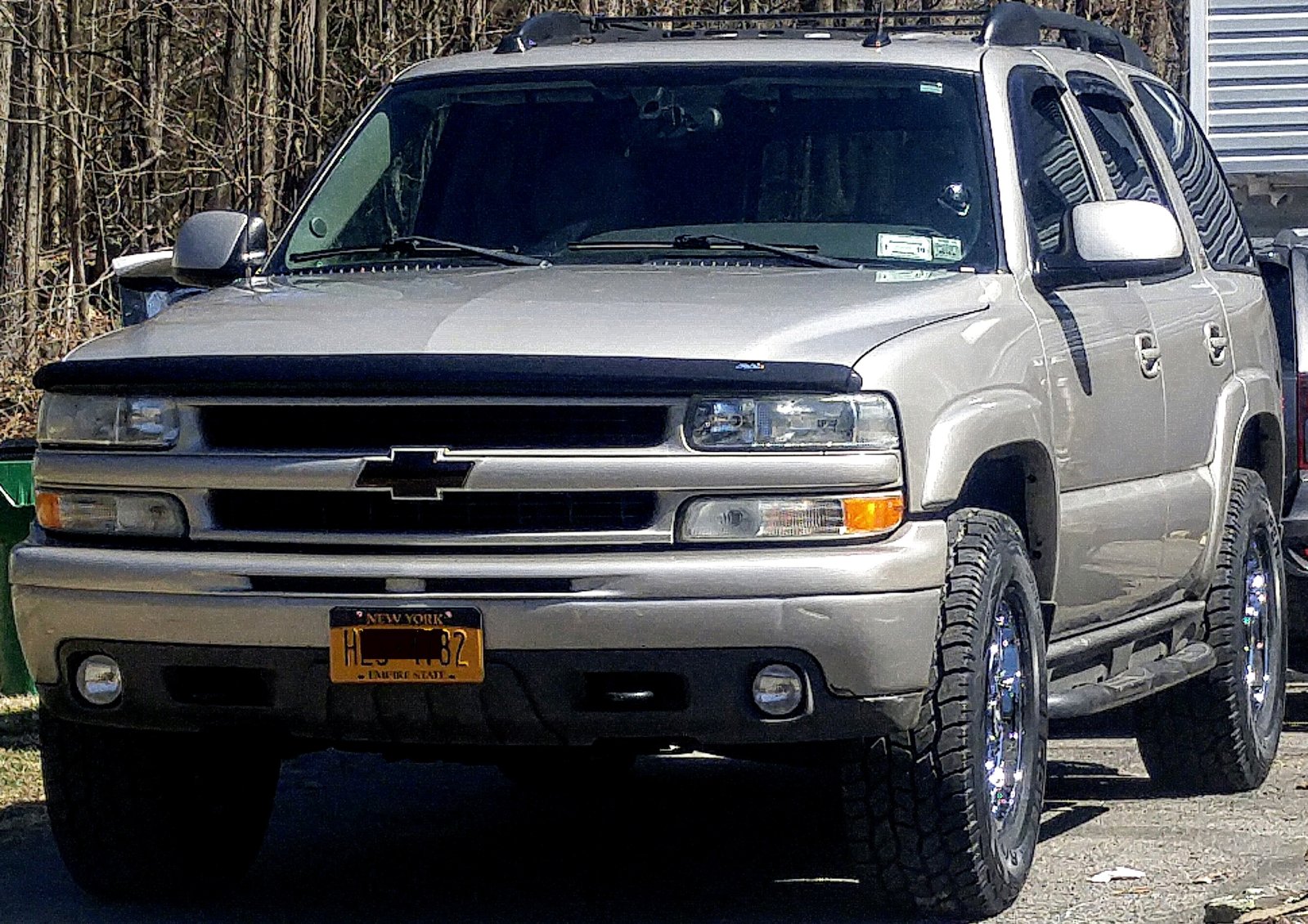

I will not have a chance to install them till Sat,..hopefully. They are just a tad over 3" taller than the 265's currently on there,.. and an 1.75" wider,...it looks like Im gonna be doing some trimming !

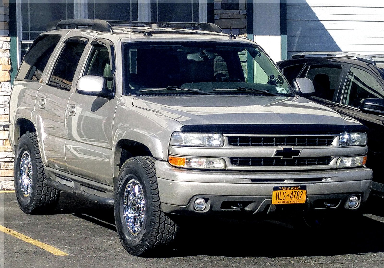

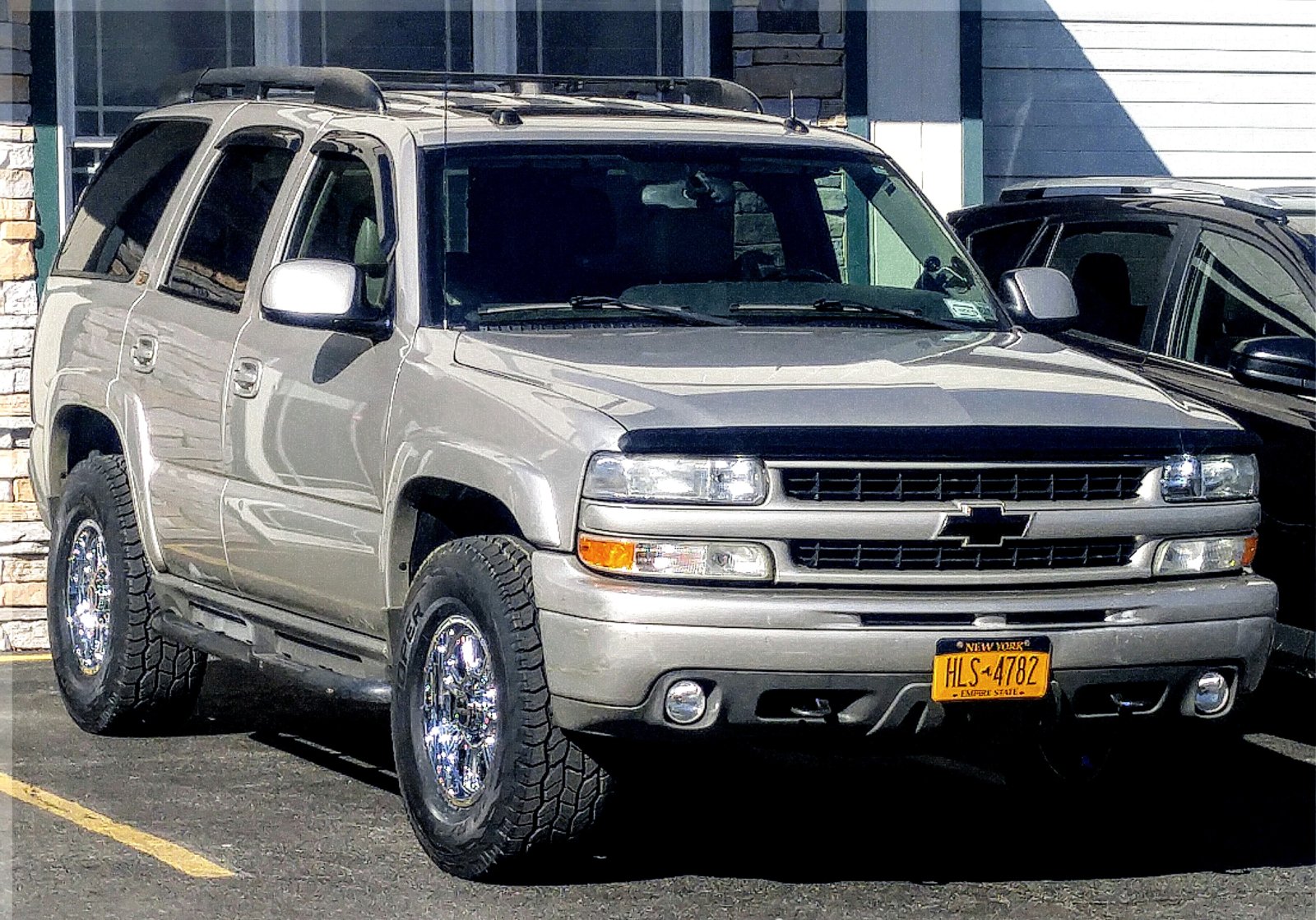

I put the 2.5" keys in last night,... and the air-lift bags for the rear arrived in the mail today... with just the keys cranked to about 1/3 she's sitting between 38"-39" in all 4 corners as we speak.... the air bags will ad another inch or two to rear springs. I should have install pictures by the weekend....
This is a pic with just 2.5" keys in front.
Shaw520
Shaw520
Feb 28, 2018
415
391

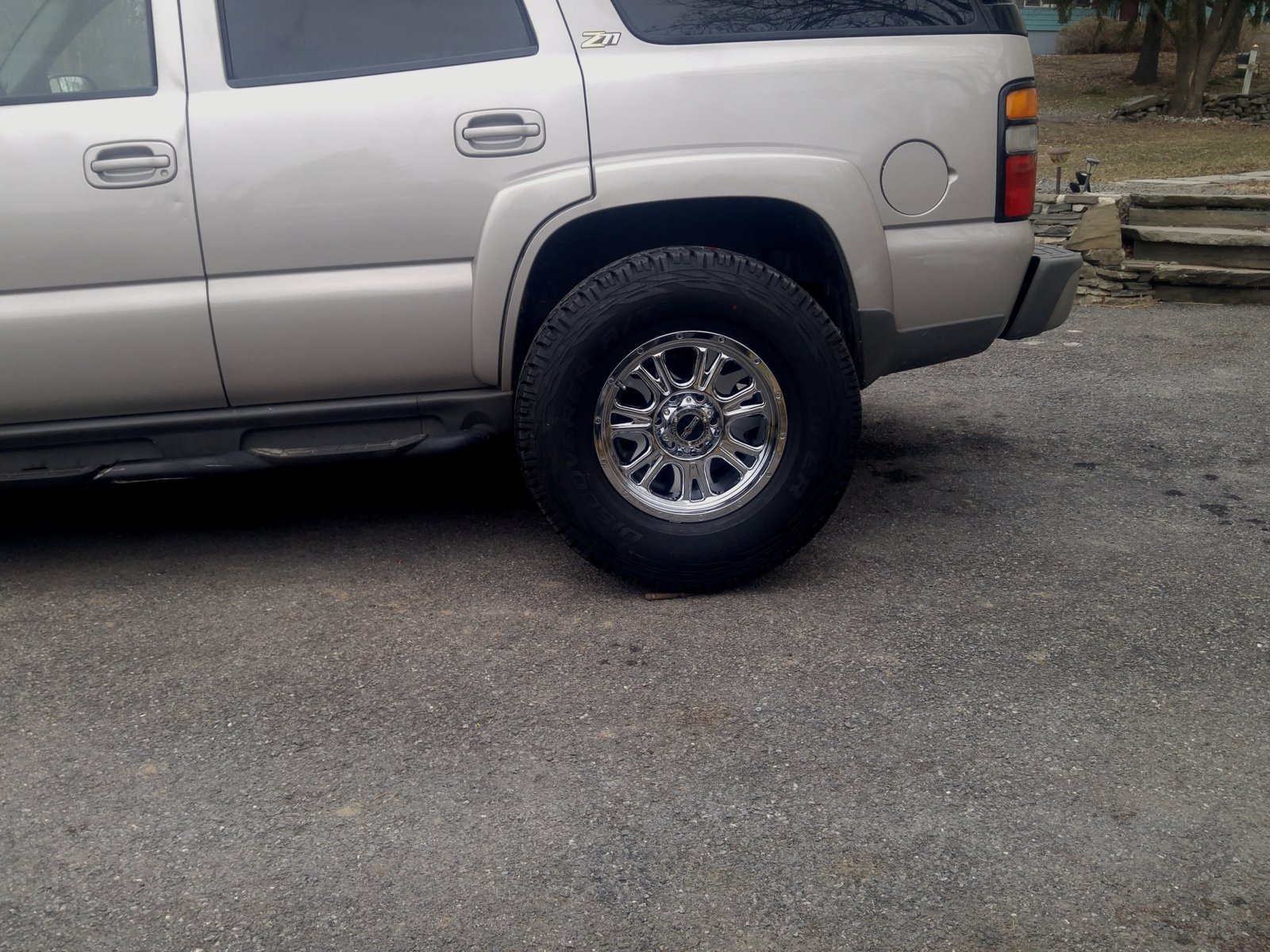

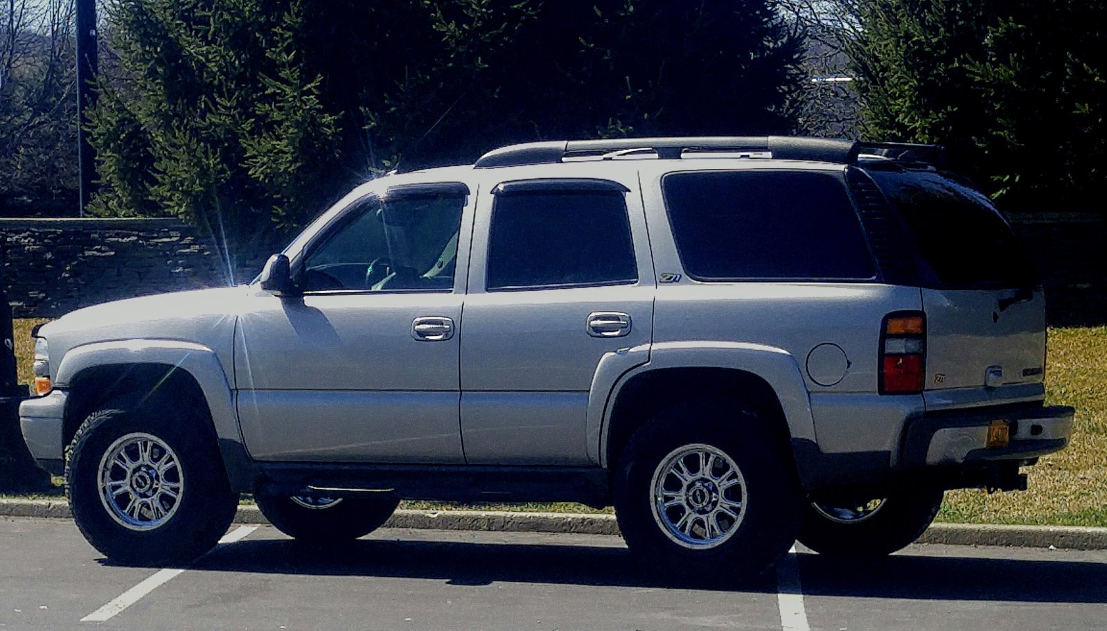

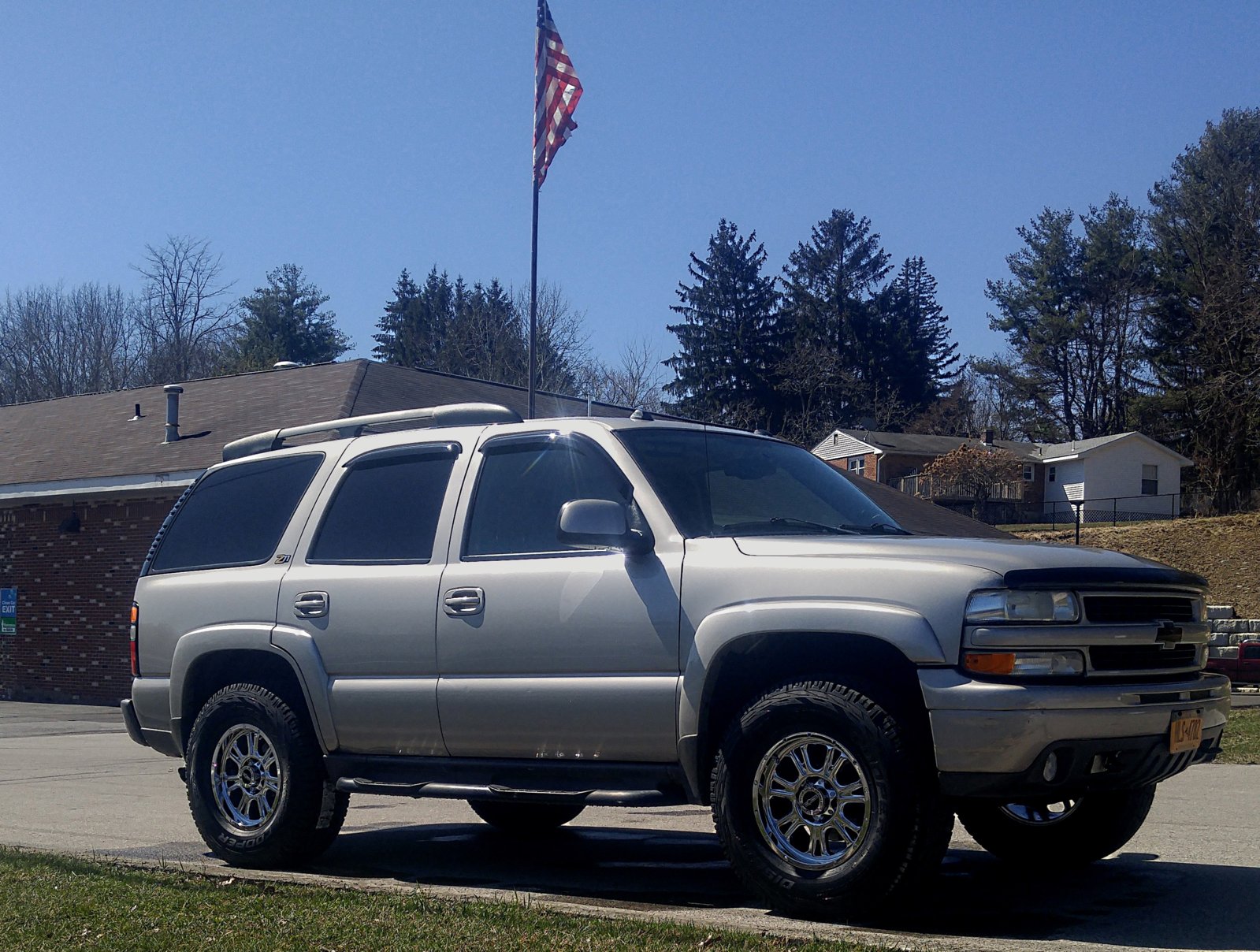

Pictures as promised,...tires measure 34x12, 2.5" lift key in front, stock Z71 springs in rear,... had some minor trimming on drivers side front inner fender plastic, trimmed about an inch off the front where it meets the windshield washer reservoir, and a heat gun to the rear of the ds front inner plastic was all it took. These rims are 0 offset and I feel the tires could come out another inch or so. I may ad 1" spacers. All for corners are sitting at 39" fender height, im defiantly going up another inch in the rear..... air-lift bags not installed yet. So on previous trucks Ive always ran two air lines T'ed into one shrader valve, but doing some reading on the issue, it seems that load shift and air transfer is a very real thing, its a hard concept to fathom because you would think 30 psi is 30 psi no matter what,...opinions?

The offset isn’t going to make it have a lip on the rim. The width of the rim matter. Can’t have a lip a on 8.5wide wheel... need at least a 10”wide wheel to get a 3”+lip.
Actually, if you go back and look at the first pic I posted, the wheels showed a decent lip, the spokes where basically centered in the wheel,...but when the wheel arrived the spokes were actually negative offset and the back where it mates to hub was built up about 3" (see photo of actual back side of wheel). So that was a bit deceiving for me, but the wheels were mail ordered so not much I can do know.

If the wheel is advertised as (0) offset, one would think that the spokes would be centered,...but instead they built up the back of the wheel about 3"

The first pic is a stock picture of like 10wide or 12wide wheel. U can’t go by a stock internet photo. I can tell by looking at the photo it’s not a 8.5”wide wheel. Yes Very deceiving if u don’t know wheel well. The custom offset videos on YouTube have a lot of good information about getting the right wheels for your truck
