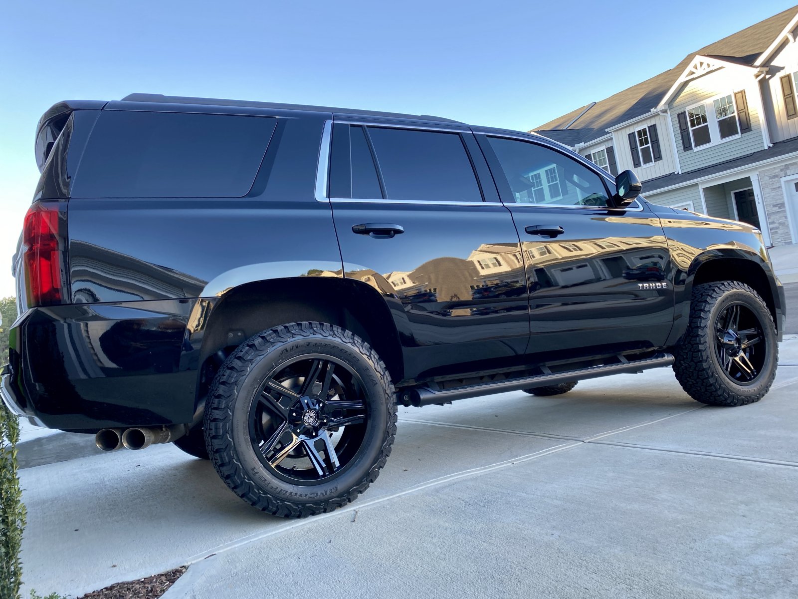

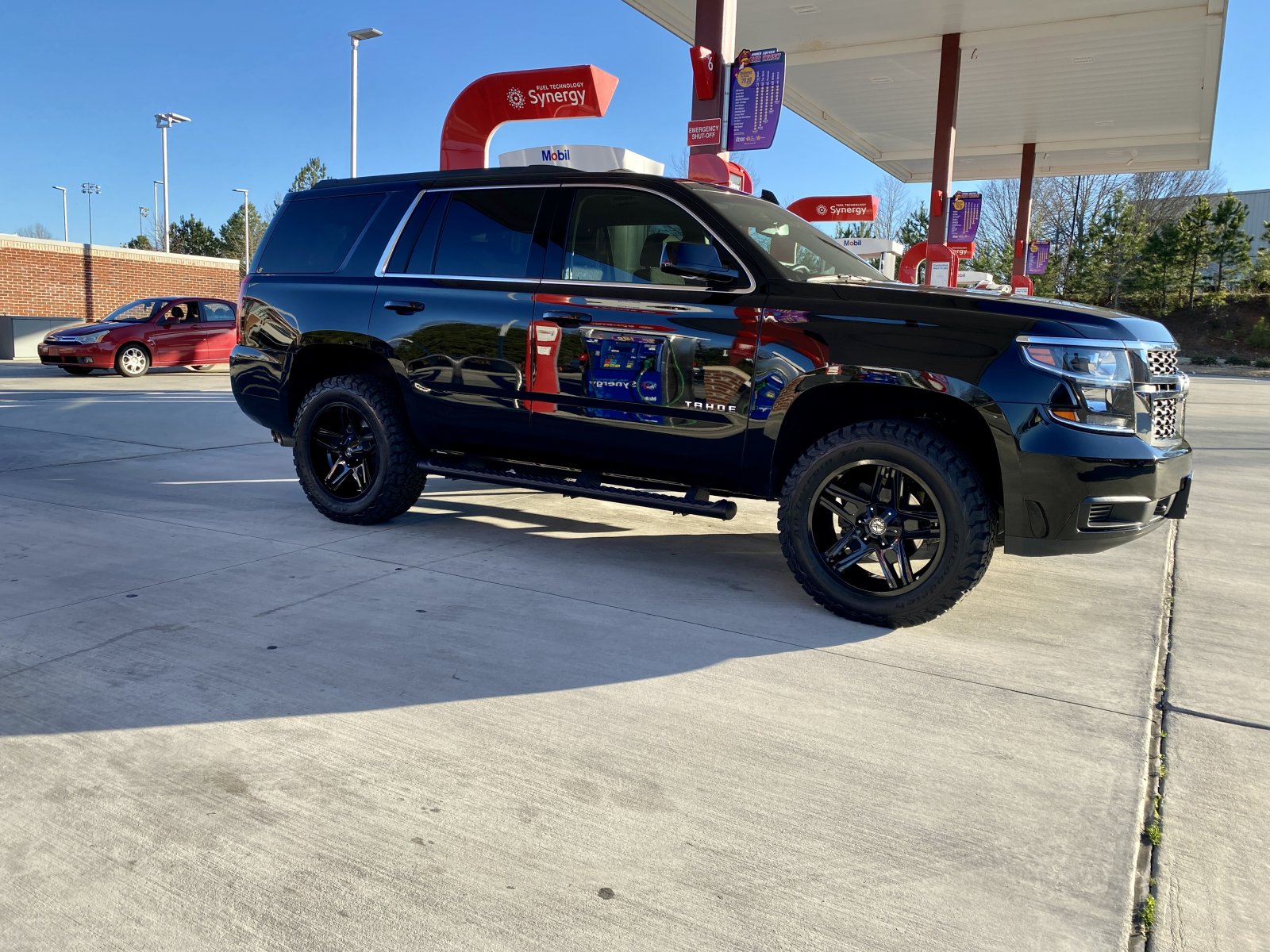

Mcgaughys 2" level kit in the rear, Tahoe 2017
rides smooth as silk now, before it was a chuck wagon.

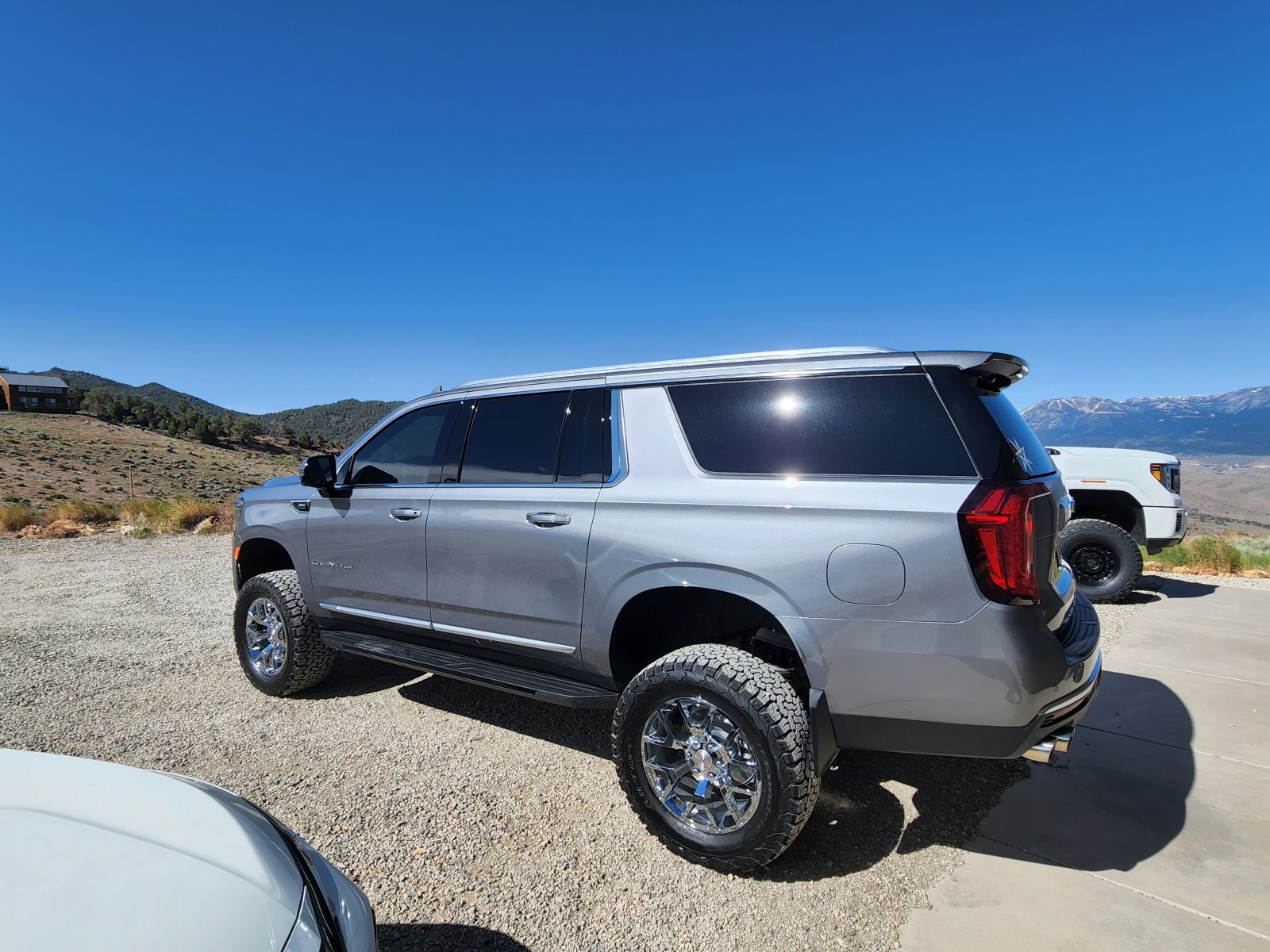

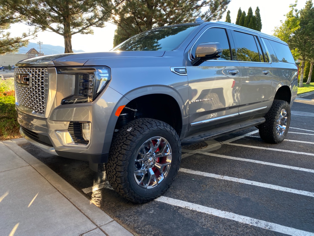

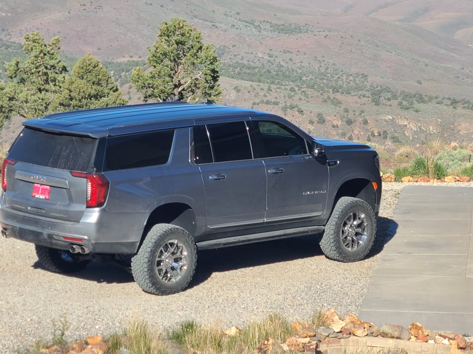

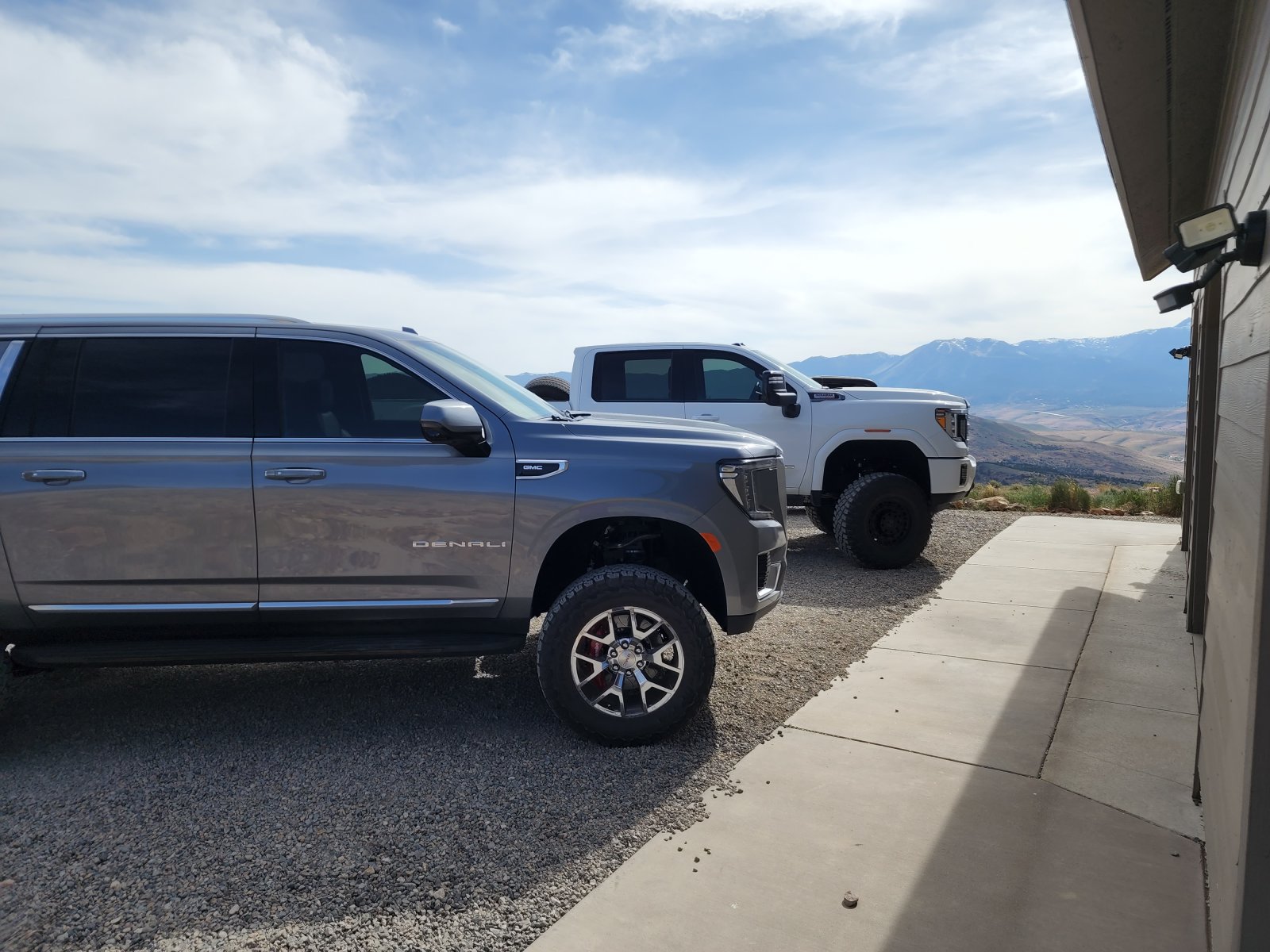

22 denali xl 6 inch lift, brembos, 35 inch before ats, corsa exhaust....more ro come

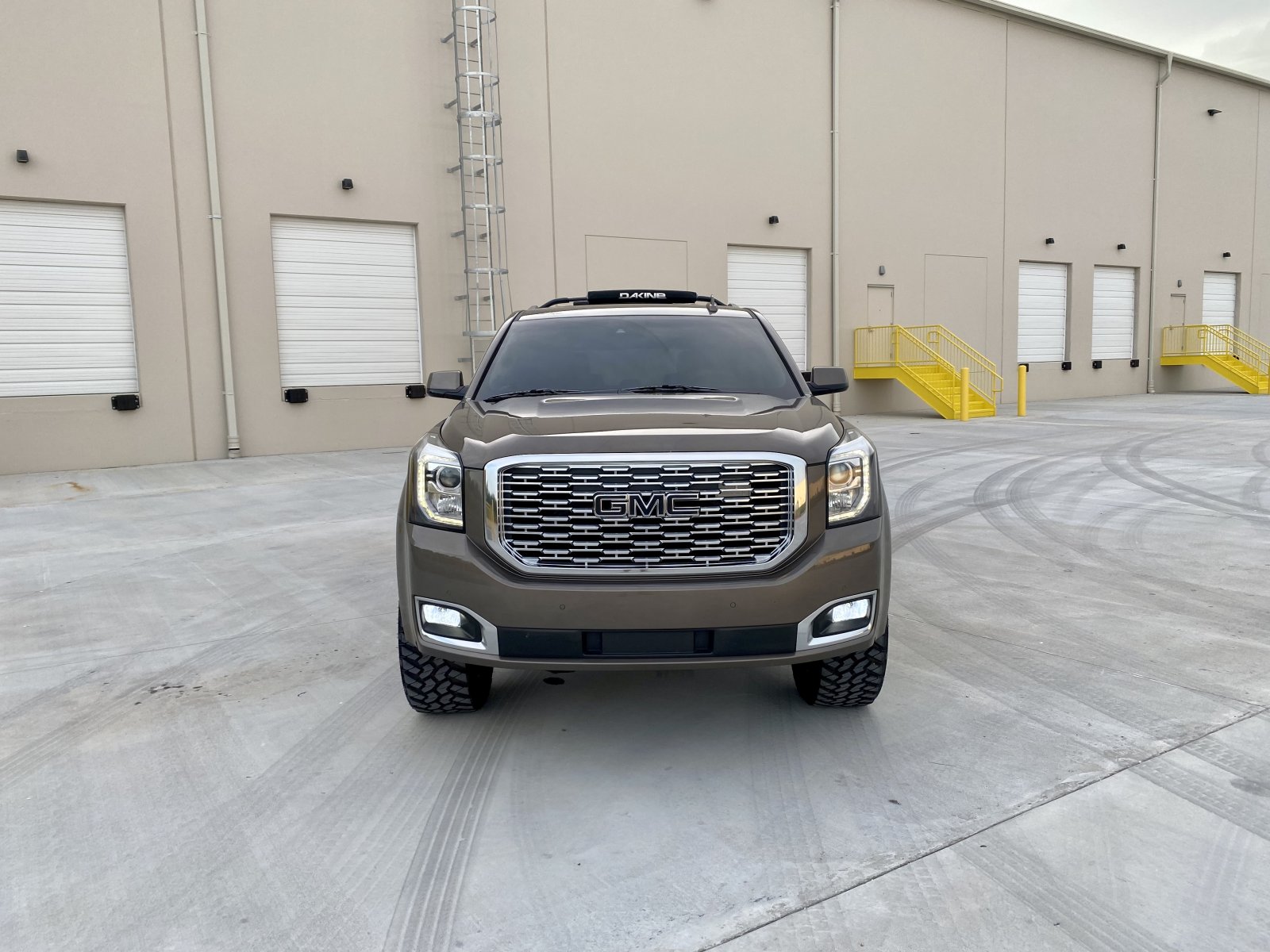

I haven’t crawled under to look, is it one piece with the front bumper? I was hoping it was separate and attached somehow and could be removed.
They can be removed but my understanding is that it's kind of a pain to do. Also it kind of leaves an unfinished look imo. I left about 2.5-3 inches of material if i remember correctly. The PPV ones I think are more like 1-2 inches. You can click that image and zoom in. Hard to tell at the angle but cutting it right at the natural 'belly' shape of the plastic piece, leaves it just a little higher than the side steps when looking at it from the side. Looks much better but at the same time most people wouldn't know it isn't stock, and gained me about 4.5 inches of ground clearance. Plus I figured that maybe it doesn't totally negate the aerodynamic effects that it's supposed to help with. You could always trim more.

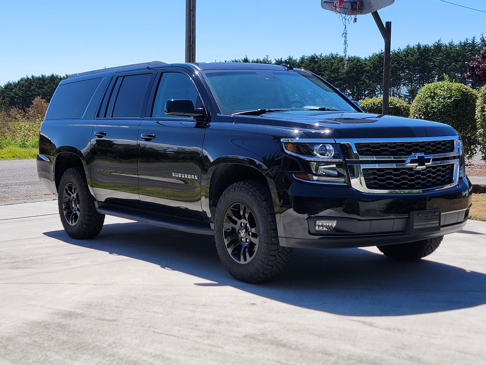

Finished 1st round of mods. 1.5 suspension maxx level and 2022 at4 take offs with 33s. These wheel wells have way more room in the front then my old NNBS. Eventually going to throw on my 2 5 / 1 " ccm kit and go a bit bigger on tires. Thanks to all on this forum for great info. 20230213_181346.jpg20230212_105348.jpg20230212_171252.jpg

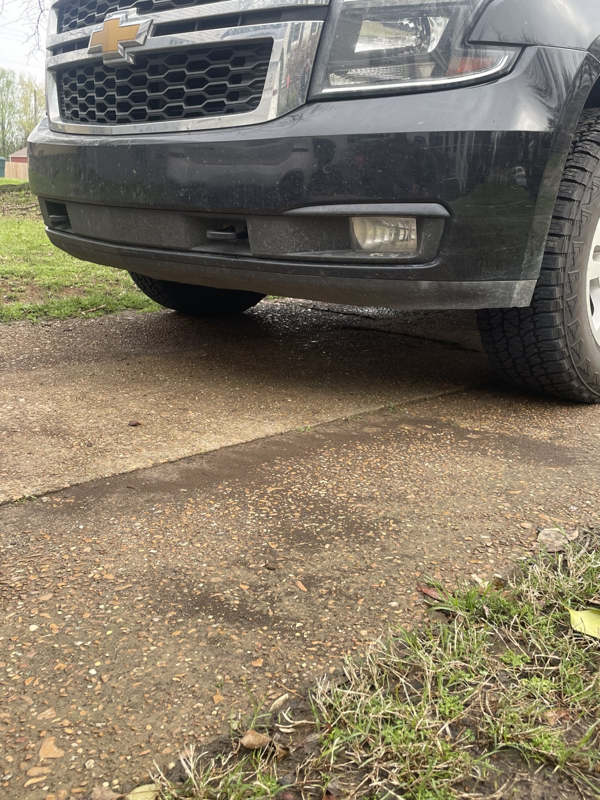

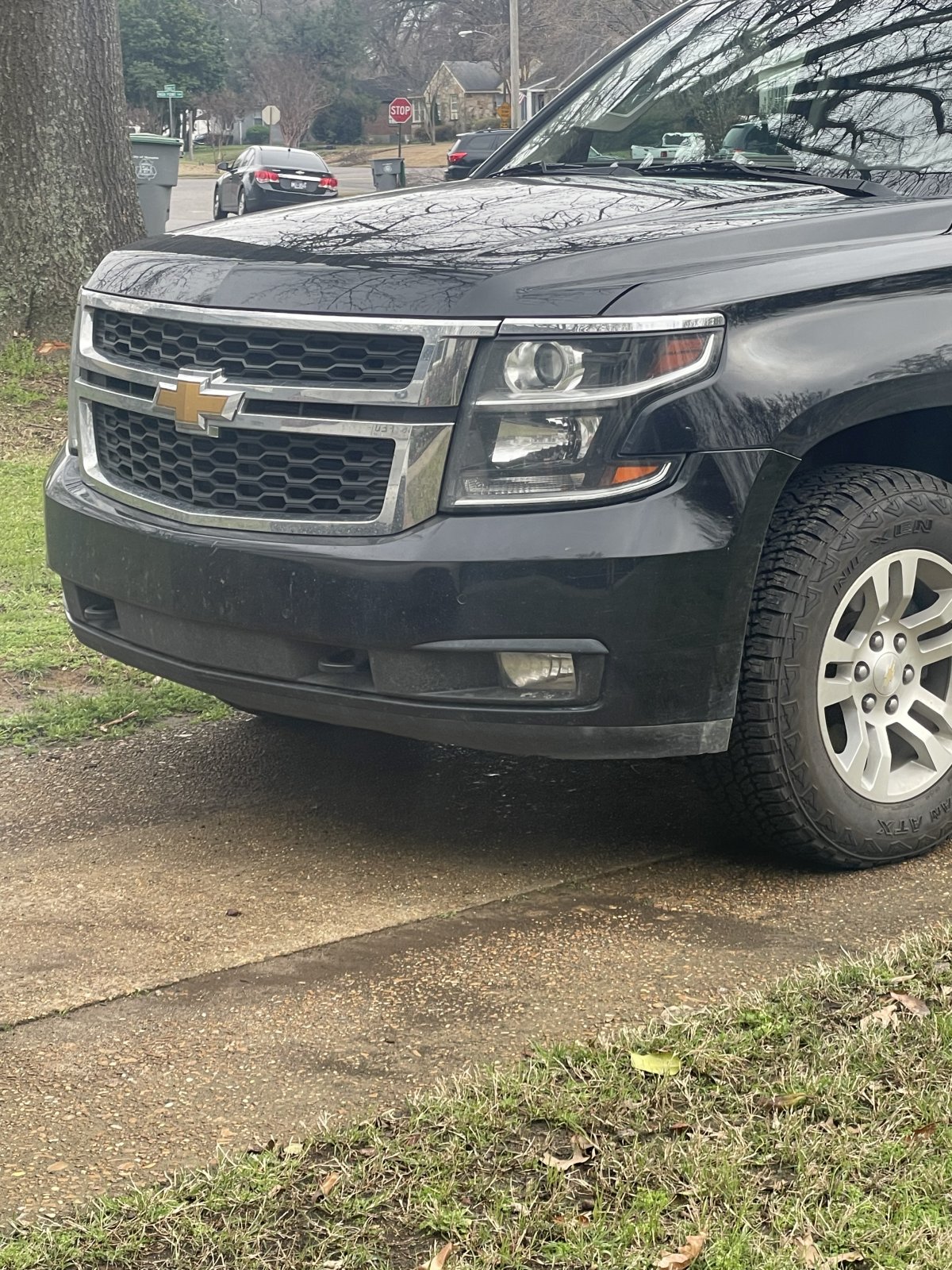

Did you trim the front air dam using a saw of some sort or were you able to remove it somehow?
I used an angle grinder w/ a cut off wheel to cut mine off. I taped my line and tried to follow it the best I could. I think an oscillating tool would be better than a grinder with a cut off wheel but it did the job. I definitely went quick and didn’t do the cleanest job but sanded any chunks of melted plastic off and you can only see the imperfection if you get on the ground and look under the bumper so don’t worry too much about not doing it perfectly. I’m glad I did it but may use a different tool if I had to do it again.
