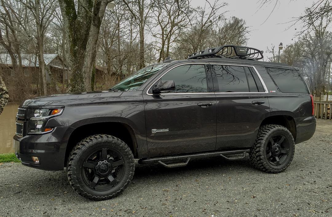

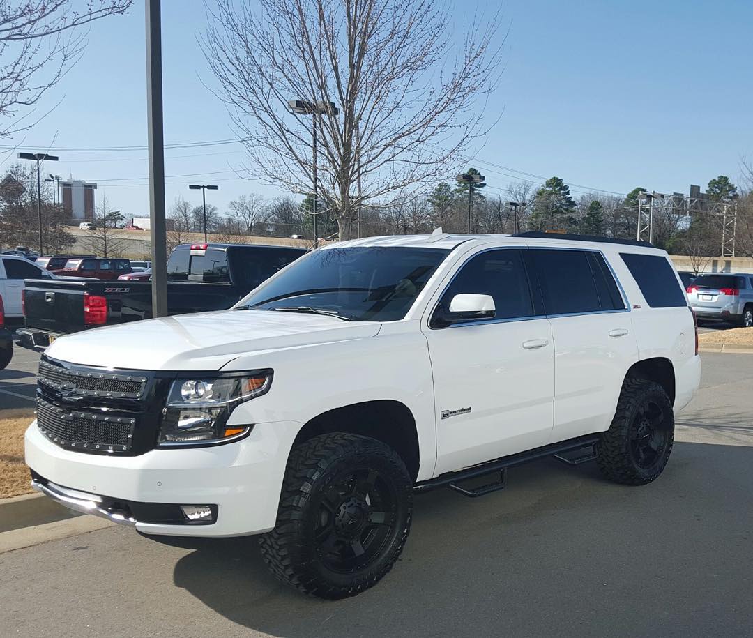

Here is a before pic

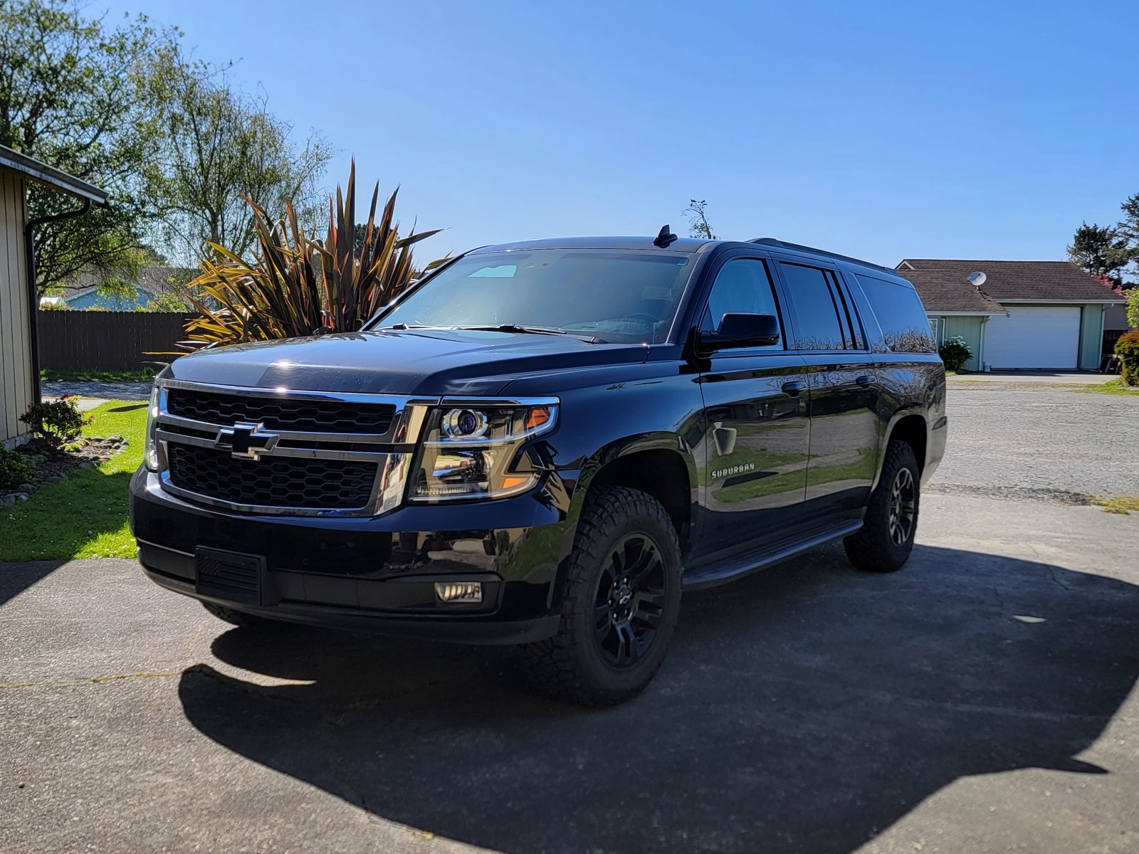

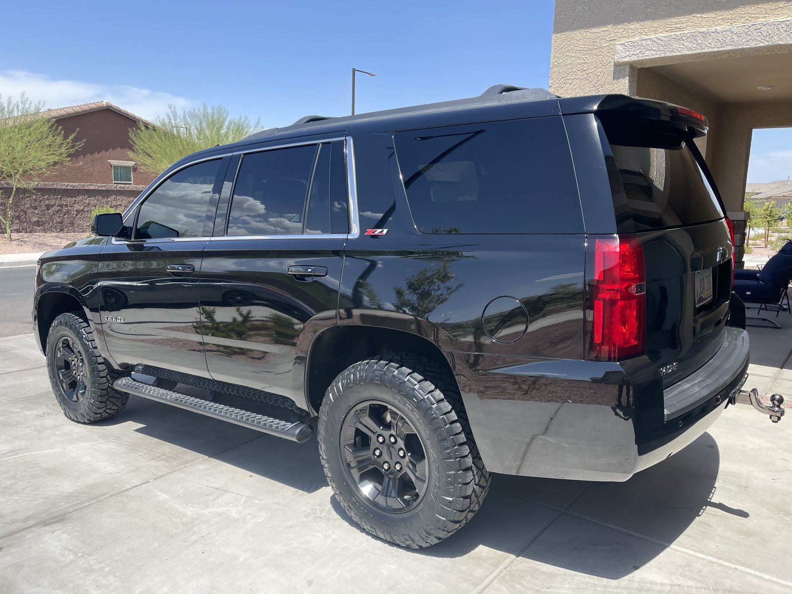

2017 Suburban LT 4x4, luxury package plus the 'sun, destination & entertainment package'. Suspension maxx 1.5" level, Nitto Ridge Grappler 265/70r18 E rated tires (32.87" x 10.71"), absolutely no rub before or after the level. Debadged the LT logos, and gloss black vinyl on the bow ties and window trim. Pics look much better if you click on them to view for some reason.

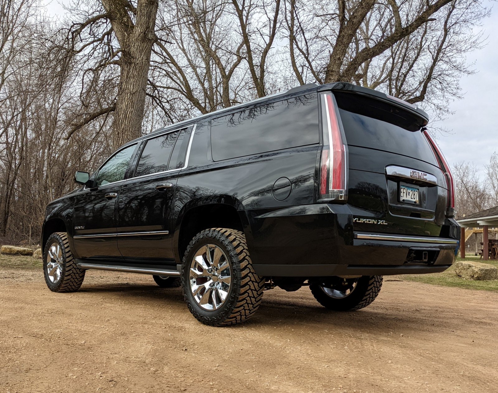

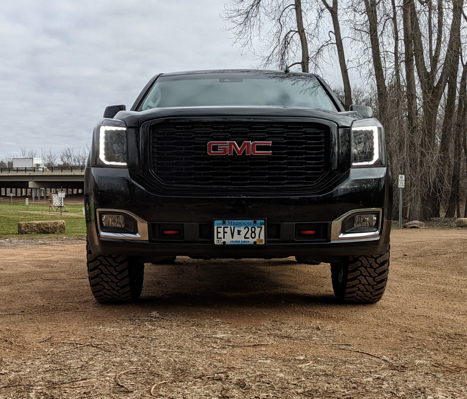

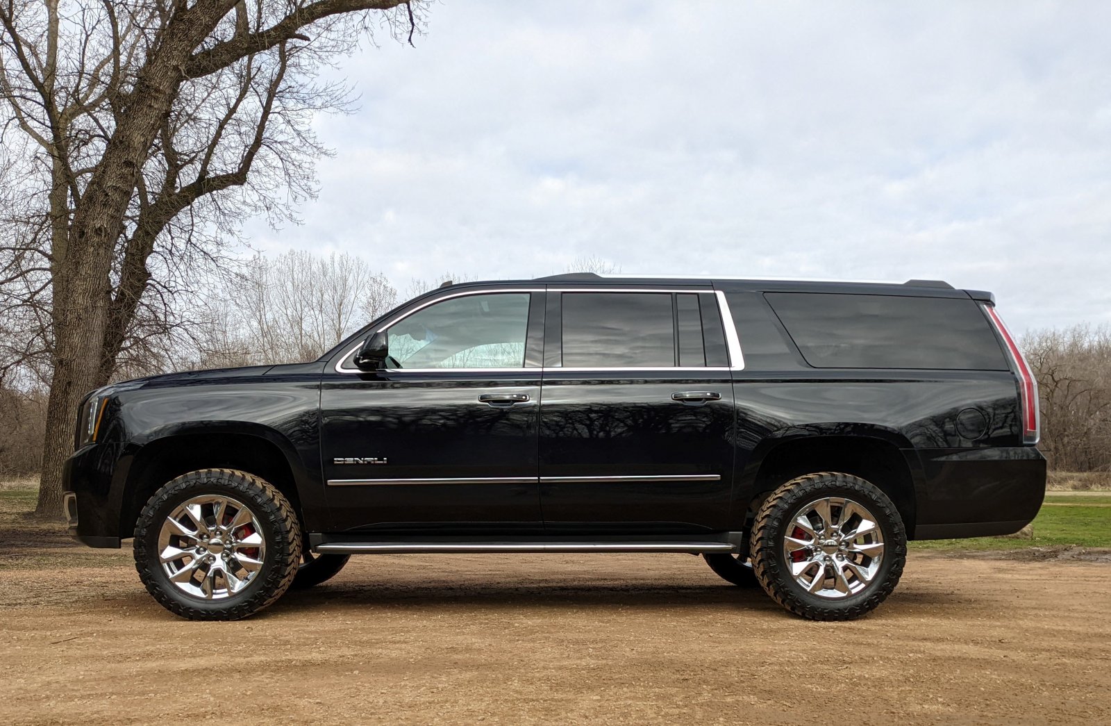

Thanks. Went from 1.75" to 2.50" up front and finally got around to adding the 1.5" stack's and 1.5" rear shock extensions. New magnetics and other suspension upgrades all the way around.
olyelr
Mar 19, 2011
1,896
973
Elk Rapids, MI
Niiiice.
What about tires and wheels? 33x12.5/20’s?

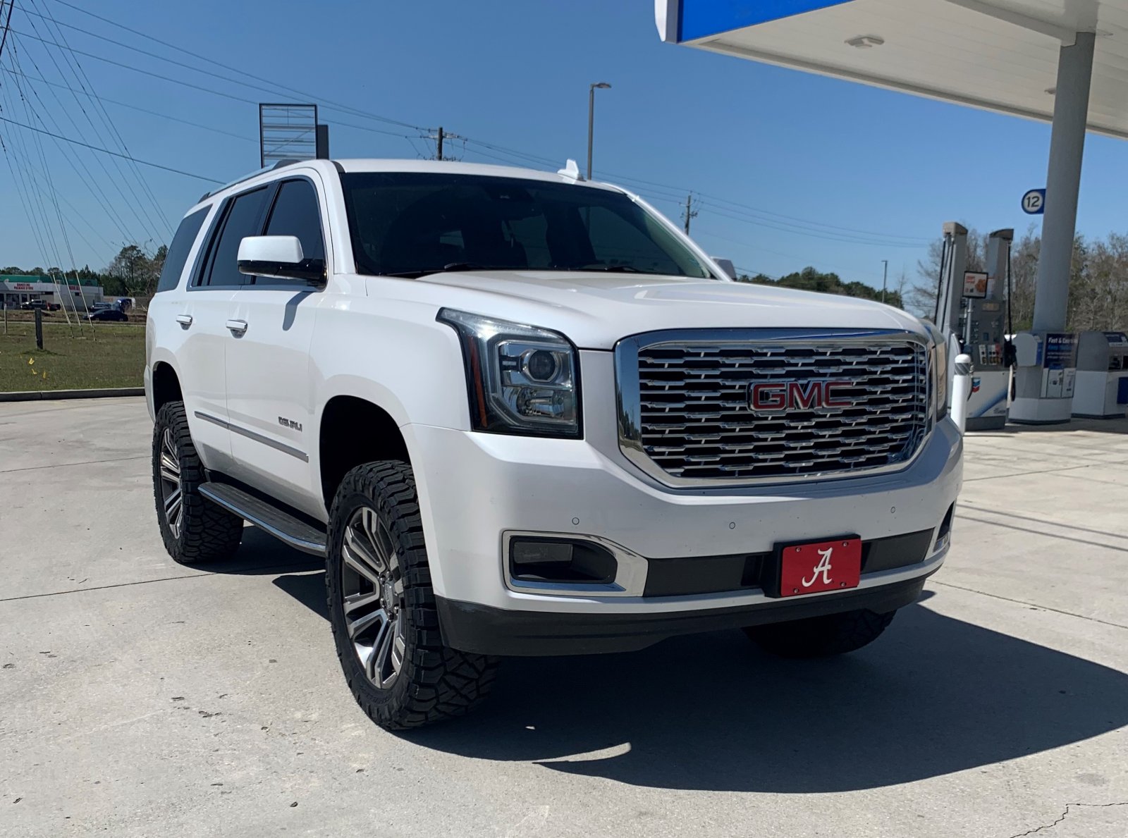

Just finished this weekend.
3.5" front spacer with cognito upper control arms/kryptonite tie rods/Movotech lower TTX with Blistien 4600 shocks/struts F + R and +3" rear spacer/extended sway bar links (sits actually pretty level) and angle are good (no CVS)
Rims are 20x10 ultra hunter with 4.5 backspacing and 33x12.50r20 tires.
Slight rub on full lock/driveway (bump) but normal driving no rubbing. Drives really nice and solid feeling.

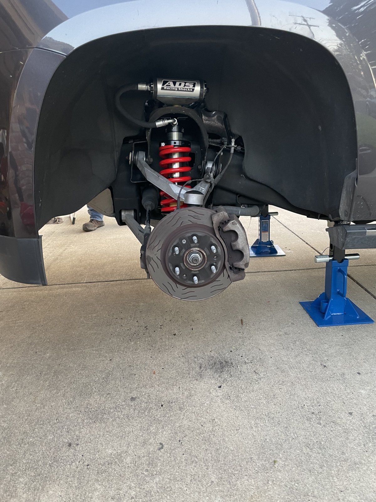

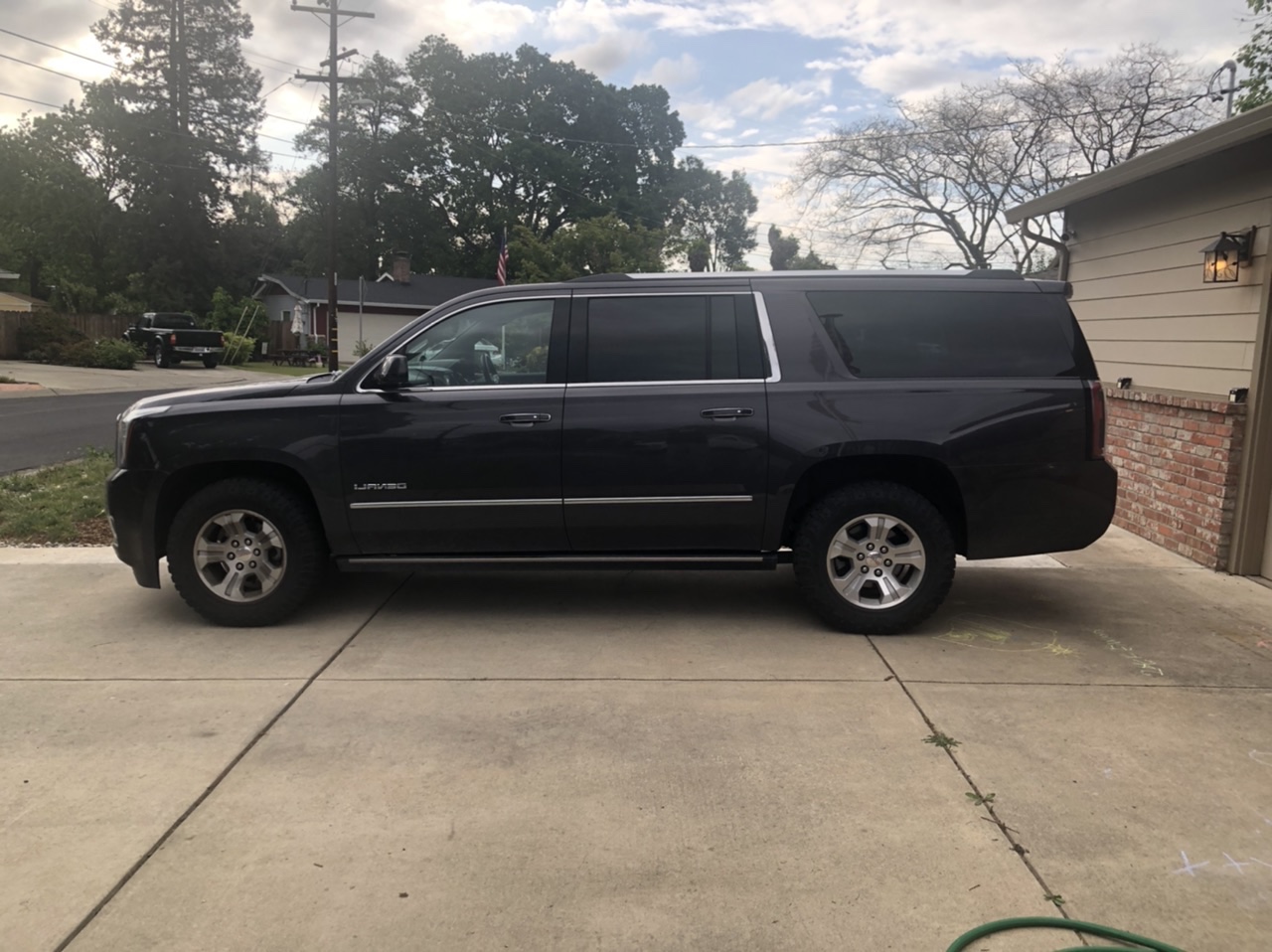

Before and after. Installing rear springs today. So I’ll post the final pics later.
Hoping for around 2 inches lift all around.
Ads 2.5 coilovers front and 2.5 remote reservoir rears. Lift springs and z71 bumps out back.
RC uca.

Anybody know the motion ratio? I need to lower the vehicle about 1.5 inches and I have 15 threads showing (1.5” of threads).
I really only want to take the coilovers off once.
