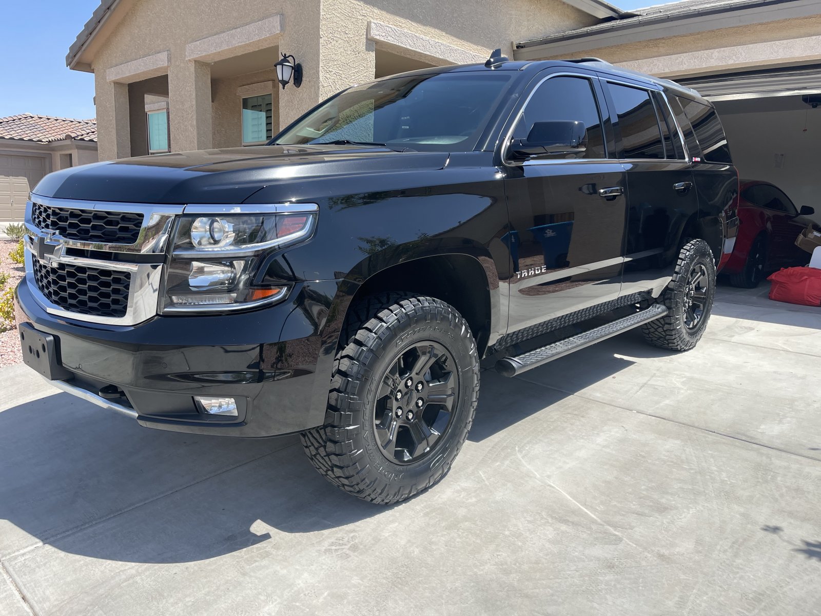

2017 Z71 midnight edition
Leveled on Fox 2.0 front coilovers and rear shocks
275/70r18 Nitto Ridge Grapplers on stock 18’s
Really like the way it turned out.
View attachment 376312View attachment 376313

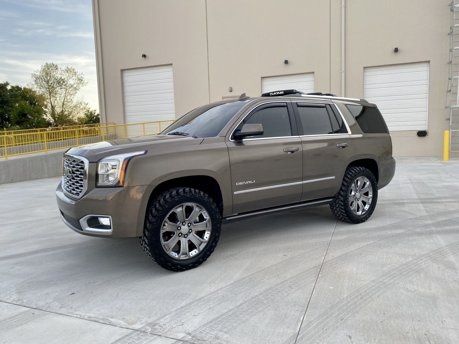

Specs? 35x12.5’s? Need any spacers for the wheels? How much lift?
Looks great!
These are 285/55R22 Nitto Trail Grapplers. No spacers we’re needed for these wheels. I am running a SuspensionMaxx 2.5” leveling kit in the front and stock height in the rear. Thank you!

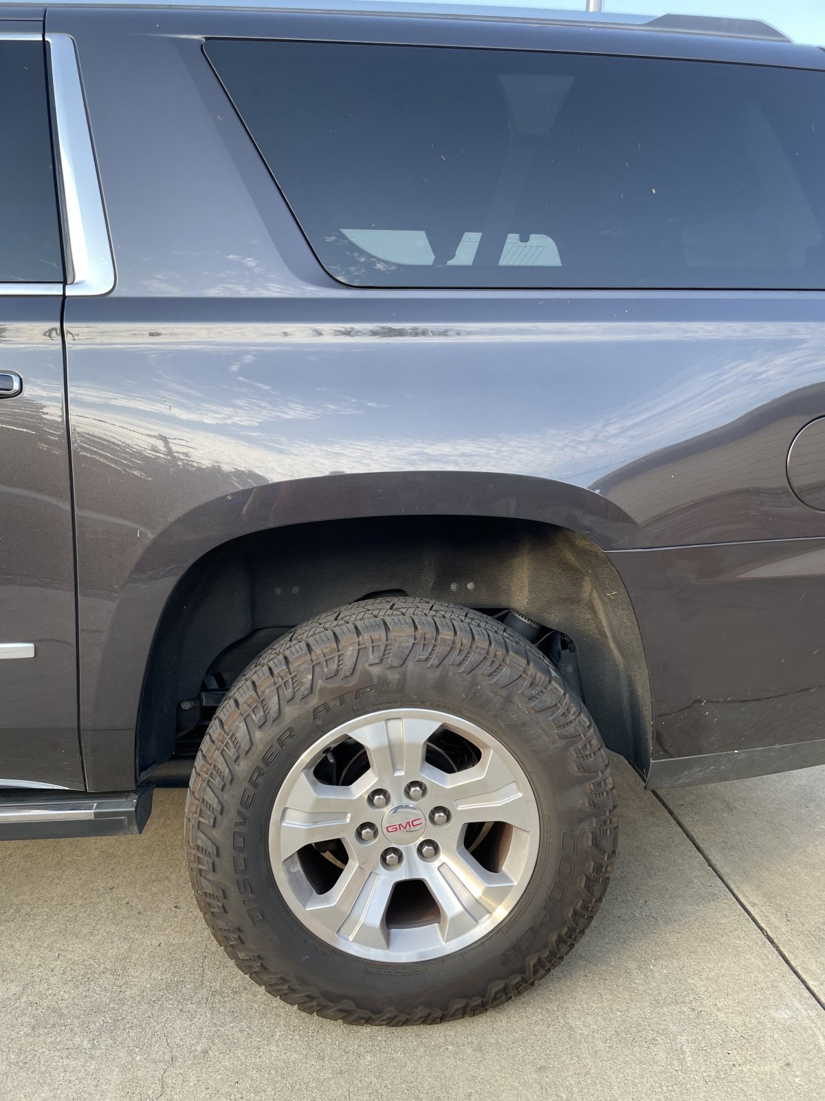

Before and after. Installing rear springs today. So I’ll post the final pics later.
Hoping for around 2 inches lift all around.
Ads 2.5 coilovers front and 2.5 remote reservoir rears. Lift springs and z71 bumps out back.
RC uca.

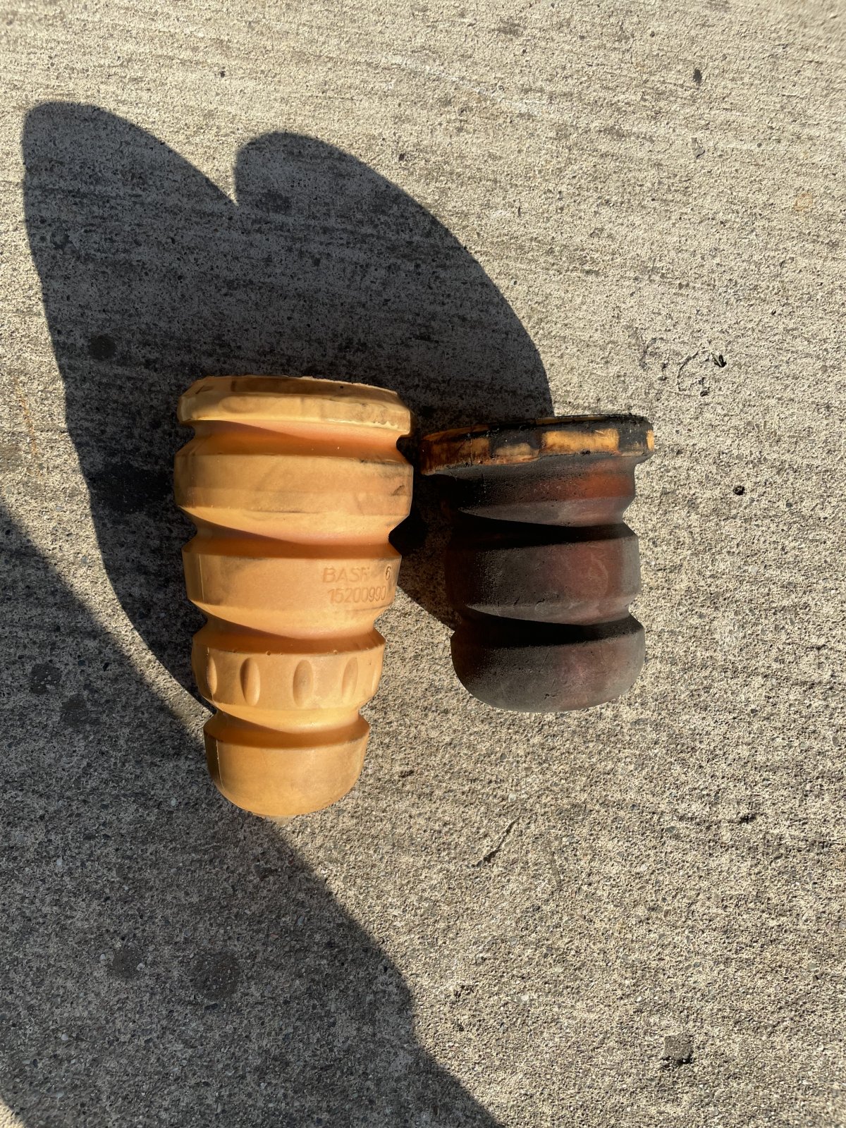

Ads put my rear shocks on hold since I set up a discount code for people (tell them juicier and it’s 10% off and tuning).
Anyways, my eibach shocks were leaking and I had these multimatics for a zr2 sitting around.
Threw them in. Better than blown shocks, but horrible low speed dampening.

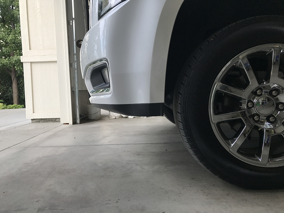

I’m trimming my air deflector soon. I want to cut this much off like you did here. Has anyone trimmed theirs with an angle grinder with a 4 1/2” cutoff wheel? That’s the best tool I have to do it and want to make sure it’ll work fine for this.
That should work fine, although maybe a little overkill. It's very easy to cut. Maybe try and use the thinnest wheel you can find to reduce the amount of melting. I used an oscillating multi tool for mine and it buzzed right through it no problem.
cardershack
Oct 26, 2022
36
I ordered new cutoff discs on Amazon and they are 3/64” thick. Sounds pretty thin. I know it’s probably not the best tool but if it will work then I was going to do that since I already had it. If it may be harder to do a good job then I’m fine borrowing ir buying the best tool for it.
BeenChevy
Feb 24, 2015
521
262
Minnesota
An angle grinder will work. Just make plenty of relief cuts along the way. I'd even try grazing a line with it rather than going all the way through on your first pass to reduce catching. Might even be able to break sections of with a pliers.
Used an inexpensive ~$30 Dremel for mine that included the round sander to smooth things out. I'd go that route again over an angle grinder of you're able to get one. Good luck either way.
