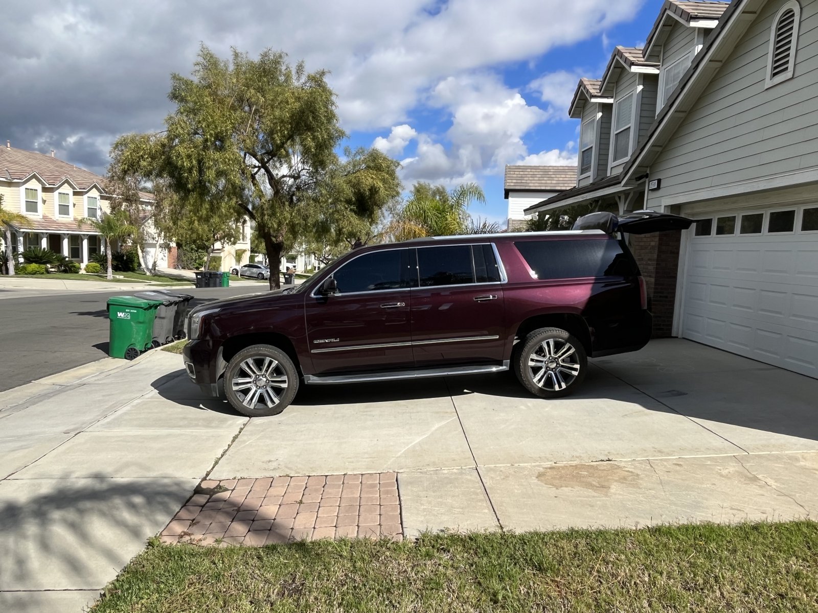

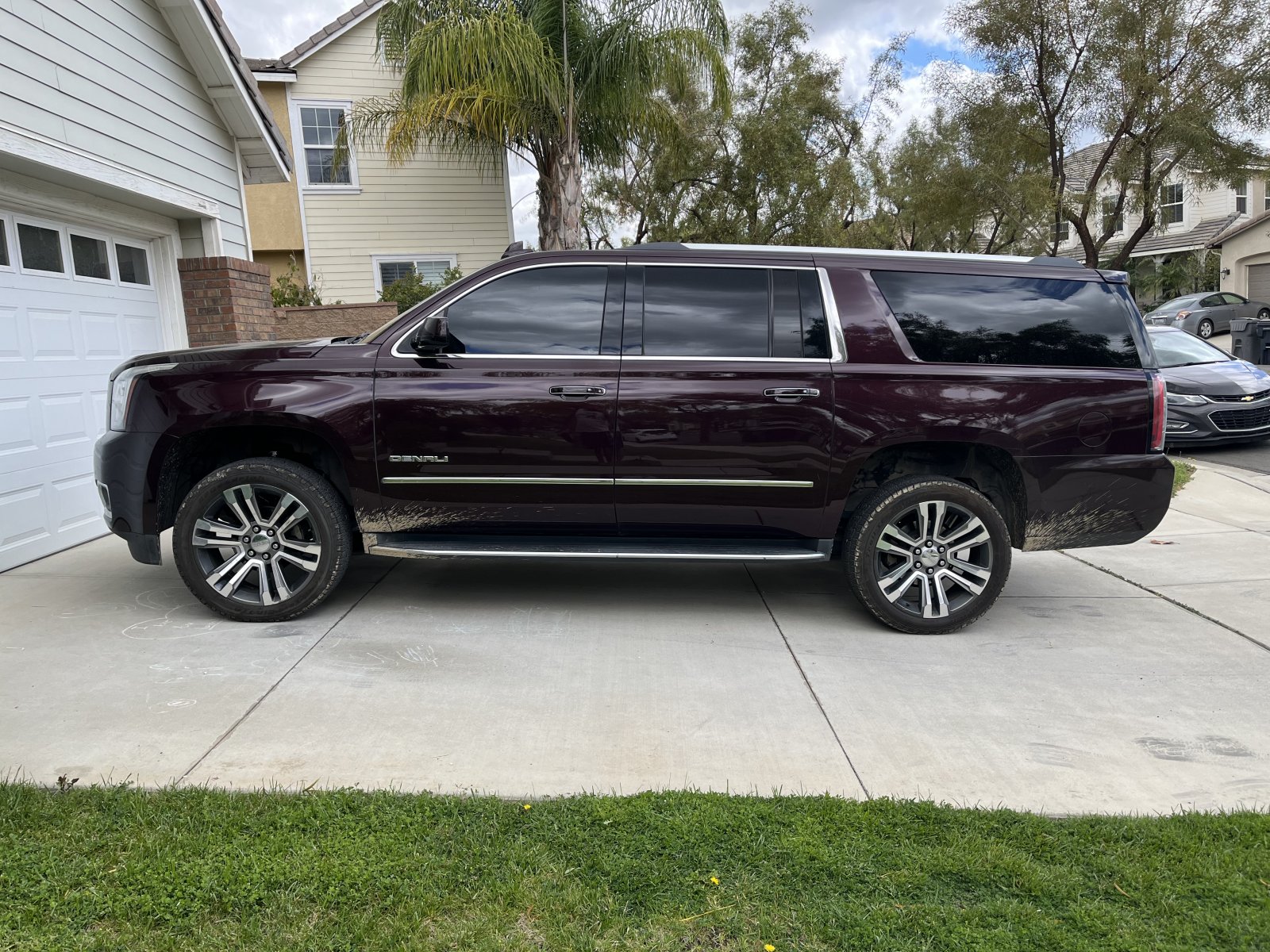

My 2017 XL Denali

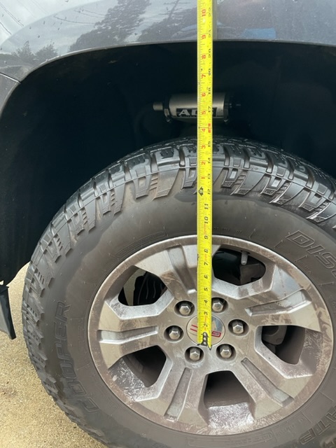

Can people measure from the center of the wheel to the fender lip?
And then state what lift they are using?
This eliminates any tire size differences and can let people see how much real lift things give

These are not the actually measurements in the pic. I just couldn’t hold the camera and tape measure at the same time. But it shows what I’m talking about for measurements.

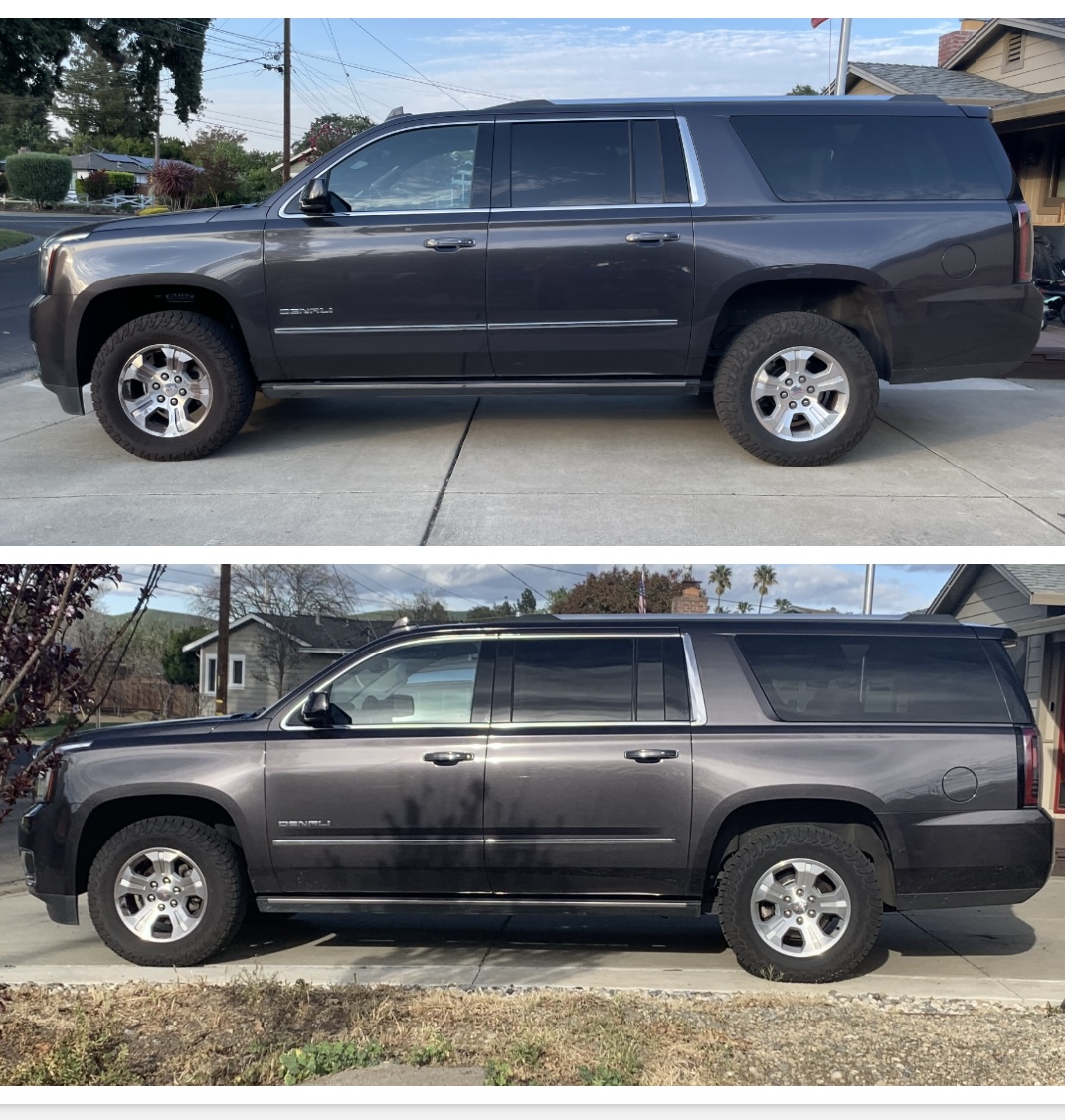

Arnott with a 1.5” level and stock rear Yukon Xl Denali springs.
Vs
Ads coilovers and border patrol suburban rear springs

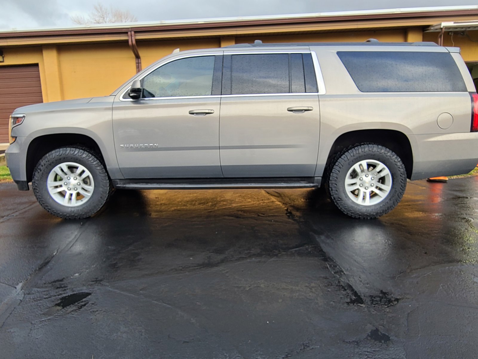

Bilstein 5100 front adjustable height shocks at highest setting (1.75-2" depending on different sources), no rear lift. 275/70R18, 33.2" nominal size Cooper Discoverer ATPII. No rubbing noticed so far. I have before measurements, need to officially record after, but quick comparison measurement had my front fender about 3/8-1/2" lower from ground than rear, and front fender about 1/4-3/8" less distance from tire than rear, ie. the slightest/perfect forward rake still.
The picture is a little deceiving on the front tire, looks closer to rubbing on rear of the front fender than it is because the (steering) wheel is angled slightly left.
