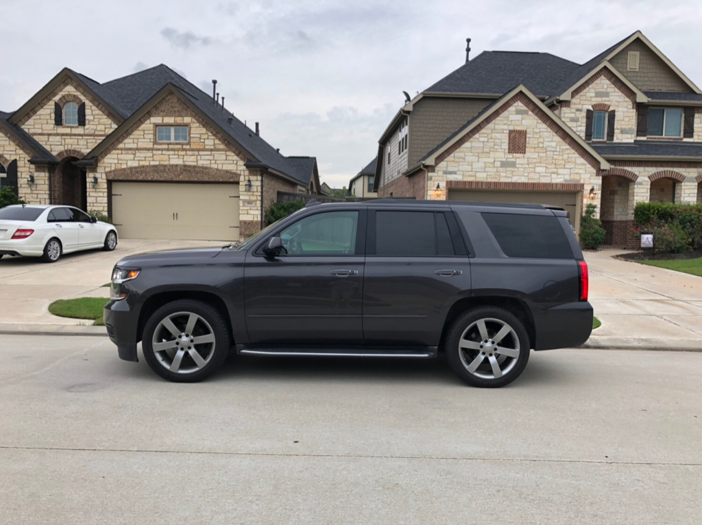

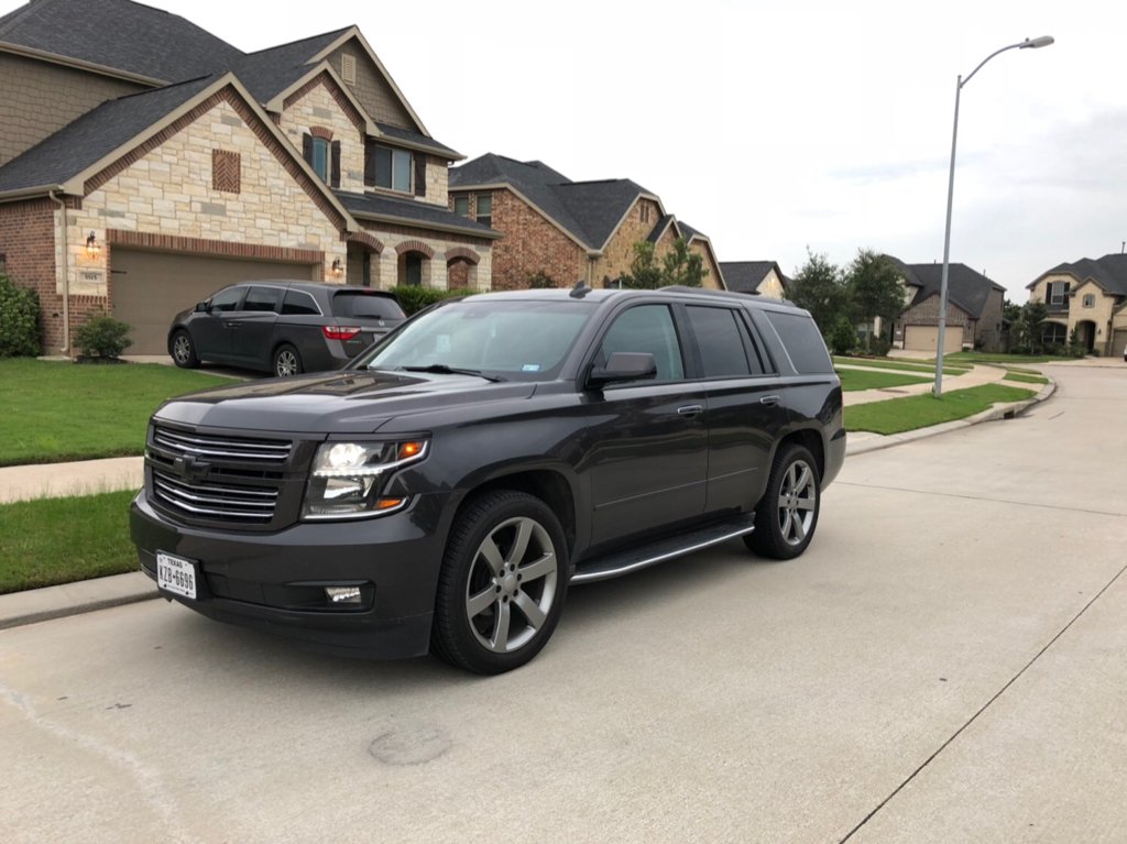

2016 rear 2” level on 22s
What wheels are these?
CMoore711
Jul 18, 2017
1,575
1,500
Trailblazer SS Replicas
Also known as TBSS Replicas.

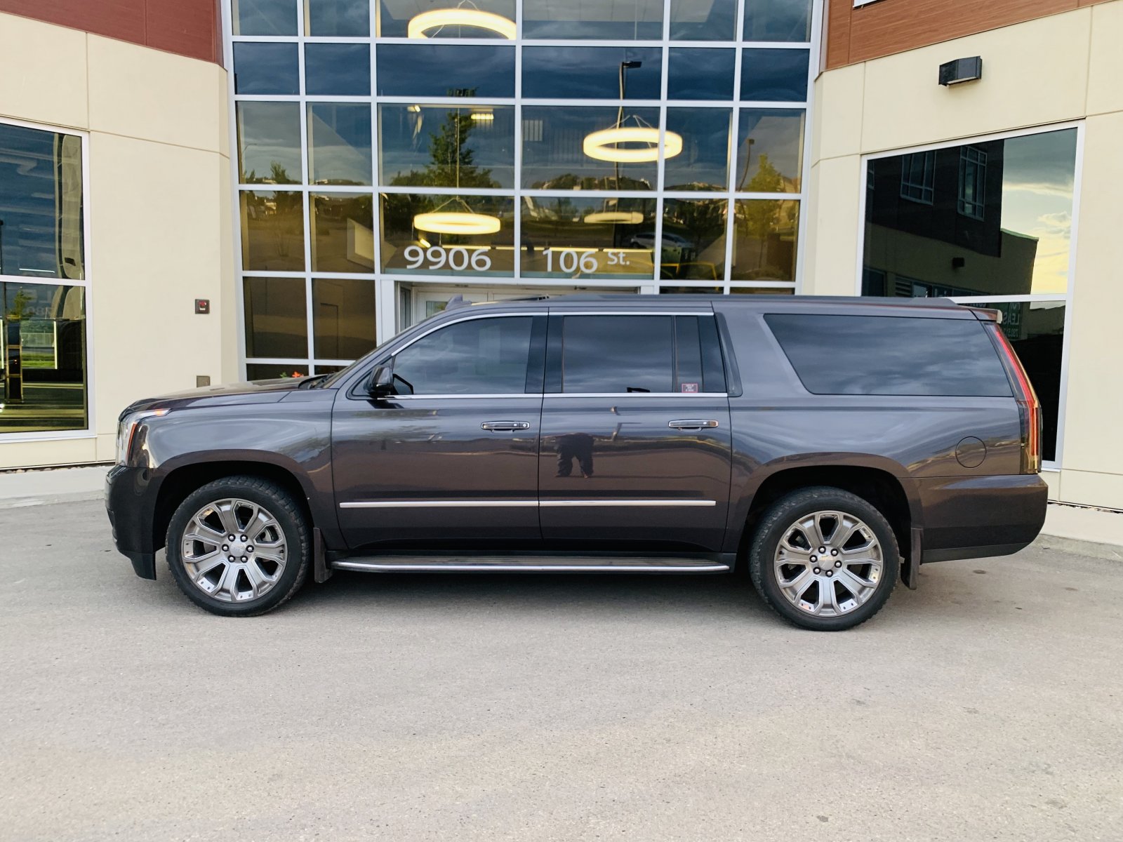

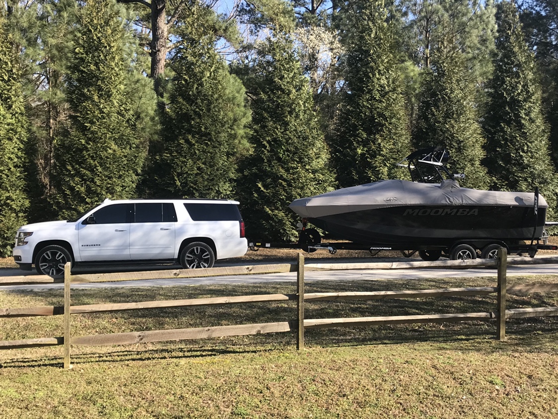

Made some length adjustments to the ride height sensor links and got it close to perfect. Tony’s 2” rear drop and still sits nice with a fairly heavy trailer, but the pump doesn’t turn on under normal conditions (no trailer and just me, the wife and kid). It seems to take about 150 lbs in the rear to kick on the pump, like when my niece and nephew jump in the 3rd row.

@Z28KE - Your truck looks great man! Do you have the max trailering package? I am wanting to do a level on mine but been told with the auto leveling system it's not possible. You are making me think that I have been misinformed.
Thanks for the help!
Kpwweb
Dec 11, 2015
771
357
You have misinformation. You can lower (or raise) with max trailering—just need to adjust the end links for the sensors. I have max trailering and have lowered the rear 2”.

^ yup
i have max trailering & am lowered as well.
reach out to Tony (Norcal SS)
he can get you sorted out

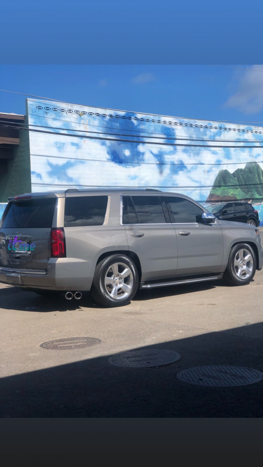

Took the family around the island the ride was great for been this low and hawaii has some ugly road . It dose rub here and there but dosent bother the wife and kids

What size hitch drop are you using to two with?

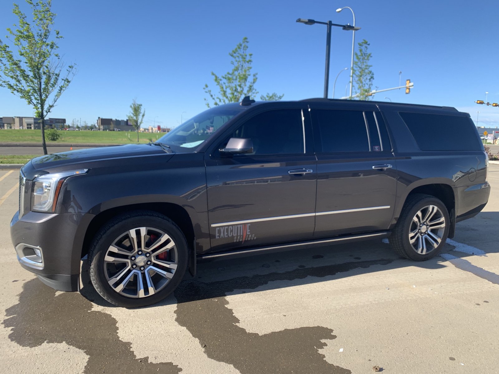

You’ve got me curious. What is Executive Driving Services? BTW the wrapped window trim looks good.

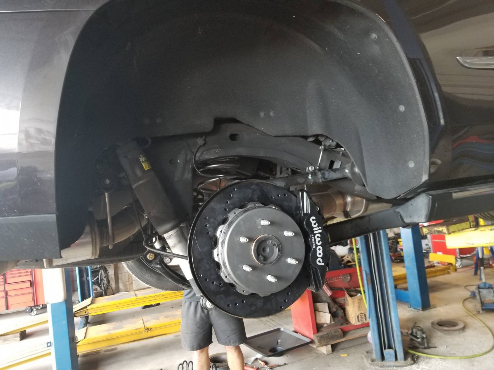

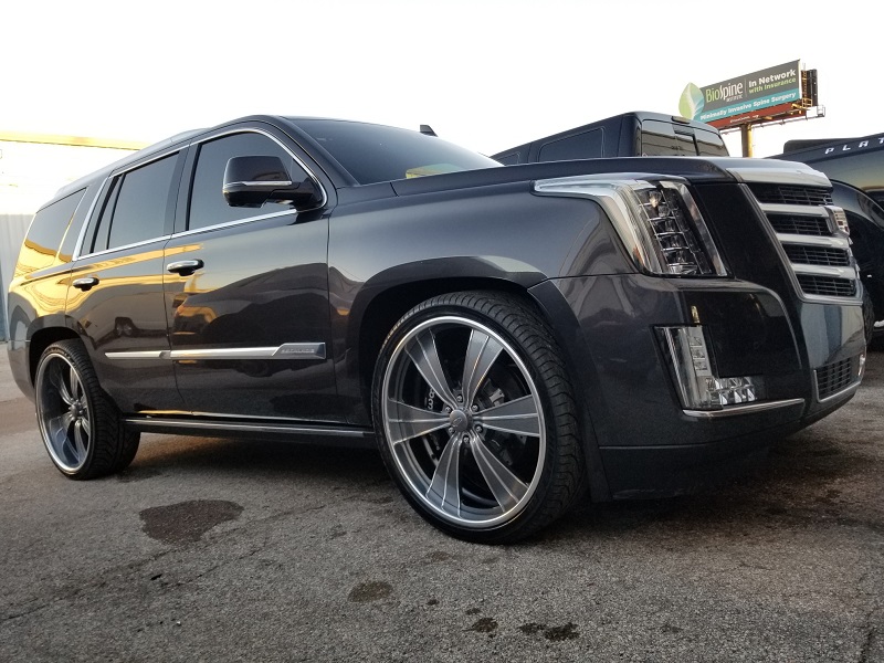

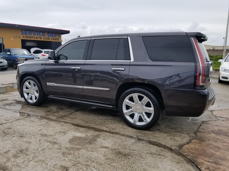

The Escalade sitting on Norcall SS drop kit. Thanks Tony for your help and guidance. This was the 4th or 5th mod as I had to wait about a month or so for the kit. But well worth the wait. Window Tint, Hotchkis Sway Bars and Exhaust were done while I waited for the drop kit.
First pic is after installing the drop kit and Wilwoods. The next stop was detail shop for a quick wash.
Next pic is after I had the wheels completed at the powder coat shop, mounted, & installed about 4 months later.

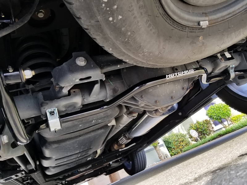

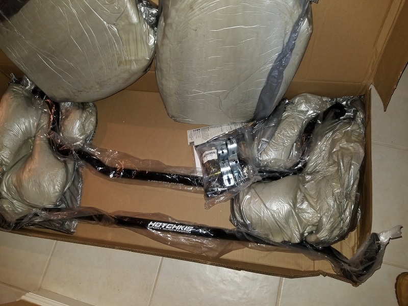

What do you think about the Hotchkis sway bars? Big difference? Are they designed for stock height or is it meant for a full suspension setup?
Staggered 02
Jul 5, 2019
672
1,556
Yes sir, I think they are great. Noticeable difference. They are designed for both stock or lowered. I have Hotchkis sway bars on the Escalade, My Crew Cab, and on my Impala SS. Liked them and the quality so much I went ahead and put a set on my G35 Infiniti.
Definitely would recommend. As noted, this was one of the very first few mods.
Found and uploaded the installed pic below

That looks great. I think it's the same drop that I did. Why didn't they do the free travel mod? Hit up Tony (NORCAL SS), he can help you with the compressor delete.
Any plans to upgrade the rear brakes?

I don't think they wanted to do the cutting. Maybe i will bring it to a firestone type shop and have it done quickly.
I may upgrade the rear in the future, not sure. I didn't do the drilled rotors though, just slotted
