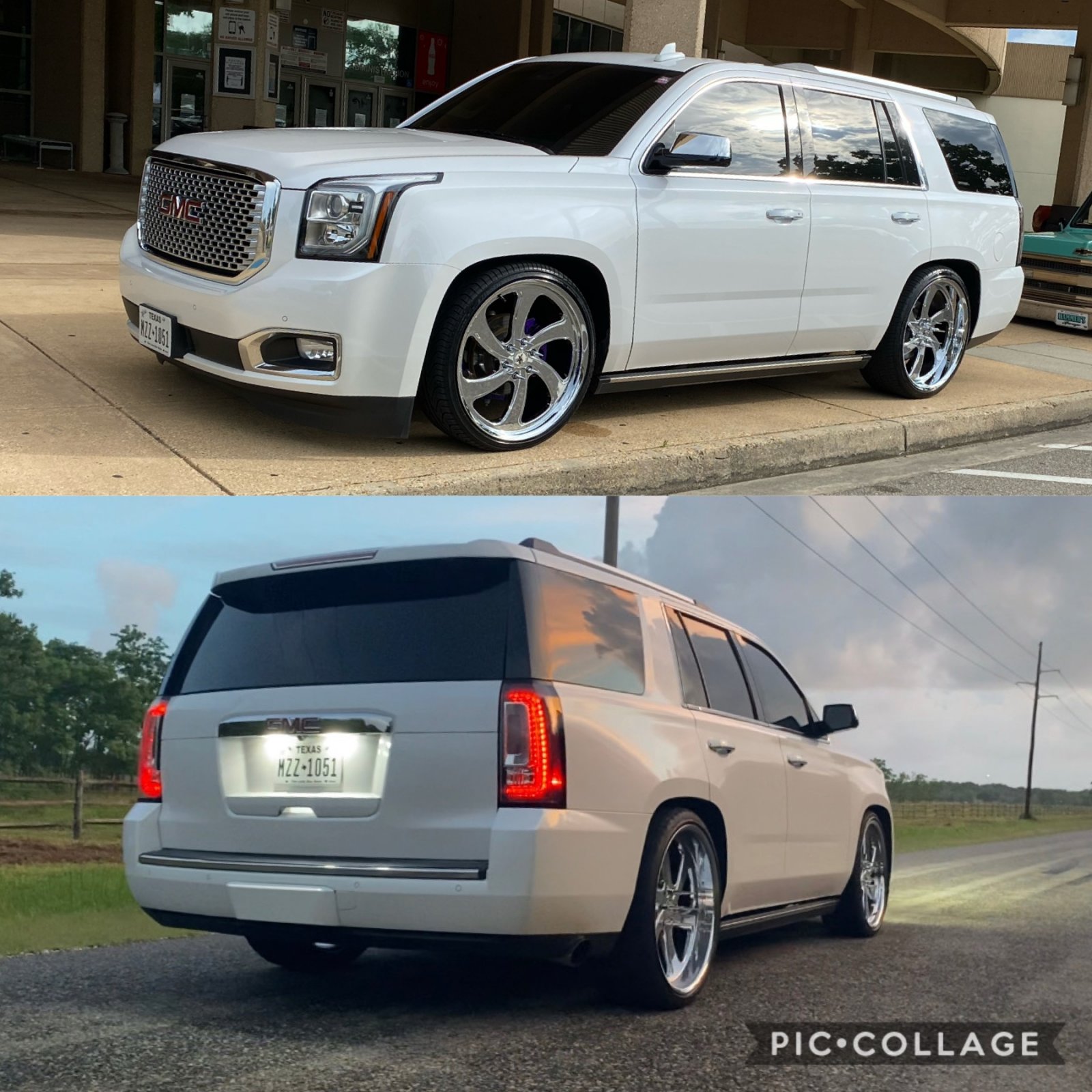

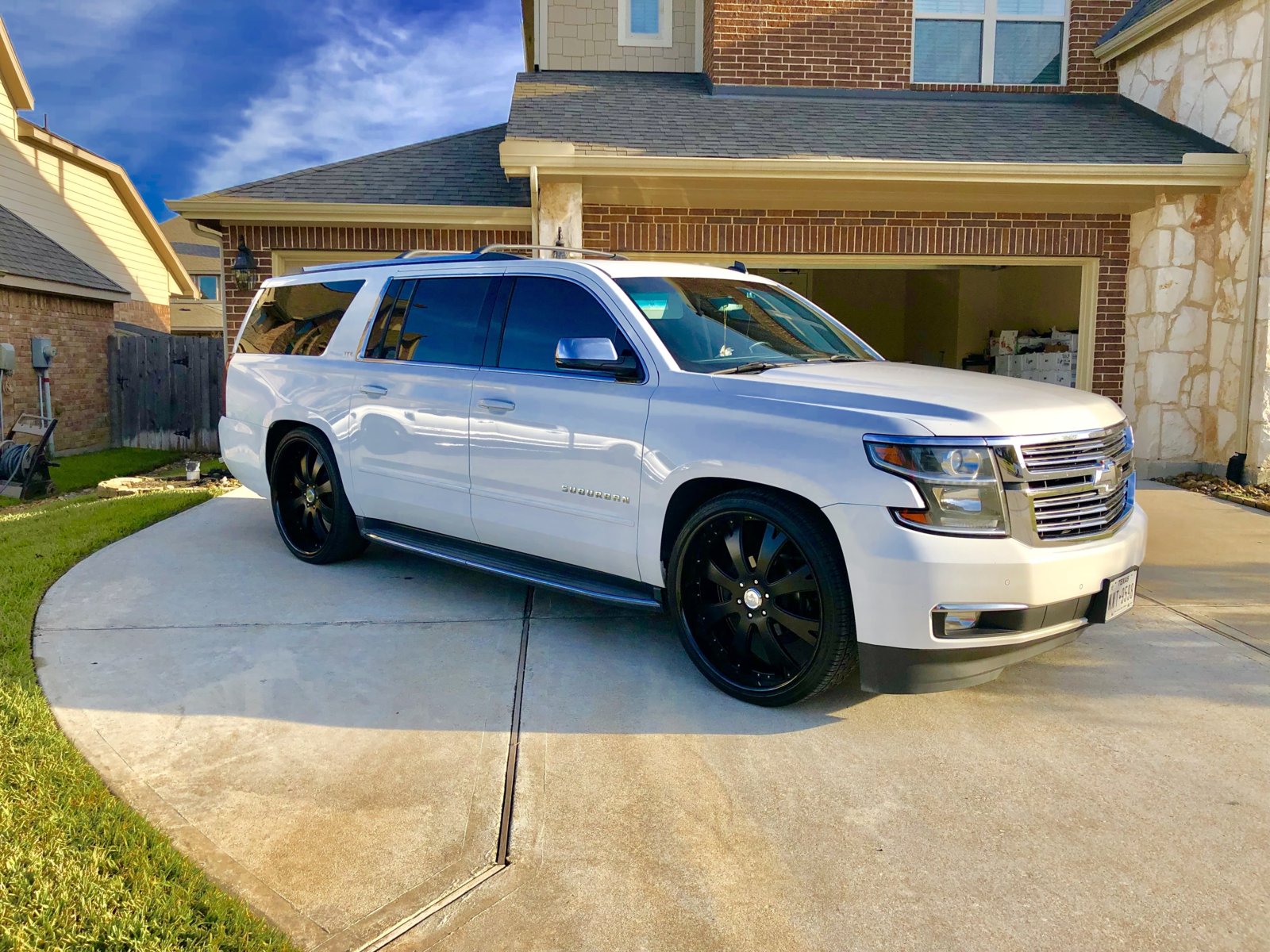

norcal_ss, 2/3-4.5 kit
Stock upper and lower isolators in the rear springs, no spacers, and the endlinks were cut a total of 1/4" (1/8th from each side). My links are 2-11/16" from center to center of cups.
24x10 w/ 305/35/24

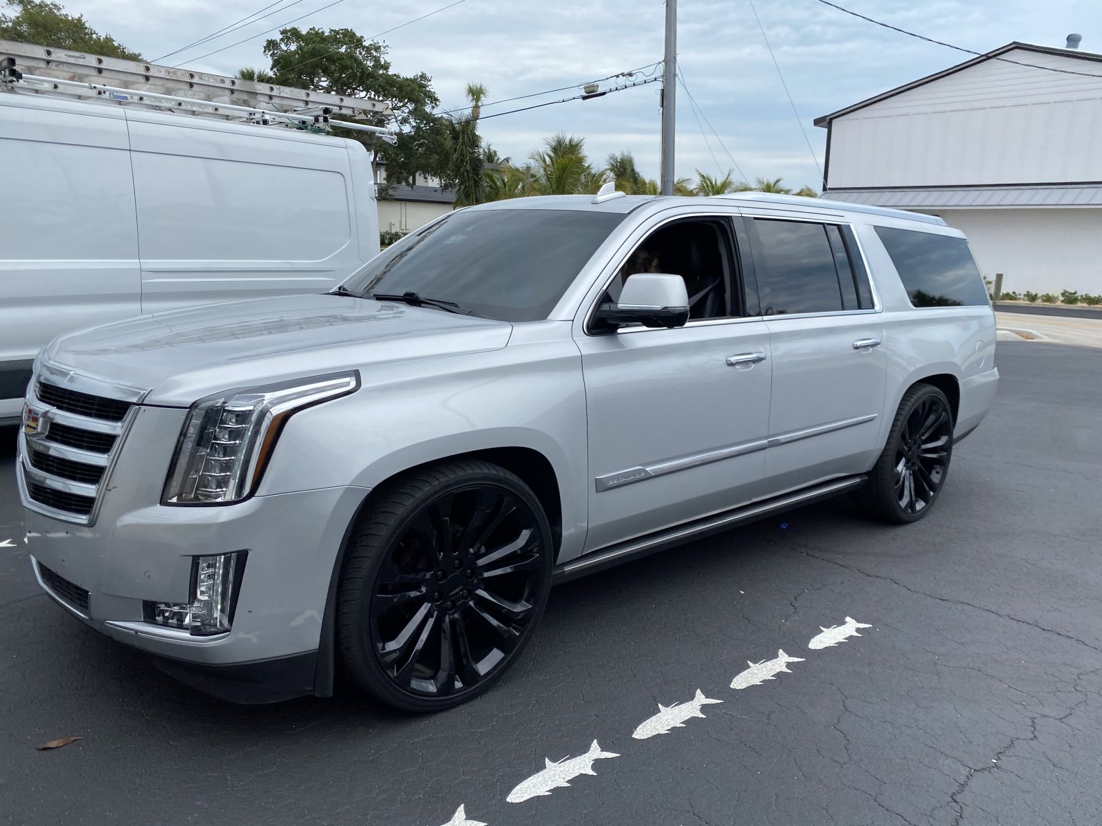

I, too, have never been a fan of the "slammed" look. Well done, it looks okay but, to me, it can be overdone too. That said, I did lower mine. I did 1" in the front and 2" in the rear. It gave it (to me) a more "normal" stance, especially since mine is 2WD.
Do you got pics? That's about as low as I wanna go too

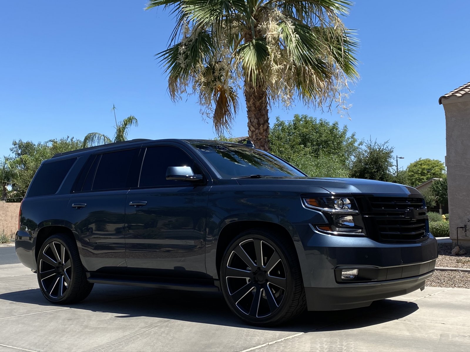

I have the same drop on my Tahoe, yours sits much lower, did you do anything more other then the nor cal drop kit?
I am actually running the Norcal 6" drop springs w/ both top and bottom spring spacers. I also kept the Magride shocks in. Because of all of that the rear prob sits more like a 4.5" drop.
