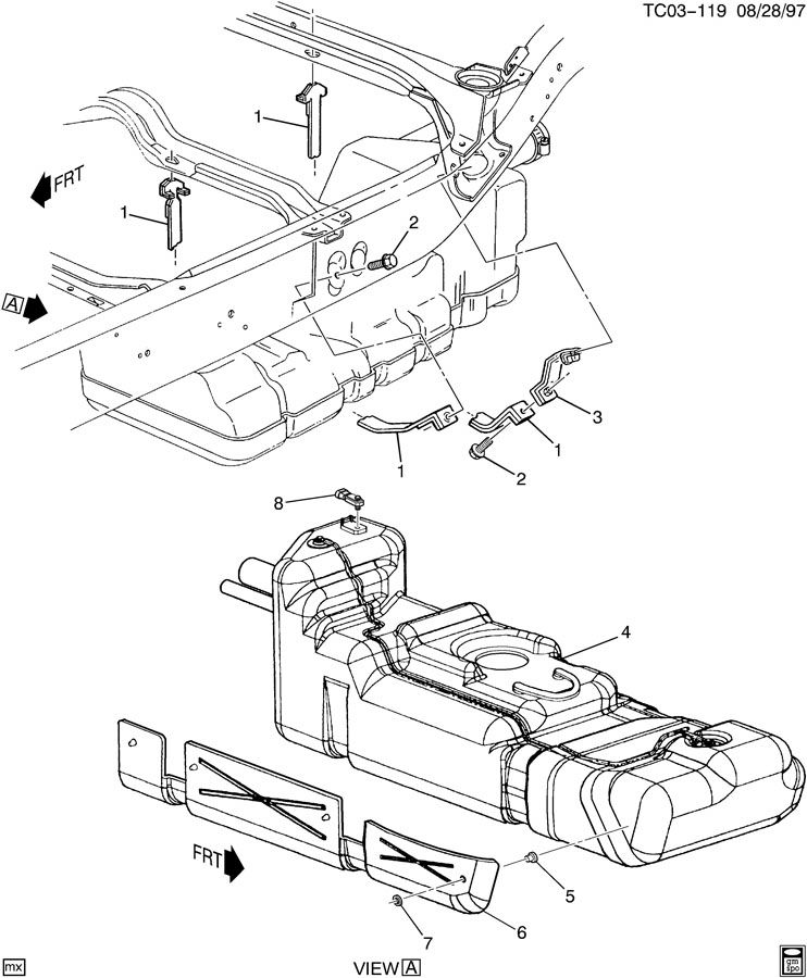

When replacing my fuel lines for my 98 Tahoe 5.7L 4wd/4dr the shield on the side of my gas tank just fell out. It was extremely rusted. What is the function of this piece of metal attached to the gas tank. It is adjacent to the drivetrain but also close to the muffler. Is this designed to absorb impact like a skid plate or is this a heat shield? Could I go without this?

Thanks. I just can't seem to find that part. Guess its a dealer part?

are you looking for number 6?
drakon543
Feb 15, 2016
2,473
1,722
well i pulled that picture from one of the typical gm parts sites. it is discontinued and will be hard to find. 15733382 is the gm part number for it.
That is a heat shield that is required for fuel tank protection from the exhaust system only. It is not designed for any impact or skid plate related issues.

Do you know where I could purchase this heat shield for my 1999 Chevy Tahoe 5.7l - 8 cylinder - 4 wheel drive?

Thank you! Found a site that has it.

You can try calling a dealer, they can search nationwide inventory for the part number (15733382). If you’re lucky, someone may still actually have it.
