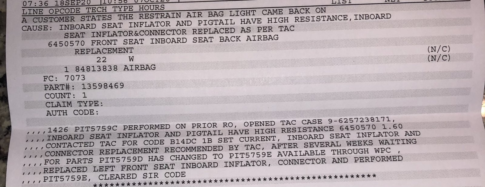

I was told mid-November for my part to arrive, but somehow it showed up yesterday ‍♀️. Service department assured me this is the correct fix. I hope they are correct as I’ve been without my Tahoe for 3 weeks and would like to actually drive it for a while :)

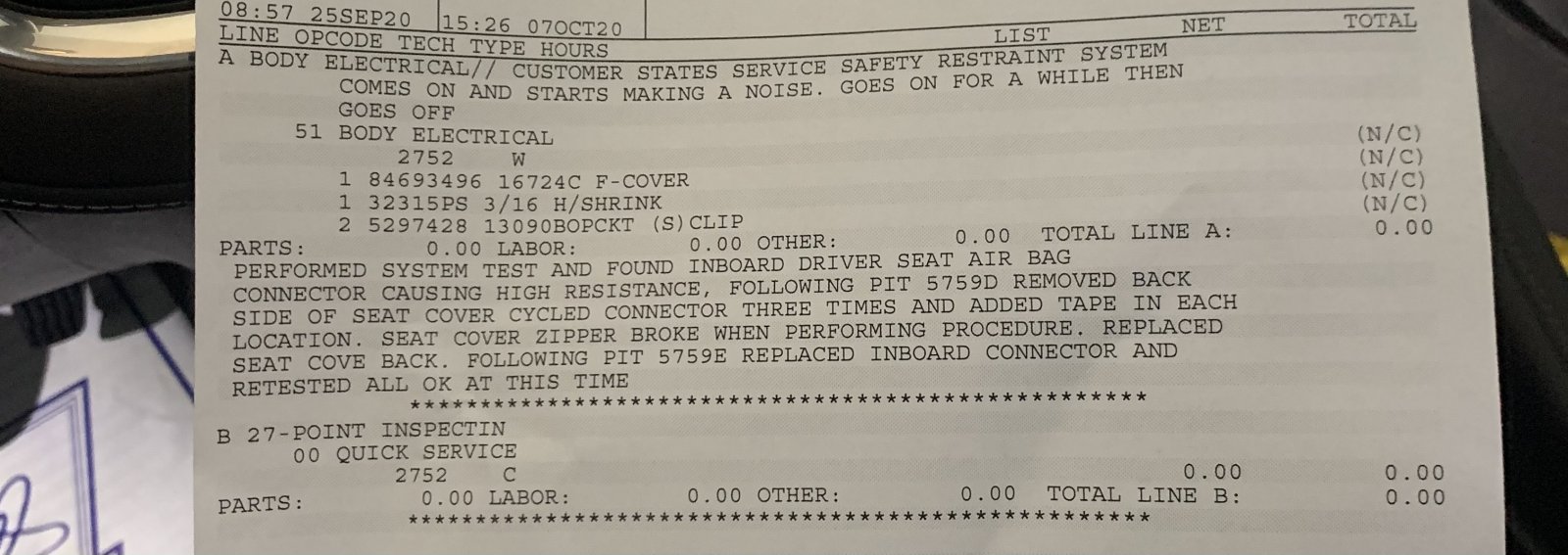

The fact that 2 of you have the same fix and document procedure numbers seems like a good thing.

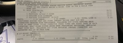

I have had my truck back for 1 week and about 500 miles. No issues. I had the same work done, but they also replaced the airbag module and the connector. My dealer also had an issue with the zipper and that set them back a few days.

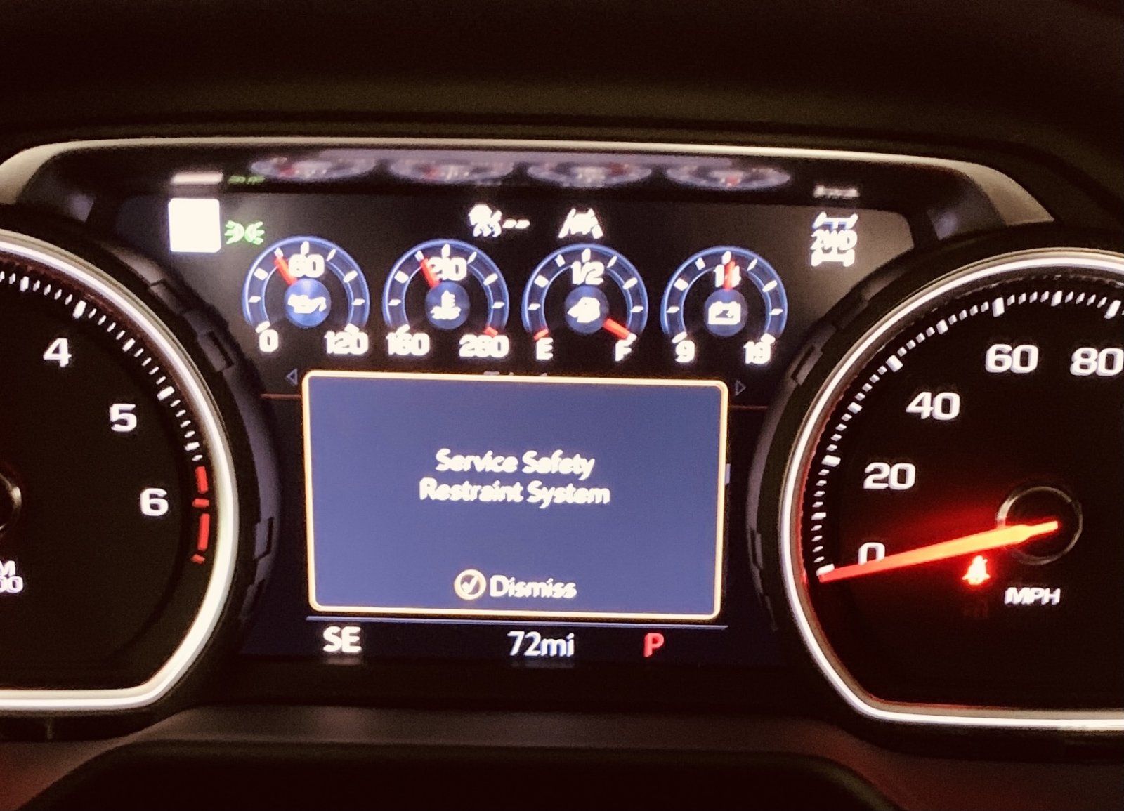

Took delivery of high country Tahoe yesterday. Half way home I got the message in picture. Dismissed it numerous time so got appointment Tuesday.

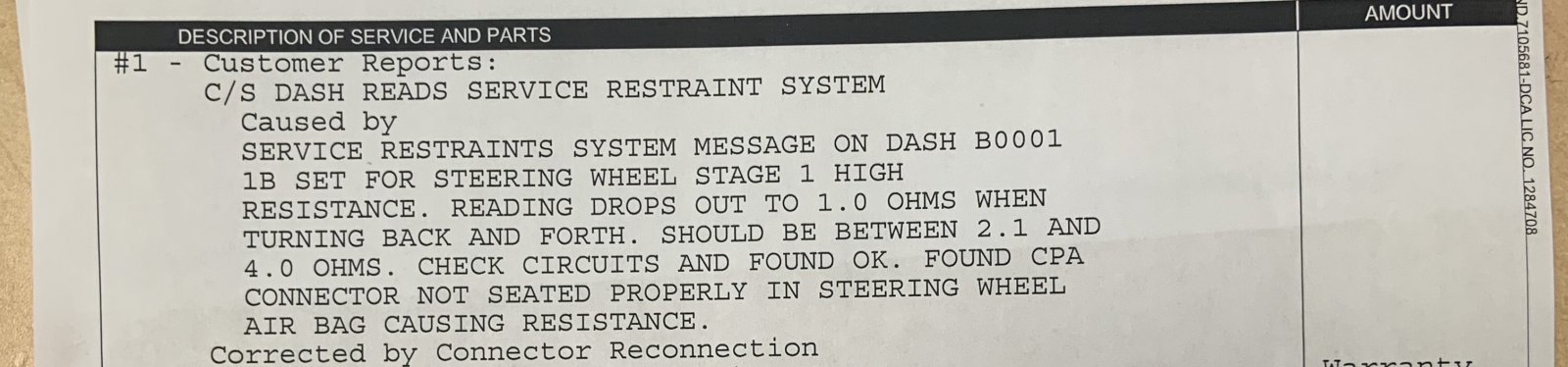

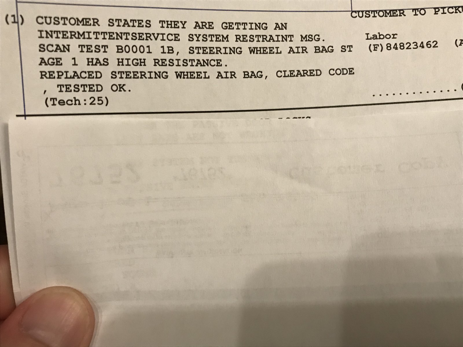

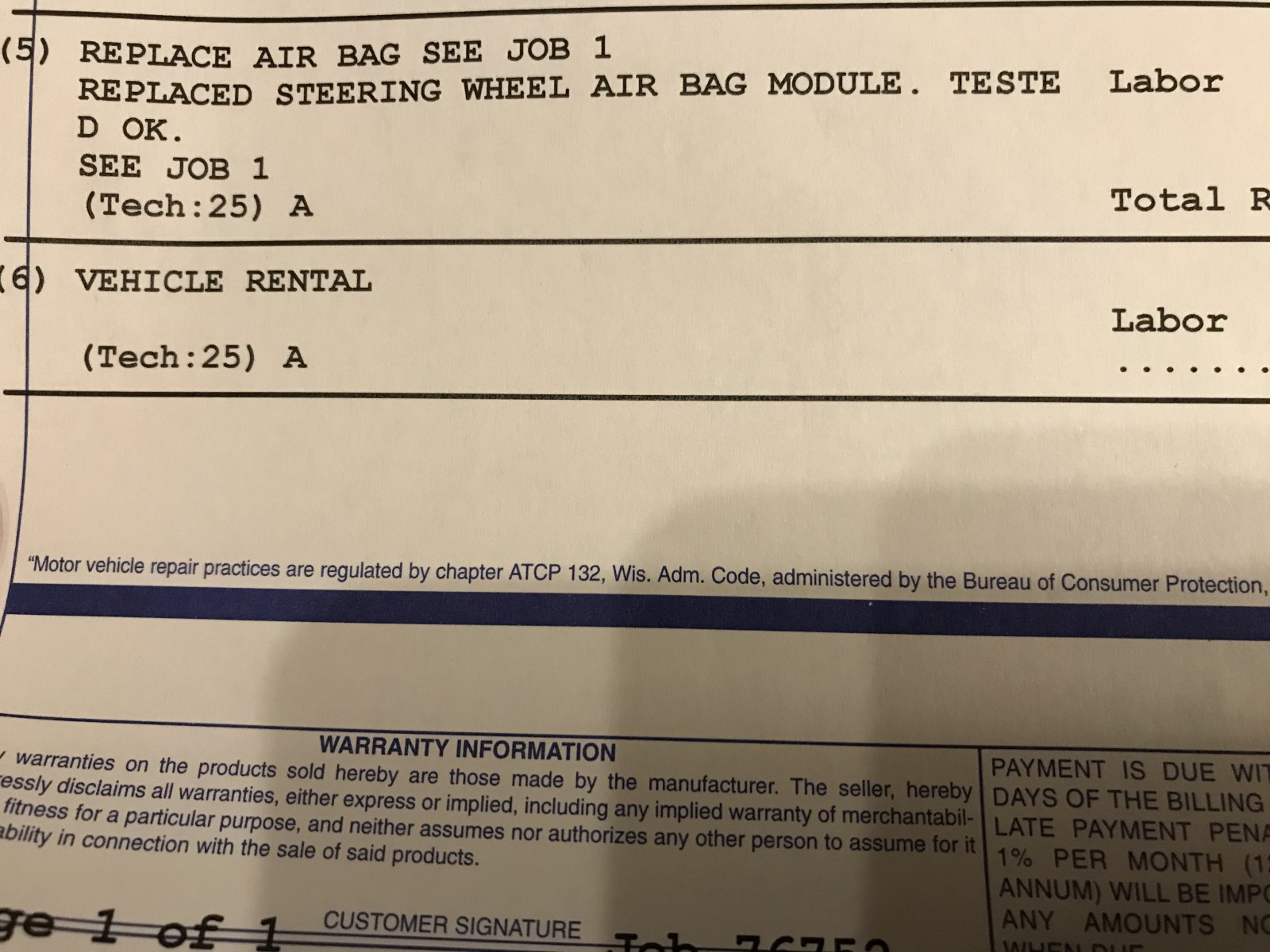

From 9/18, they reconnected a wire attached to the steering wheel airbag.
d67a76d0-8039-4afa-aed6-2f5512bcdef4-jpeg.257914
This was the fix for me if it helps. They also replaced the steering wheel air bag module as well. Has been close to a month and over a thousand miles and has not come back

Looks like 2 issues that people are chasing here the Driver seat airbag and steering wheel airbag/clock-spring. Mine was the airbag in the driver seat inboard side. The module and connector have been replaced. When they performed this work the seat cover has to be removed and it is zipped down so tight that multiple people have had the issue where the zipper is ripped off. It took 4 trips and my truck was finally in the shop for a few weeks for this, but I did have loaner suburban during that time period. It has been good for the past 3 weeks....back in for a different reason now.

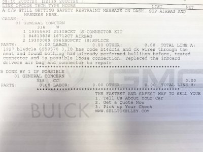

I finally got the SRS/Airbag fix performed on Tuesday! It was my third trip to the dealership for this issue. The bulletin the service statement refers to is: 1st trip-- Check module connector, disconnect/reconnect module. 2nd trip-- realign module connector, disconnect/reconnect module connector and use butyl tape. Those two "adjustments" to the SRS/Airbag module connector did not remedy the issue. Trip #3 replaced the driver's side airbag and replace the module connector. So far (knock on wood) no service SRS warnings! Let's all hope this is the final fix to this issue.
