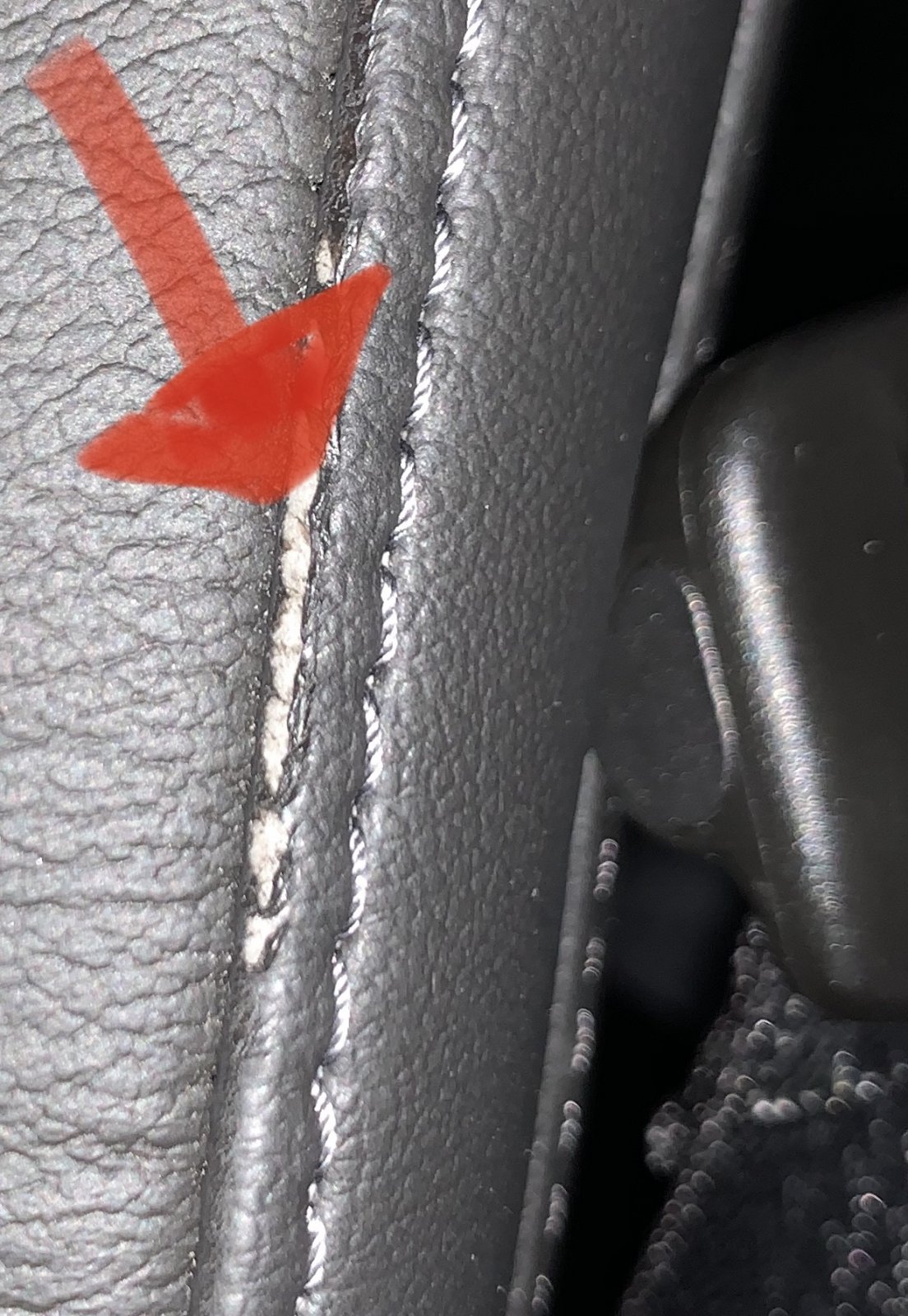

As I mentioned before I brought in for service my 2021 Tahoe Z71 since I needed to have the warning message resolved. As discussed by many users it looks like, in many cases, Chevrolet technicians at the dealer had to reposition a wire related to the airbag system.
Today I paid a closer look to the driver seat and I kind of found a “patched area” that has been probably cut in order to remove the leather cover of the seat. I took a picture of the “glued area” of the seat and I would like to check with you guys if you can notice something funny too in that area after you brought your Tahoe in for solving this specific problem that we are discussing here. Thank you all for your attention on the matter.
The picture I’m posting it’s very small due to the forum file size limitations, but if you look at your seat (driver seat) you should focus approximately to the seam at the height of the seatbelt. If I touch the area it’s harder to the tact like hardened glue.

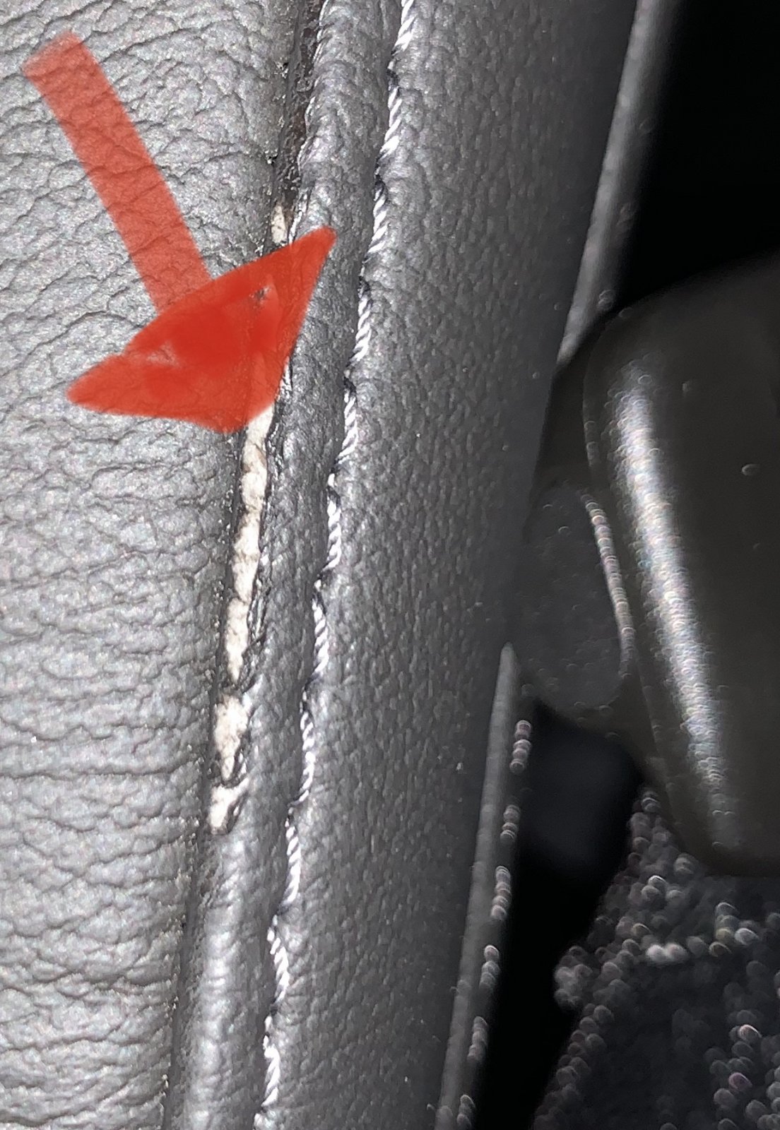

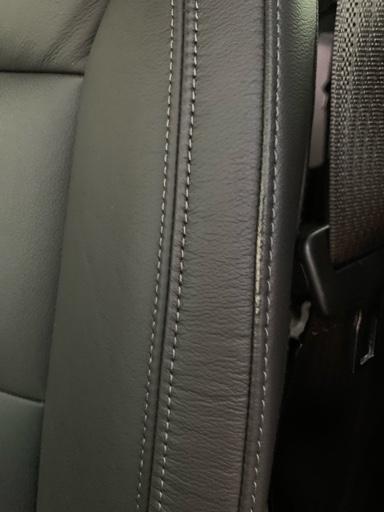

I just looked at our 2021 loaner and it does not have any issues with the stitching on the seat.
2021 Tahoe Z71 5.3L 4WD Graywood Metallic
Yea i would say that is no doubt from someone patching their f-up. Especially if its been in for work already.
Do you have a photo from further away to get an idea where on the seat it is? I have been lucky and had mine repaired (knock on wood) with replacement of steering wheel airbag and module. (See earlier posts). Thanks

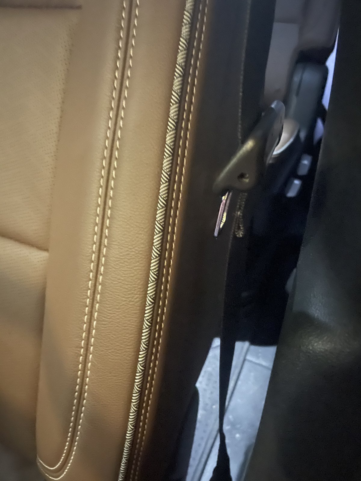

That appears to be outboard not inboard where the airbag issue is occurring. I would bring that up as a manufacturing defect and have them order you a whole new seat cover.

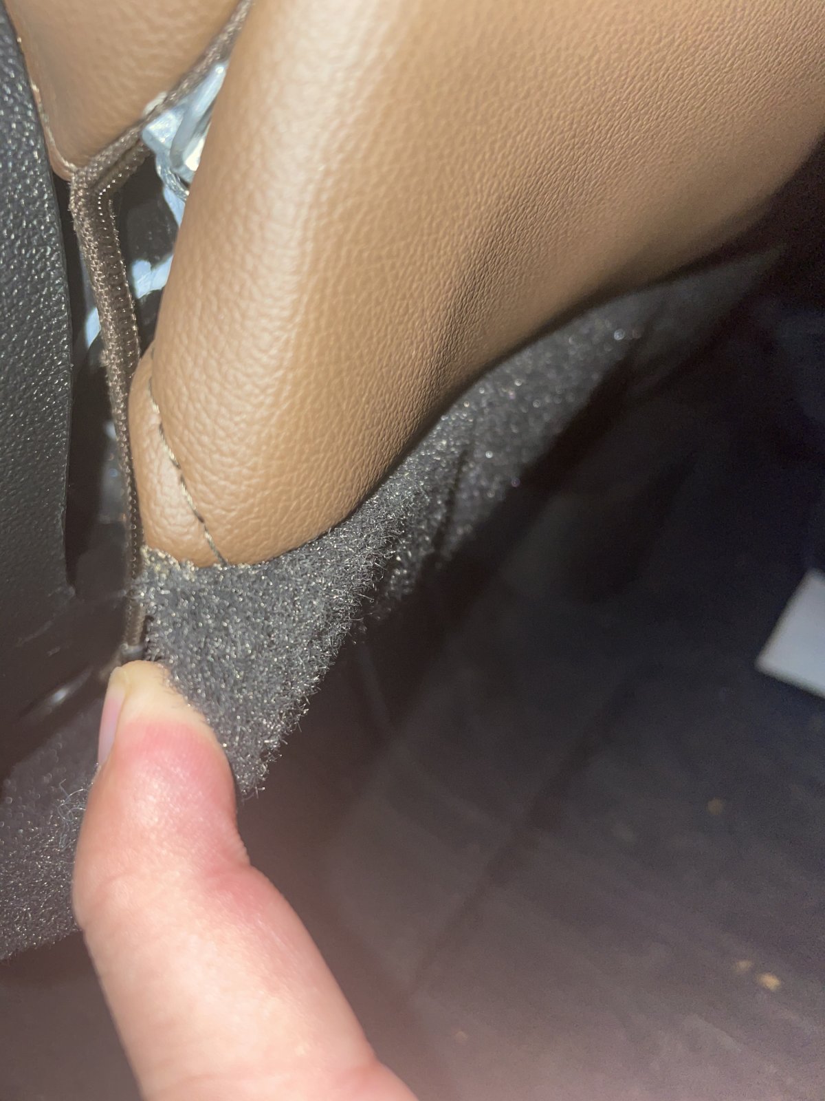

Mine was fixed and the issue that they are having is with the zipper on the back of the seat cover. The zipper starts in the footwell area. It is so tight that they have been ripping it when attempting to install the new module and connector.

Here is a picture of mine. No rip or stitching issues on the outboard side of the seat. However, I now have some serious questions about the broken zipper that was “fixed”.

When you all talk about the zipper on the seat cover, is this the seat back cover or the seat bottom cover they have to remove?
