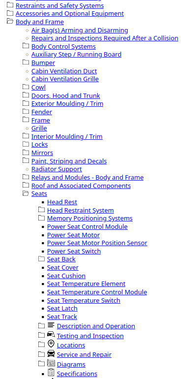

You may find some useful info on the Charm.LI site.
Open that link and confirm or change your vehicle info by using the links at the top of the browser page. If you change the vehicle, open up the similar page specific to yours.
Scroll down to the "Body and Frame" link and click that to expand the selections. Then expand the "Seats" link, and the "Seat Temperature..." link of your choice.
