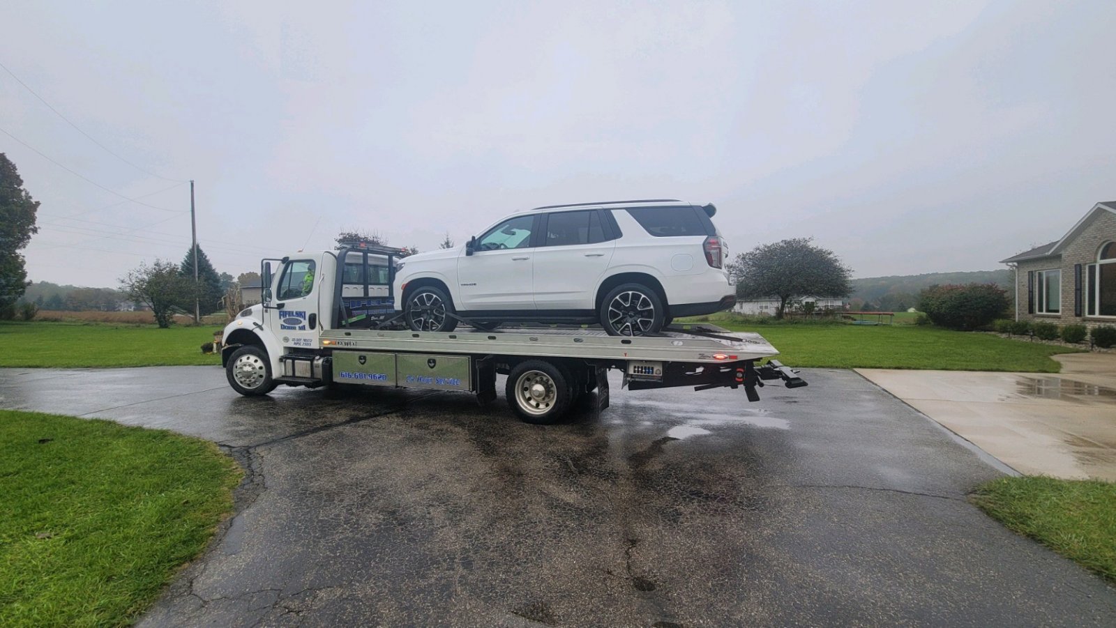

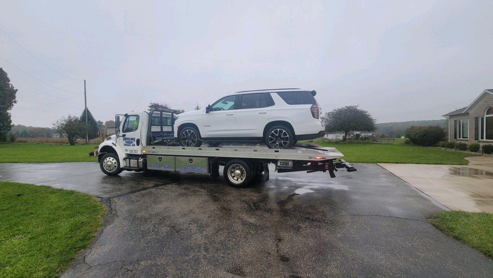

Sad day... Didn't even get to drive her for 5 days without the lifter going...
