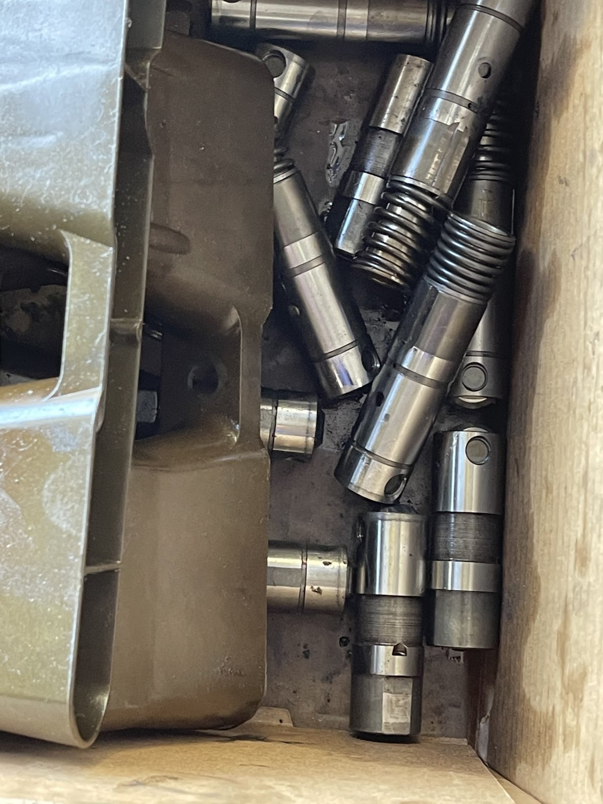

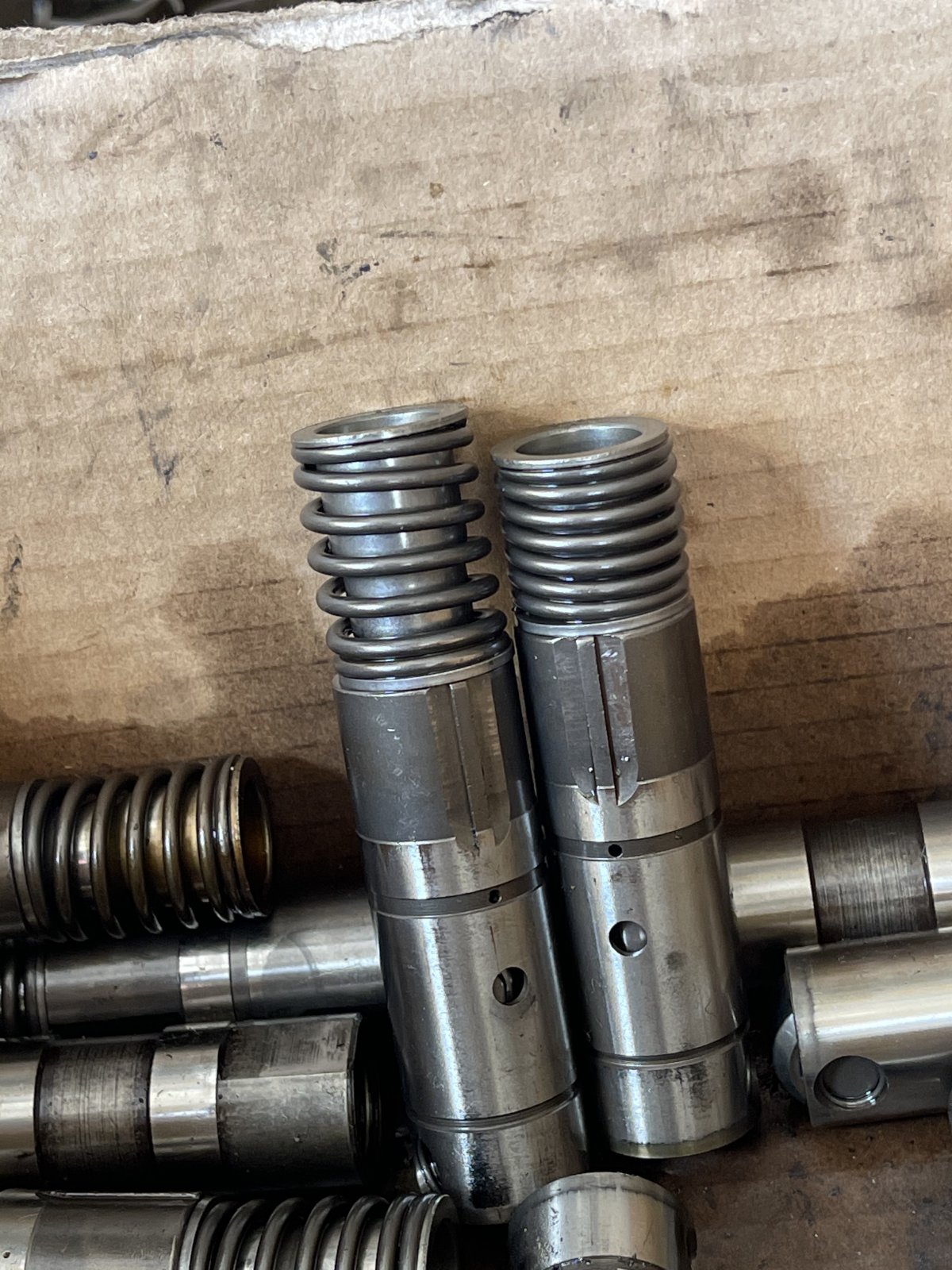

Mine was used.. I signed as is my 2015 LTZ had the lifter stick in less than a week . The dealer HADTo Know. It was their Cadillac dealerships employee who owned it.
no more V8 V4 DOD for me and had great guys at a speed shop swap cam and 16 LS7 lifters. Texas speed delete kit AND a Dyno Run Computer Tune…. $ 3000. It runs and shifts great and saw 24.9 at 66 on a trip

It’s 6.2 also. A coworker of mine just had this happen to him. 2021 Denali with 8,300 miles. Left him on the side of the highway. Had it towed to the dealer. They told him that there is a TSB for this and if the mileage is less than 8,000 miles then they replace all lifters. If over 8,000 miles, then they only replace the side that was affected. He was 300 miles over and they only replaced his one side of lifters. They did, however, get his truck back to him in 2 days.
He was told they have a known lifter defect that was a machining issue for a batch of lifters that left a burr or rough surface finish and if it affects your truck, it will happen right away. I guess that’s why they choose 8,000 miles for the cutoff?
As soon as he got the truck back, I helped him install a PULSAR LT unit on it. Hopefully that will help in the future.
I talked with my longtime service advisor at the dealership I have been using for a very long time for my 07 Yukon.
He told me when they find a bad lifter(s) in one of these trucks, they replace them all. That policy has grown out of their experience that after the first failures where they would replace less than all 16, an uncomfortably large number we’re having repeat claims. The first failures nominally happened in the 8K range and the ones that came back for a repeat almost always failed before the 20K range. He maintains one customers fleet which experienced an outrageous failure rate, like half of the customers trucks had failed lifters. I believe GM is on board with their “replace them all” policy. He told me if I had a failed lifter in my ‘21 Sierra 6.2L, they would replace them all.
He also recommended I change the oil/filter once at 1500 miles, a second time at 3000 and then every 5000 thereafter. He seemed to feel the ones with more frequent oil service intervals appeared to fail less frequently. I don’t know if he has statistical data to back up the theory or it is just anecdotal impressions. This guy has always been spot on for me. My truck was built a month ago, so I have my fingers crossed, but will change my oil/filter at 1500, 3000 and 5K thereafter. A tank of gas costs almost twice what an oil/filter change costs me, seems like cheap insurance.

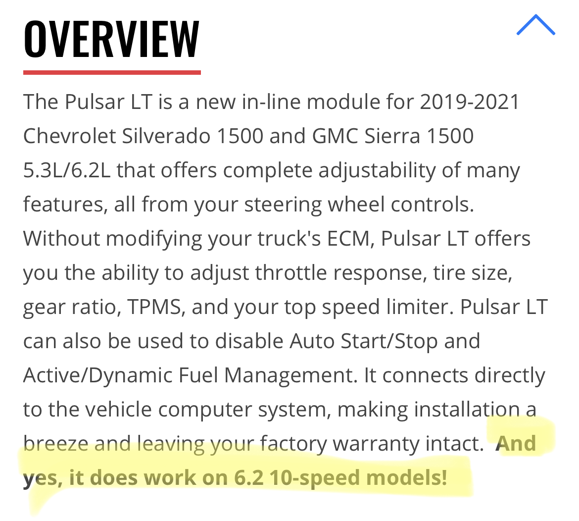

Also curious on the Pulsar LT, my understanding per their website is the pulsar doesn’t work on the 10 speed transmission.

FYI, I reached out to Range and they said that statement applied to the Sierra/Silverado trucks only, the LT wouldn’t work (yet) on the Tahoe/Yukon/Esky but they are working on it.
If anyone has successfully used the Pulsar LT on the 21+ Tahoe/Yukon/Esky, post your experience!

I also reached out to Range and the PULSAR LT "does not" work for the SUVs.
Question: "Does the Pulsar LT work with 2021+ Yukon/Tahoe?"
Response:
"No, that is for the trucks only. The SUV’s will need a handheld tuner if available."
