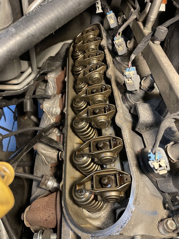

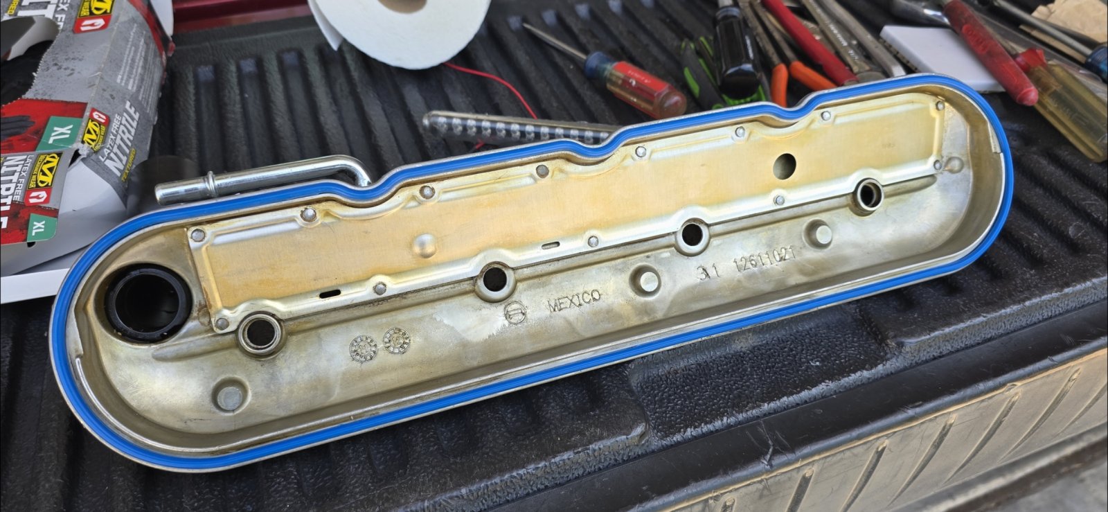

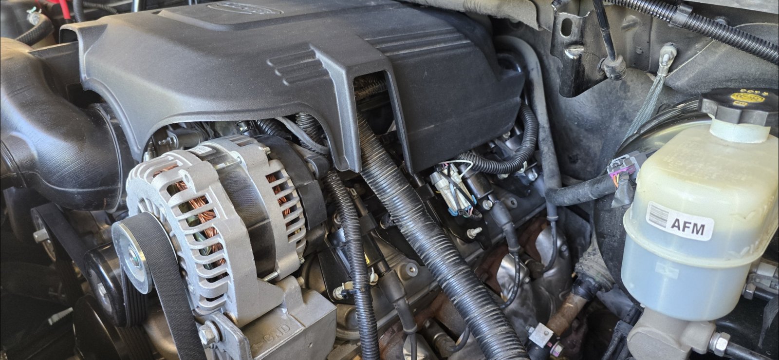

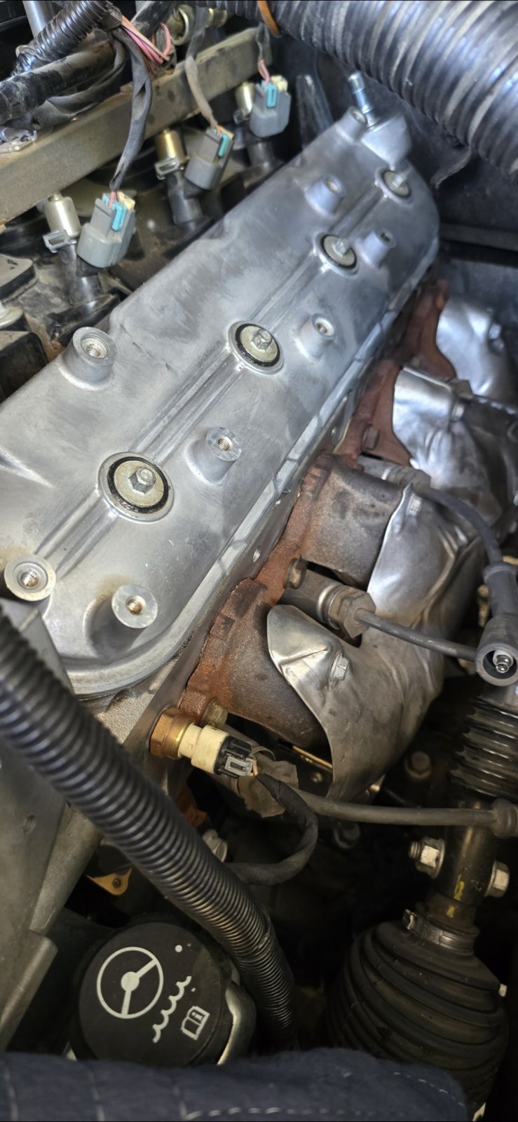

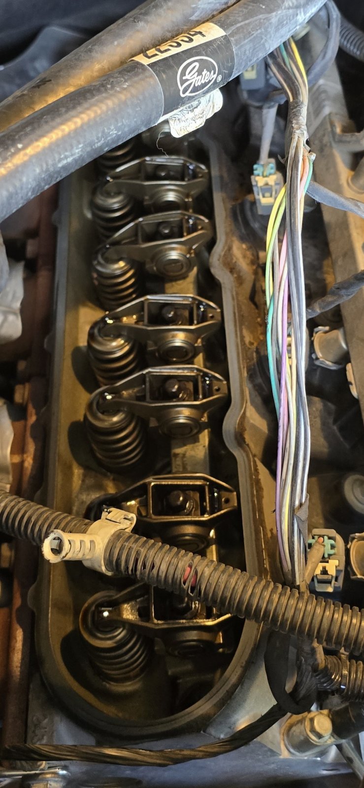

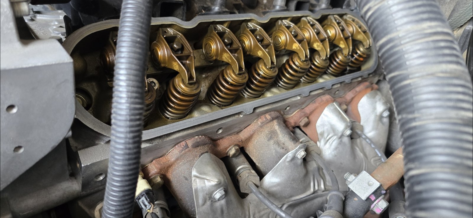

FWIW - Changed the valve cover gaskets this past weekend. Driver's side was starting to leak at the rear of the head. Unbelievable how clean the underside of the valve covers and the exposed valvetrain were for 146K miles. Regular Mobil-1 oil changes certainly do prevent sludge or gum buildup. Also took the time to replace the dry-rotted/missing corrugated tubing on the wire harnesses. Looks much better with the wires again protected and the valve covers, coils & brackets cleaned up.
