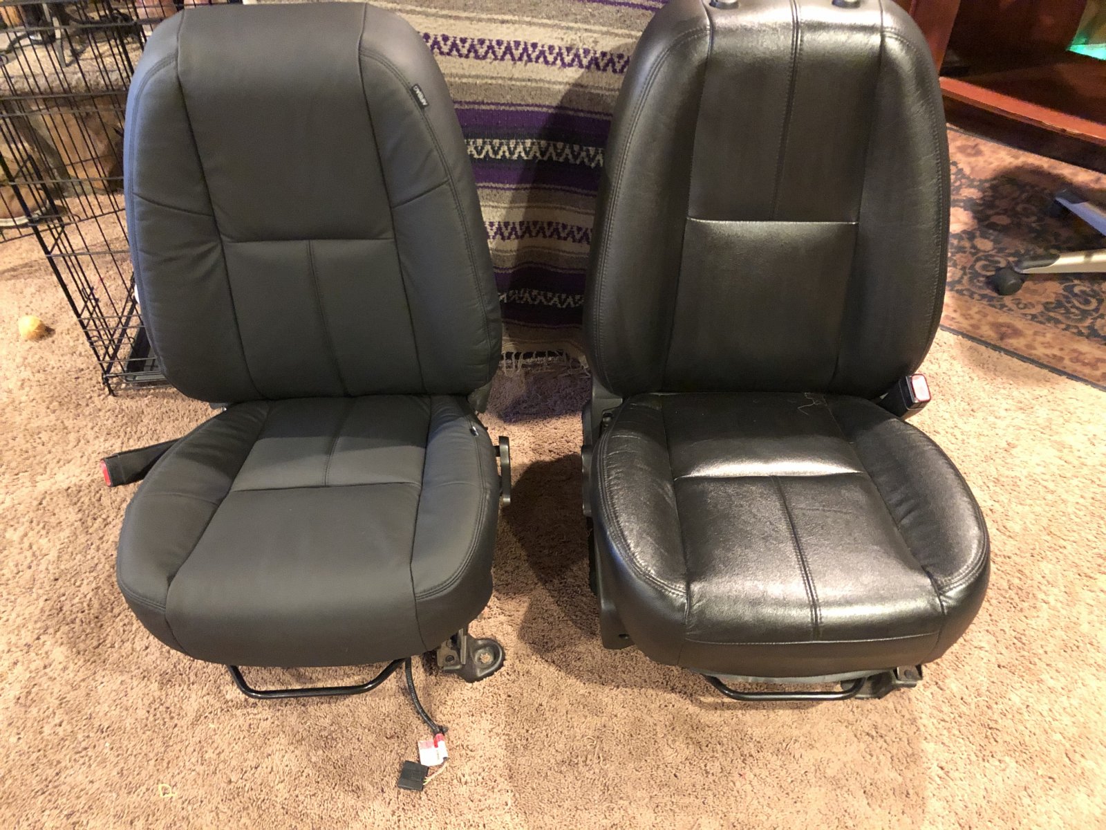

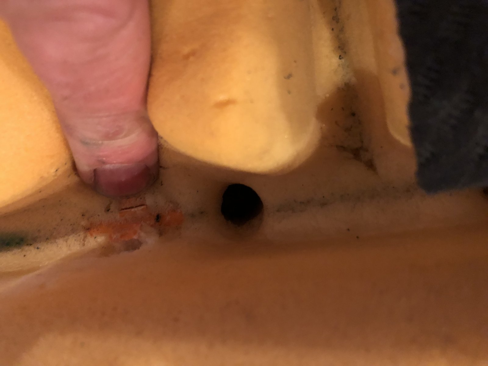

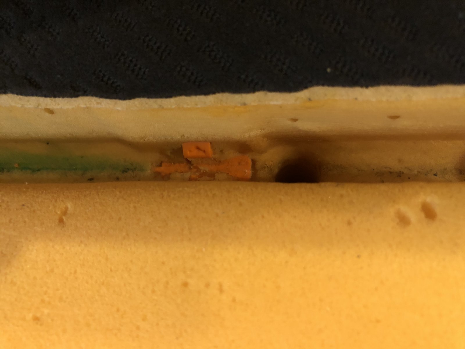

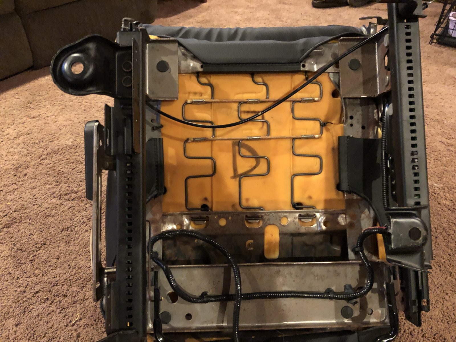

And I spent a couple hours on the driver seat. The design that GM came up with to replace the Velcro in the grooves sucks, and I’m pretty sure these seats have been reupholstered once before. At least half those clips broke and I’m thinking I need a new driver bottom (at least) foam. I don’t see any way to repair those clips and the horizontal seam looks bad since it won’t stay down in the groove. I think I’ll look online to see if there’s a way to fix those or else it’s more $$.

Post some pics of what broke.
52,954

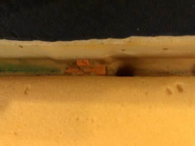

I just got a message back from the seller on eBay and was coming back on to update when I saw your post. He said the workaround is to use long zip ties through the foam and attach to the springs. Seems like a good idea as opposed to $100 for each piece of new foam. It’s the little plastic snap clips that are in the creases of the foam, where the seams of the seat pull into the grooves. Used to be hog rings, then they went to Velcro strips, now there’s just a few plastic clips. Look deep in the crack lmao. Those little orange things that snap onto the plastic channels sewed to the covers. Push on one side and they open up to release. Or break.

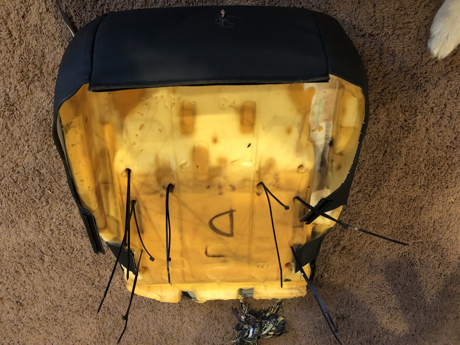

The zip tie will pass through the flap that extends down into the pocket, the flap has a plastic edge that’s supposed to push into the clips so it’s nowhere near the leather. I will cut a small slit behind part of that flap behind the plastic so it’s strong and slide the zip tie through. Then I’ll pull it together under the springs, that’s where the head of the zip tie will be. I’ll get pictures tonight.

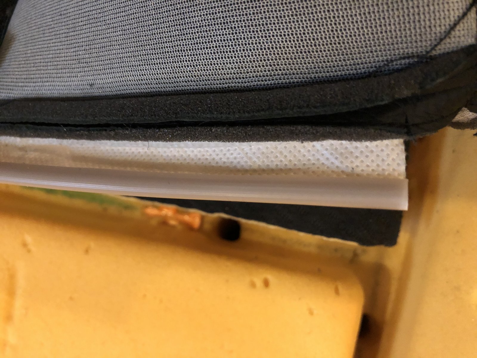

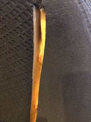

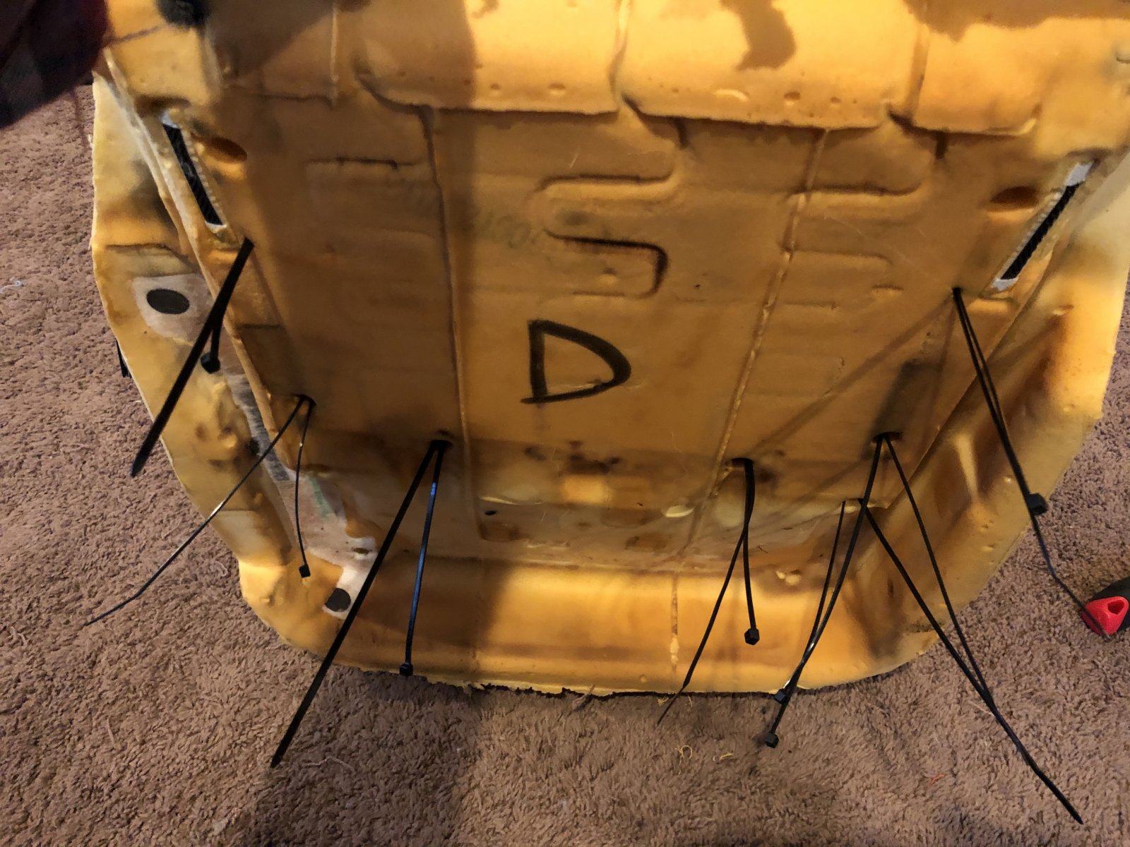

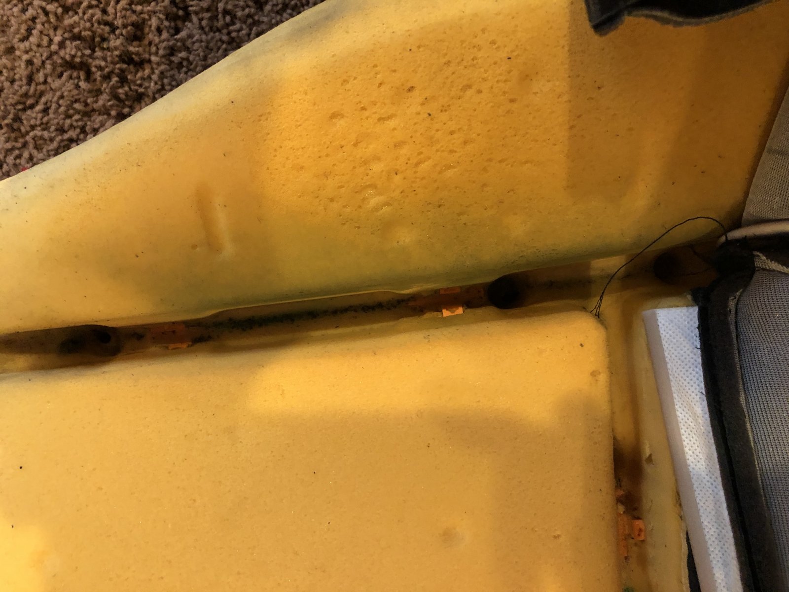

So there’s these plastic clips that you’re supposed to snap the plastic channels into that are attached to flaps at the seams in the bottoms and backs of the covers. They’re there to pull the seams down into the grooves in the foam so the seat has contours. But they break easily. The bottom ds had 7 out of 10 broken. There’s 4 on each forward-to-back seam and 2 on the one that goes side-to-side.
E8C96AE6-2E42-4951-A53B-E4B45313501B.jpeg 8822EDF2-A30F-45D5-B64B-7F88FBA5FFC8.jpeg A4301FAC-0043-45D4-B8A9-4DEE75EBC834.jpeg 7953117E-9AA7-4FD7-AEEE-FCB9D6D4E8FF.jpeg
52,954

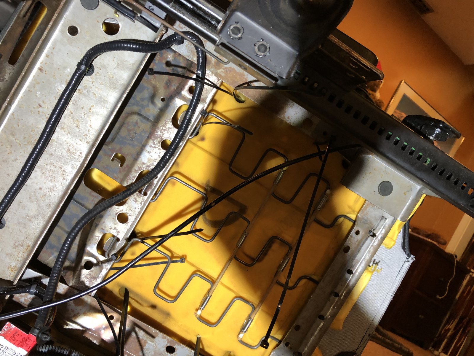

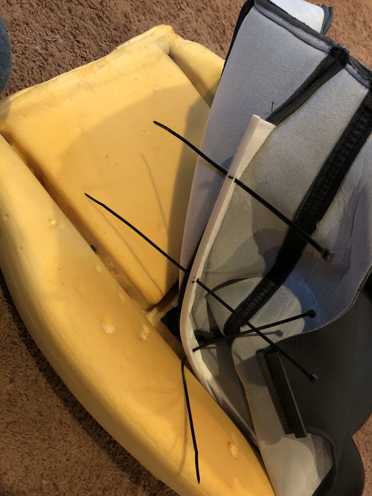

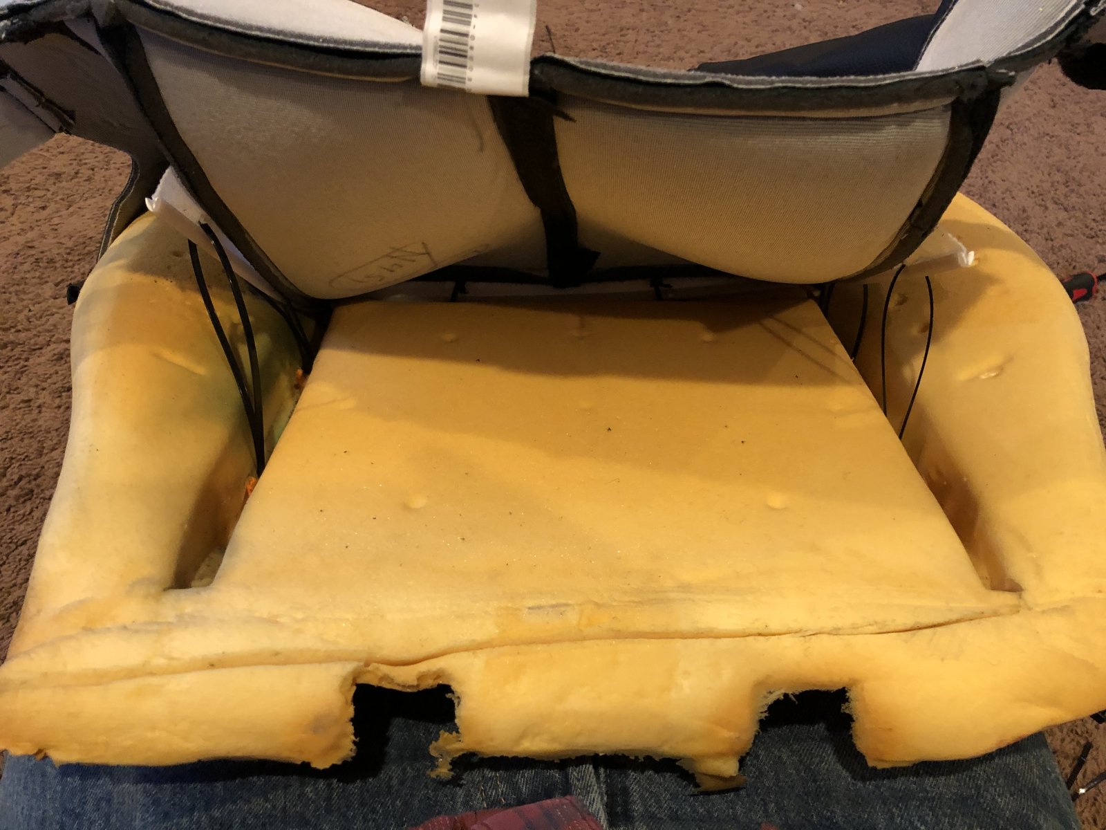

The solution was to put slits in the flaps behind the plastic channels and loop tie straps through and then when the foam and cover are reinstalled on the frame you can loop those around the springs and tighten them which pulls the sarms down into the grooves of the foam. It makes a hard nod even harder since normally those seams are already done before you attach the foam and cover to the frame, plus you need really long tie straps. I connected 2 together but then I would have run out of room when pulling them tight since the place where they connect won’t pull through the slit so I had to get the seat almost together and then cut one zip tie off and grab the loose ends and zip them together. Next one I’m using loops of wire.
03DEBA0D-083B-4659-9122-A7F460349B0A.jpeg 809BA529-F7A2-4940-9CD3-3EFD157D3CF7.jpeg 6670E07D-5AB5-4F12-87A3-9DC99C0A5A27.jpeg 98035B58-8F70-4F7F-9852-CD9F2D27DBCB.jpeg 2E82480F-BD90-4D41-881A-92A6557B12B5.jpeg
52,954

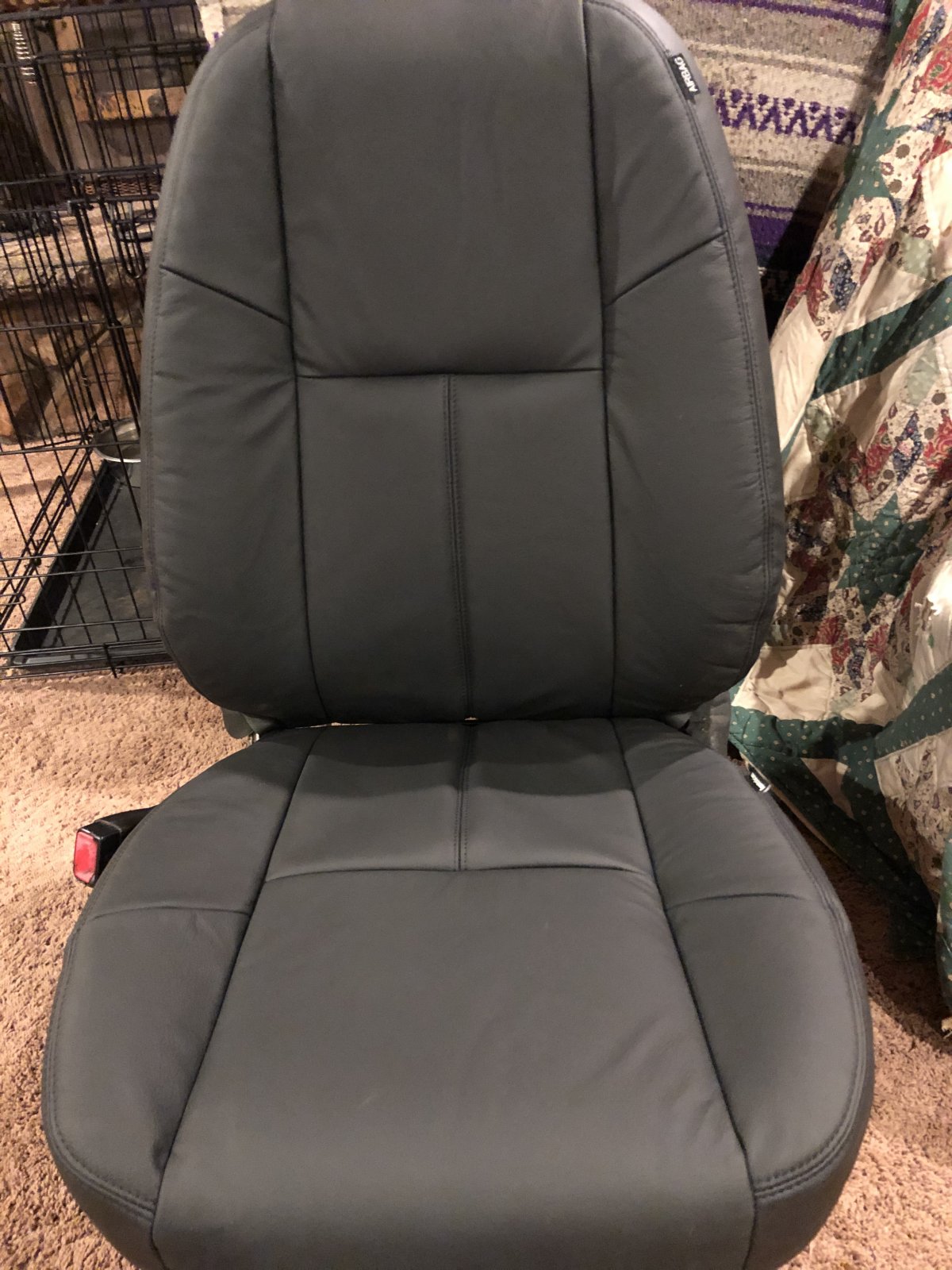

Anyway it worked but I lost one of them as it slipped from my grasp. I’ll probably pull the cover one more time. There’s a loose spot on the right forward area where that one came out. Sucks. Stupid zip ties. Stupid clips. Bad idea GM. Velcro worked better.

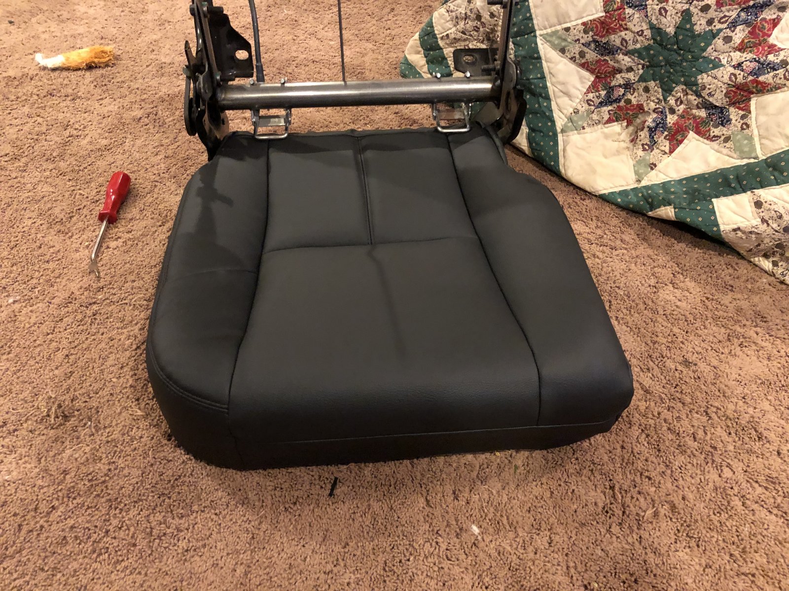

I did the passenger rear bottom. These have Velcro instead of the stupid plastic clips. And yes according to the included video, you do pull the foam and cover off the frame like I thought. The cover slips over the foam like a ( super friggin tight) pillowcase, then the whole thing slips over the frame. There’s a zipper and a couple other snap together clips. I steamed the hell out of this one, it came out good.
