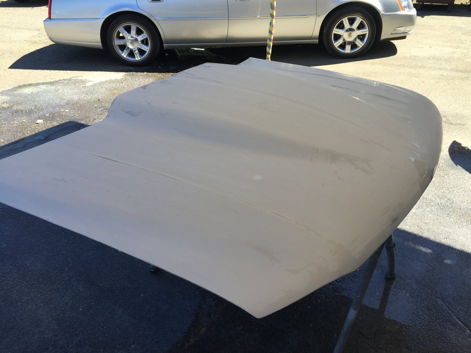

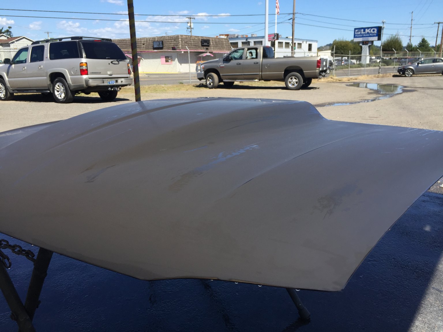

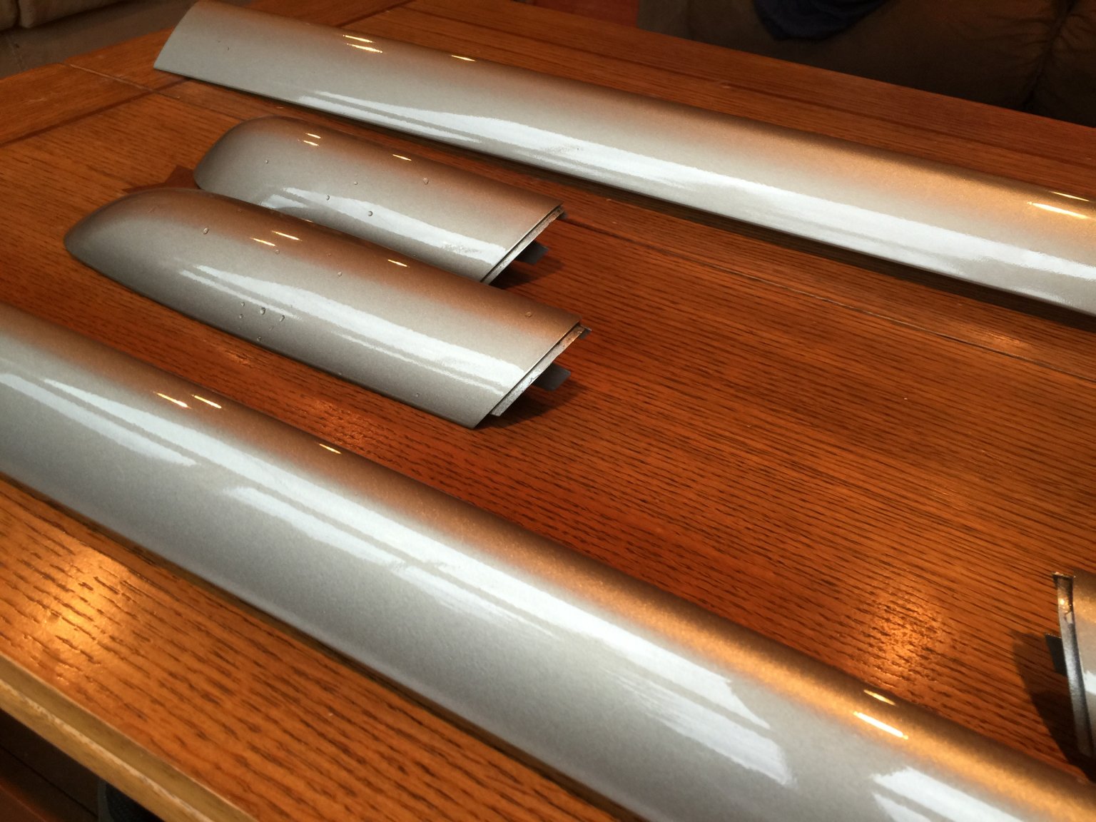

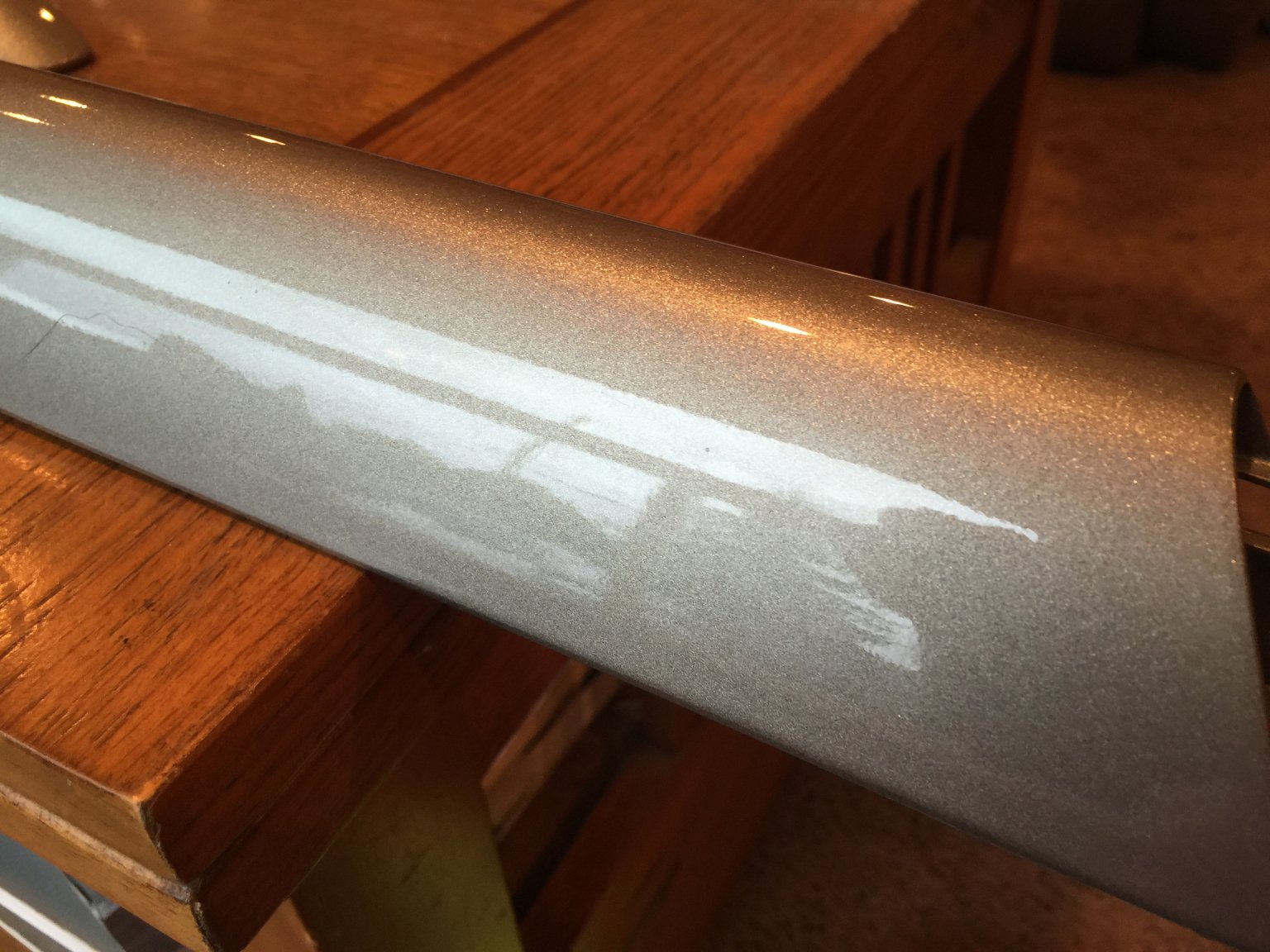

I stopped by the body shop today to check on progress. The hood has all body work done and is primed and the roof rack was sanded and in the process of being primed so I didn't get to see it but he assured me it was going to work; he said they just started with 80 grit and sanded the shit out of it. He said don't worry. But since it's going to be around 100 degrees here for the rest of the week and he's running out of time, we'll have to wait until early next week to drop the truck off and finish; he needs it for 2 days so I'm hoping it will be Tues-Wed and be done Wed night.

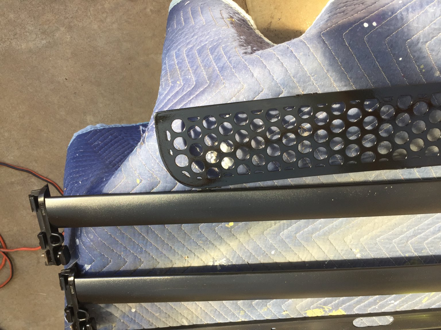

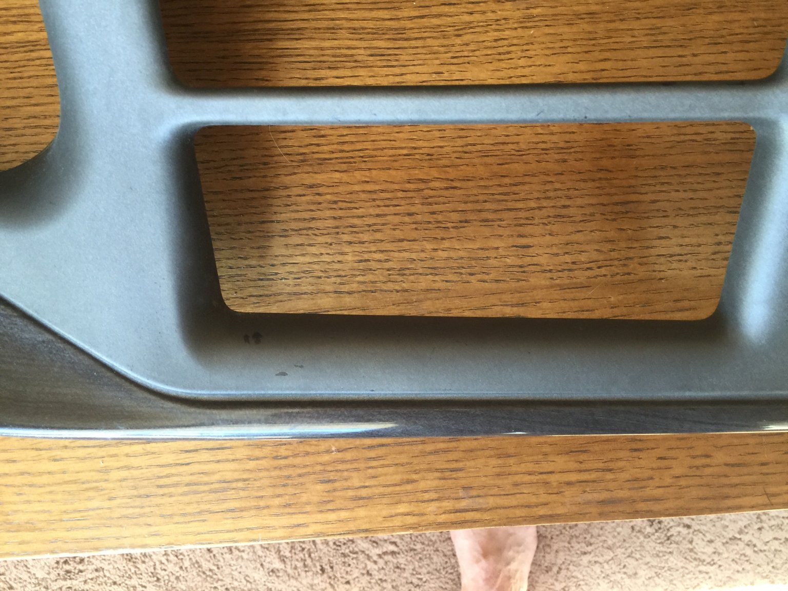

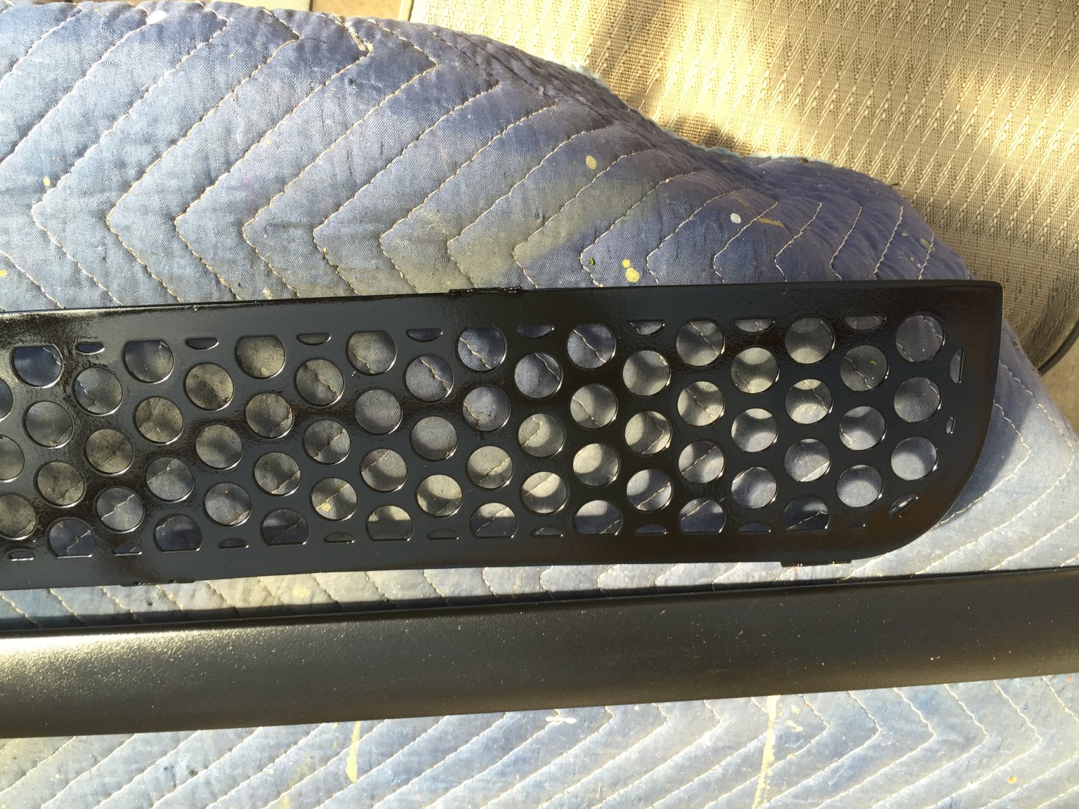

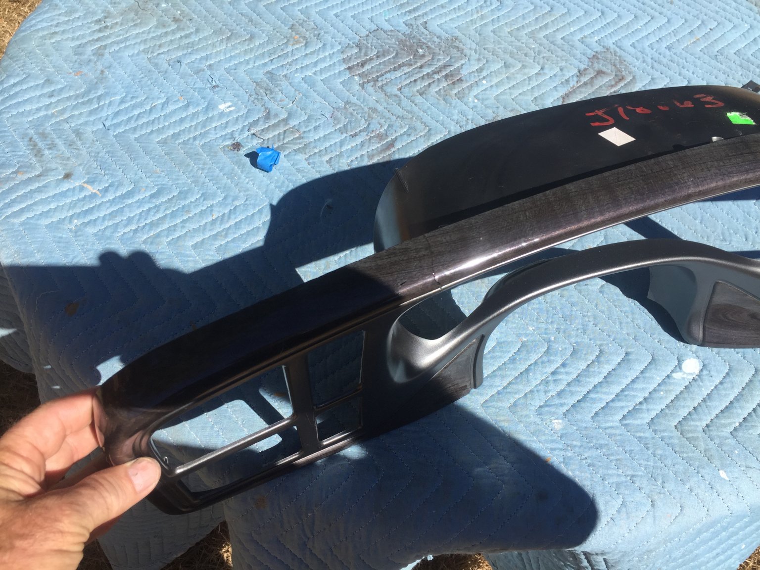

Today UPS delivered a 2005 Yukon Denali wood grain dash bezel I bought off Ebay. This will be the second one I've bought; the first one I bought when I did my DD mod for my stereo had 2 cracks through the wood grain part at the top and every time I pulled it, the cracks got worse. The rest of my interior is almost flawless and those cracks bothered me. I got this one for $117 shipped; all the others I've seen when they became available were around $200. Now I have to strip the painted part like I did on the other dash and console parts and spray with Dupli-Color Dark Shadow Gray. Yesterday I repainted my DDU lower grill insert in gloss black and a few coats of clear. I also painted the black parts of my Esky roof rack so it will be ready for installation when I get the rest from the painter.
52,954

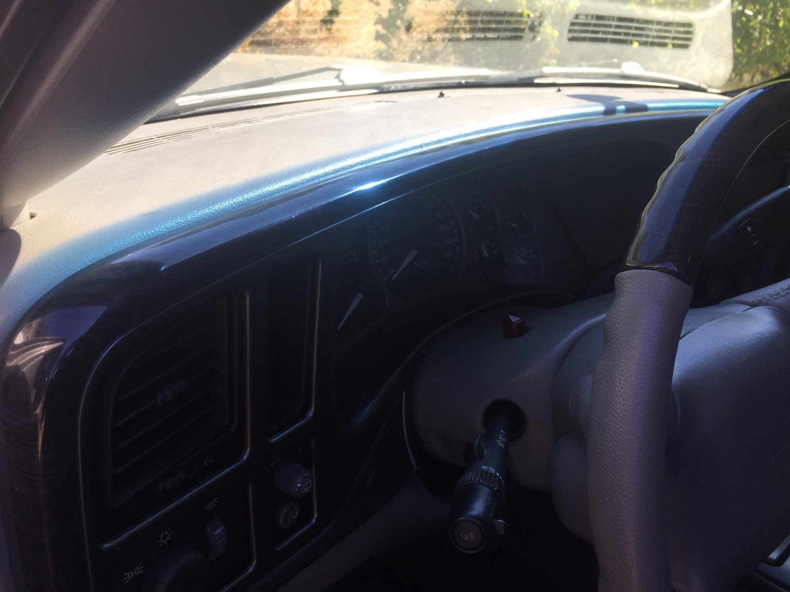

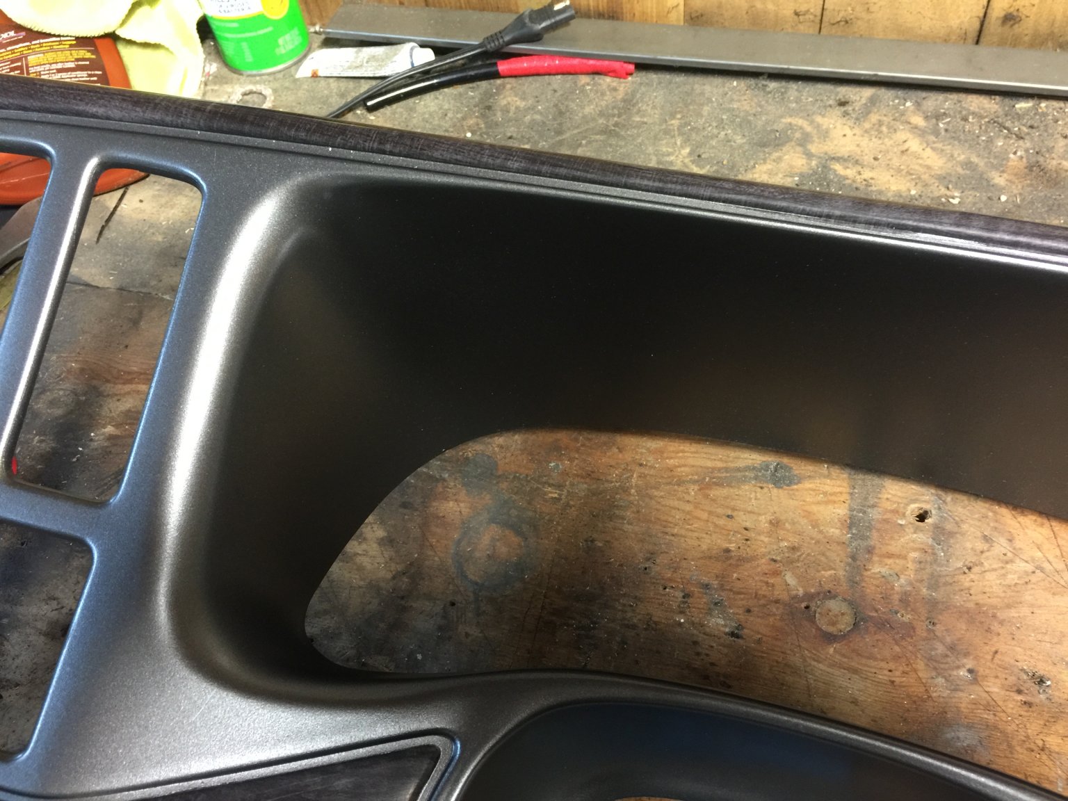

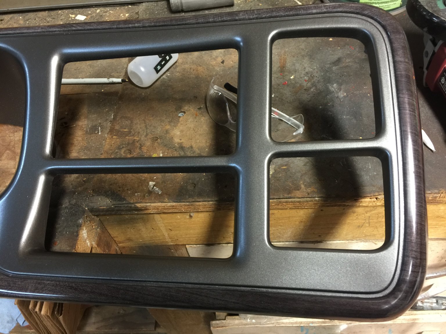

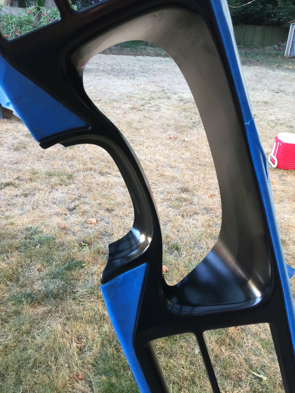

Stripped the old paint off with Denatured alcohol and a fine Scotchbrite quick and easy. That makes the old paint literally dissolve while not affecting the wood grain. Painted and ready to install. I think it came out good.
52,954
Taping must've been a pita! But looks great.
Actually not bad, I just taped over the lines then, pushed it down into the groove a bit, and used a single edge razor blade following the edge at the bottom of the groove. Total time to strip and paint was 1 1/2 hours.
52,954

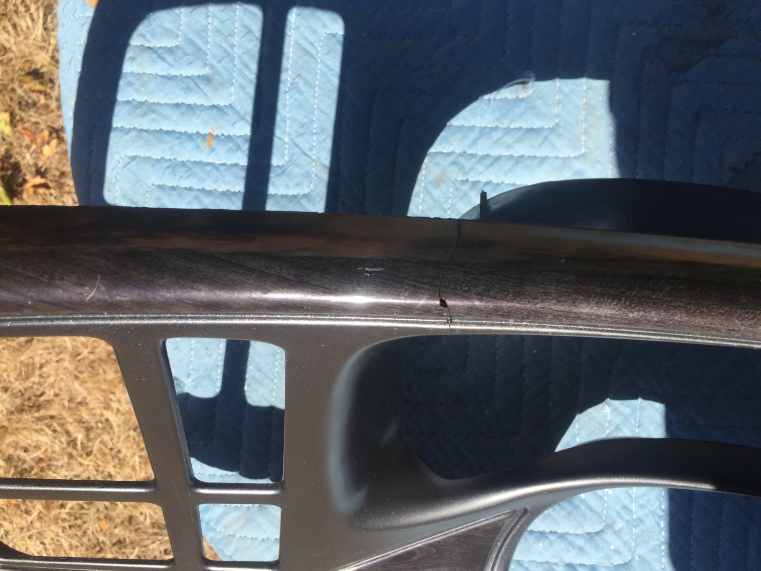

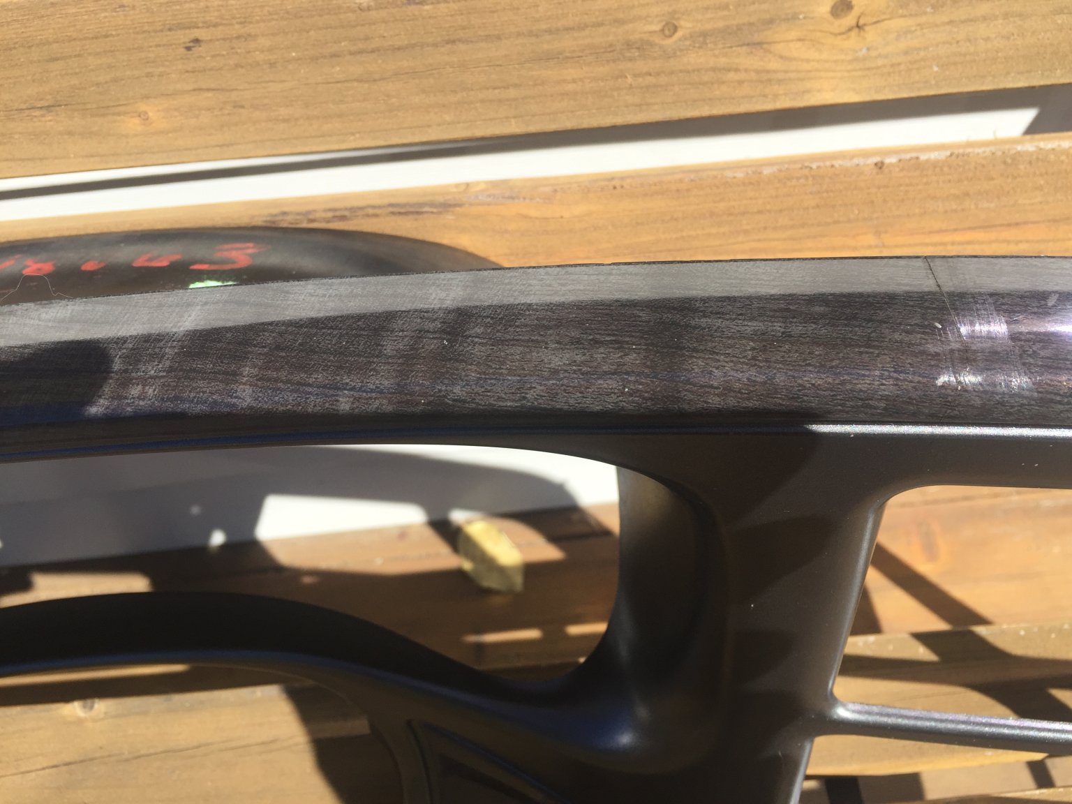

I guess I'm a bit neurotic like that. One crack was literally right in front of my face though and if there's something obvious that I see constantly, I can't leave it. Pretty much my entire truck looks like new, especially the interior, with the exception of what I'm having painted next week. And the headliner. I will redo the headliner someday...anyway here's some shots of the cracks and how the new one looks installed. It makes me feel better to have that taken care of.

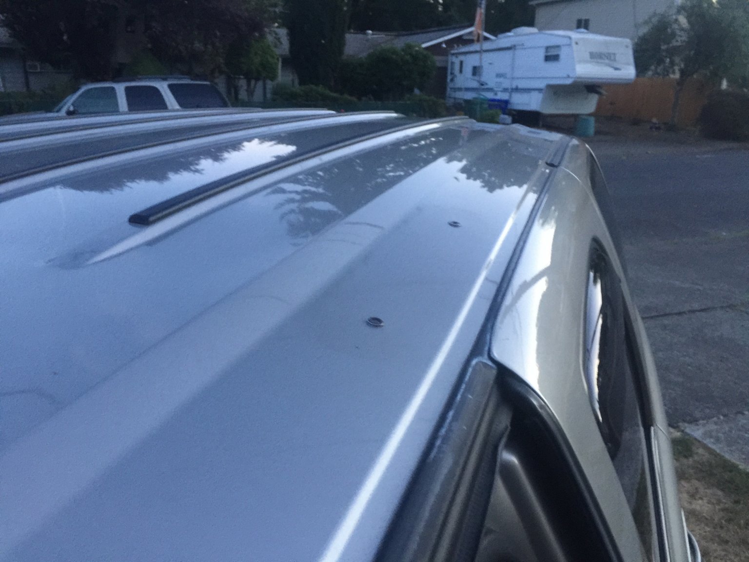

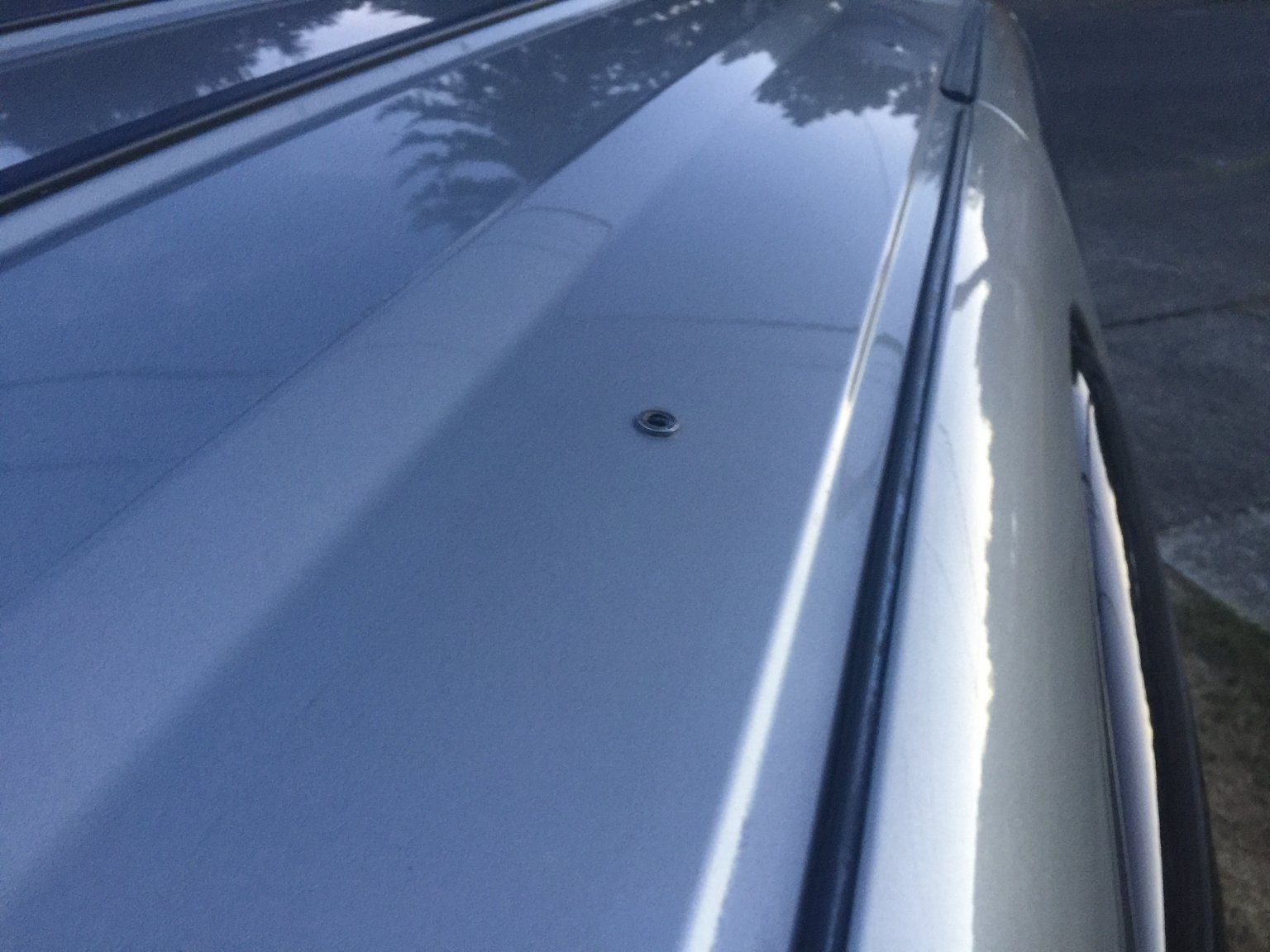

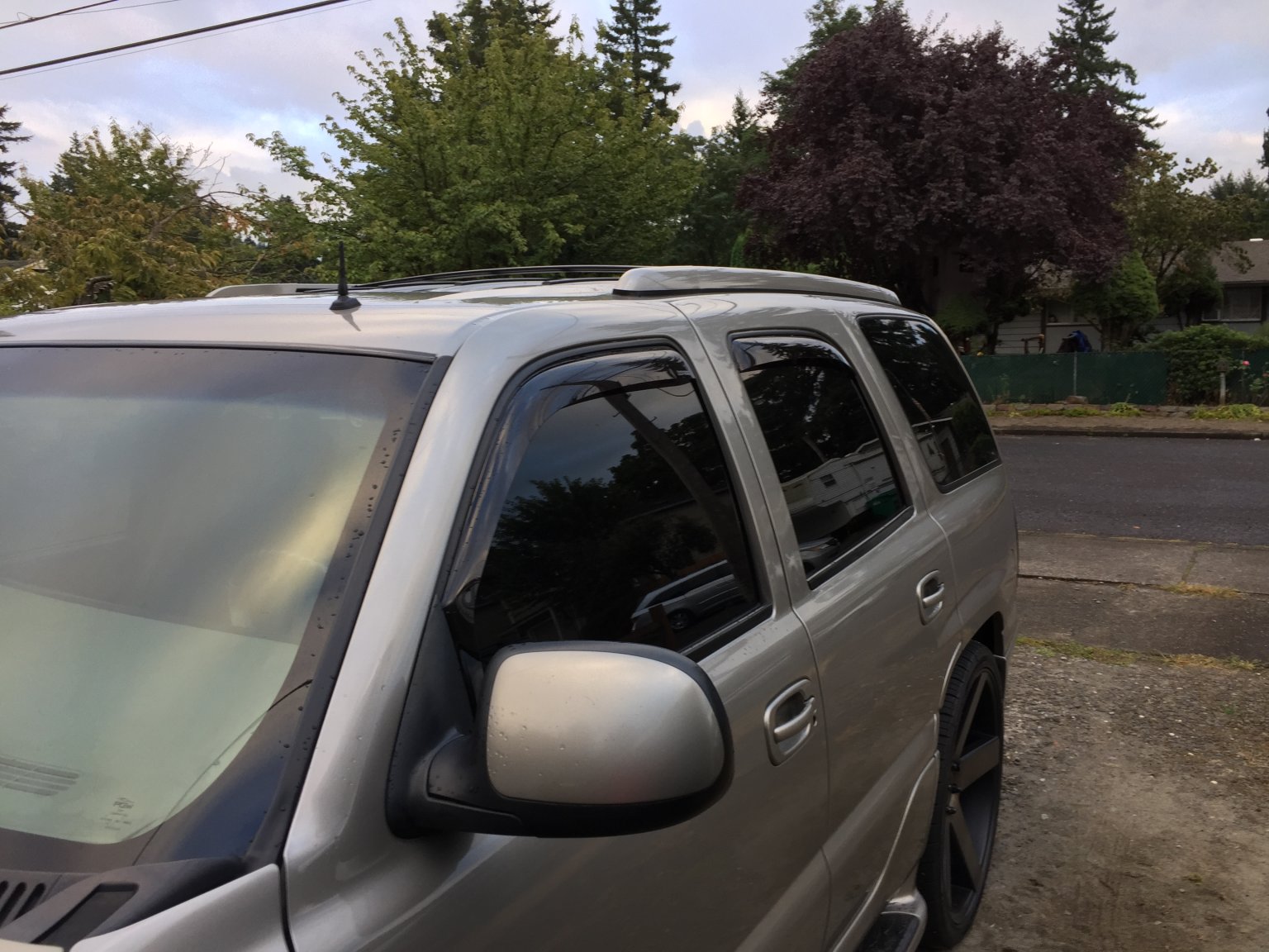

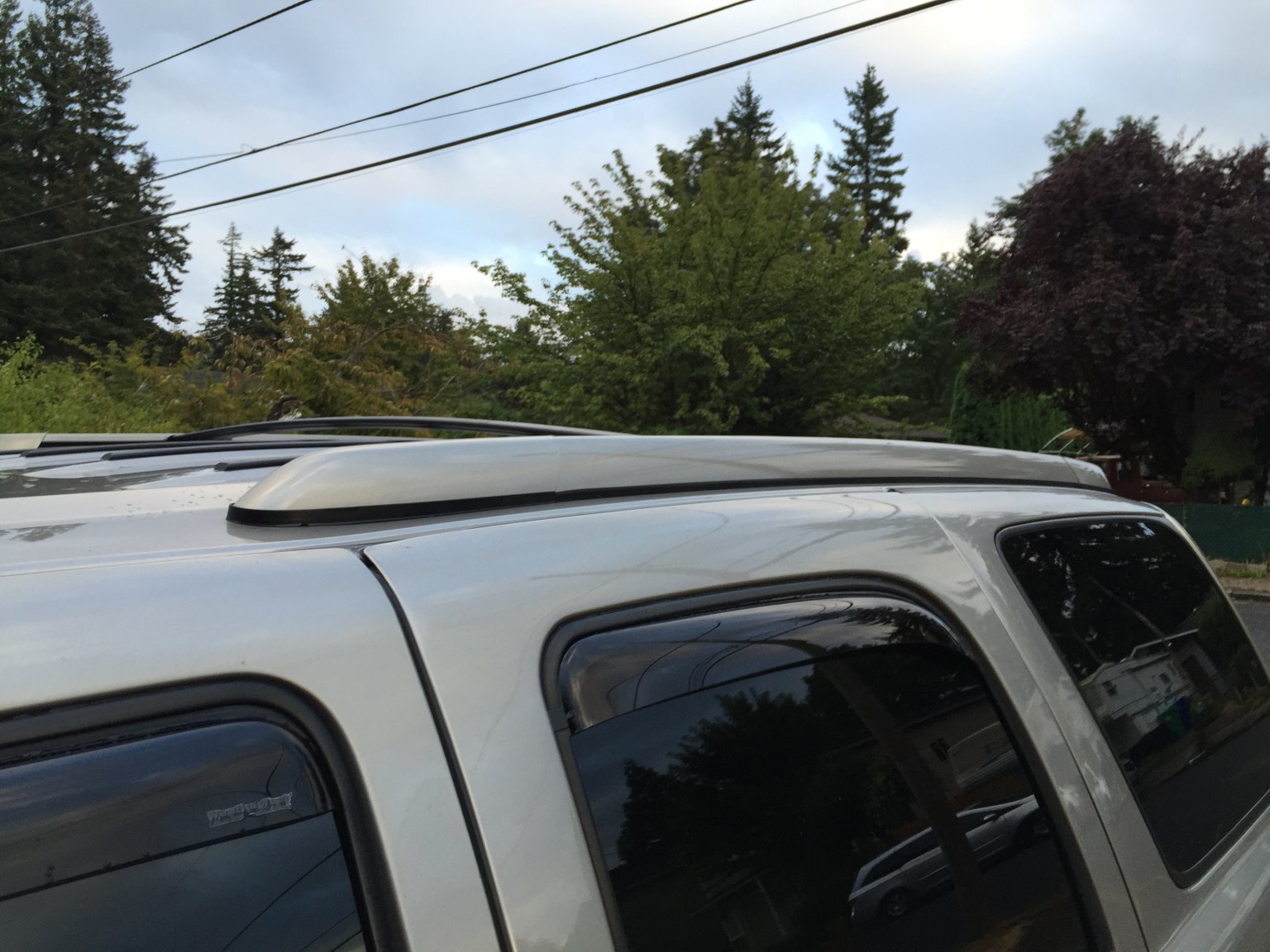

Today I removed the Denali roof rack and listed it on Ebay. Then I had to remove the marks on the roof where the old rack was because the Esky rack has a narrower footprint. I used Meguire's Fine-Cut Cleaner with a buffing pad and it's almost perfect.

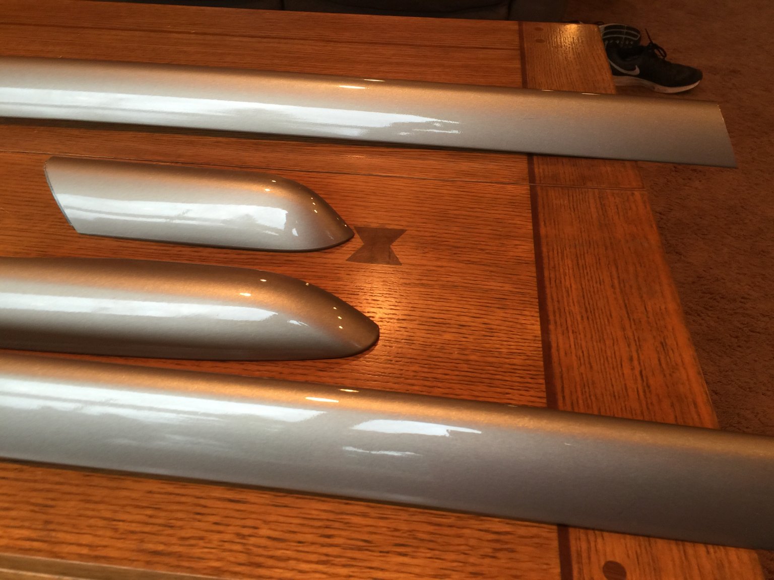

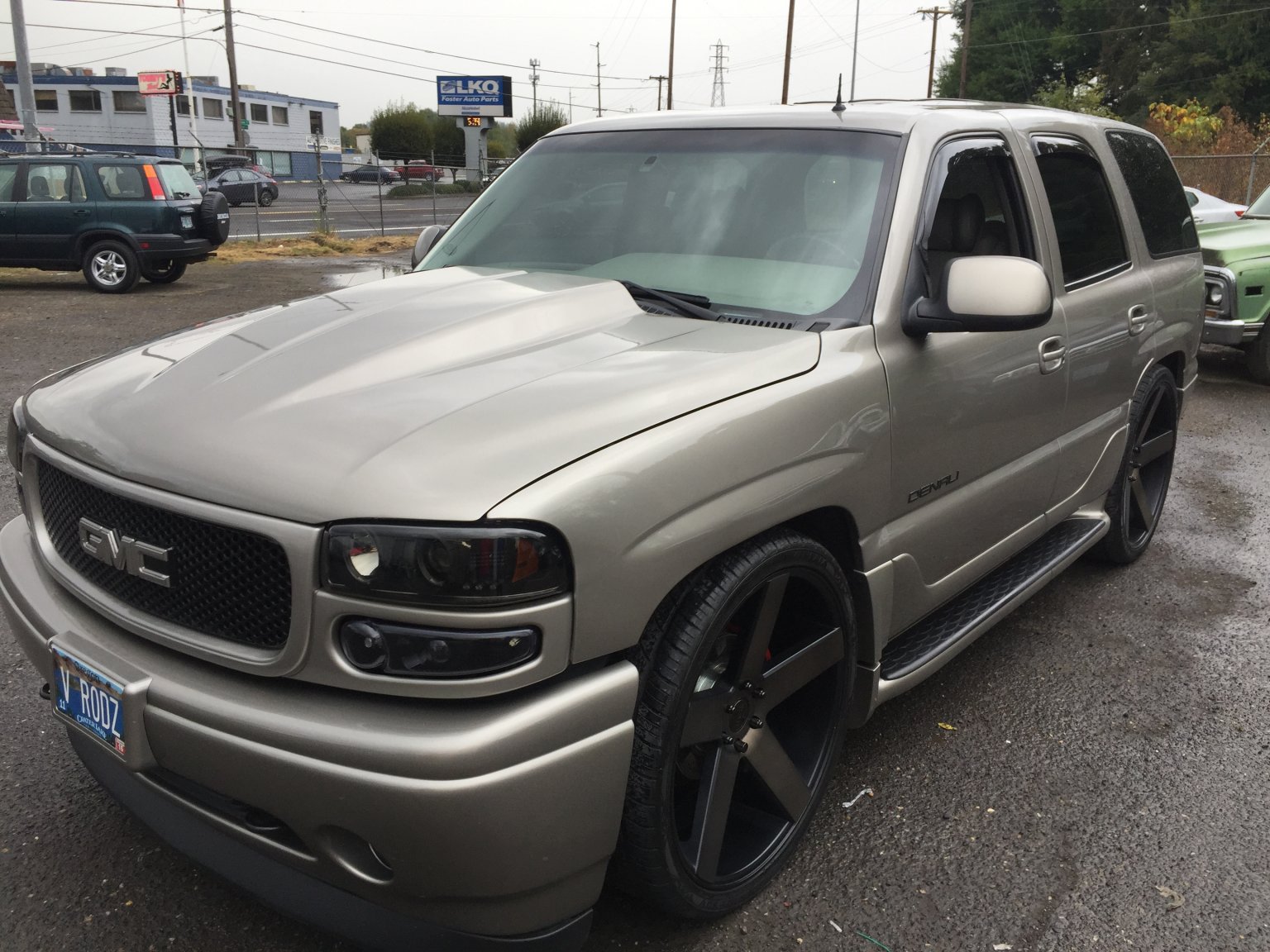

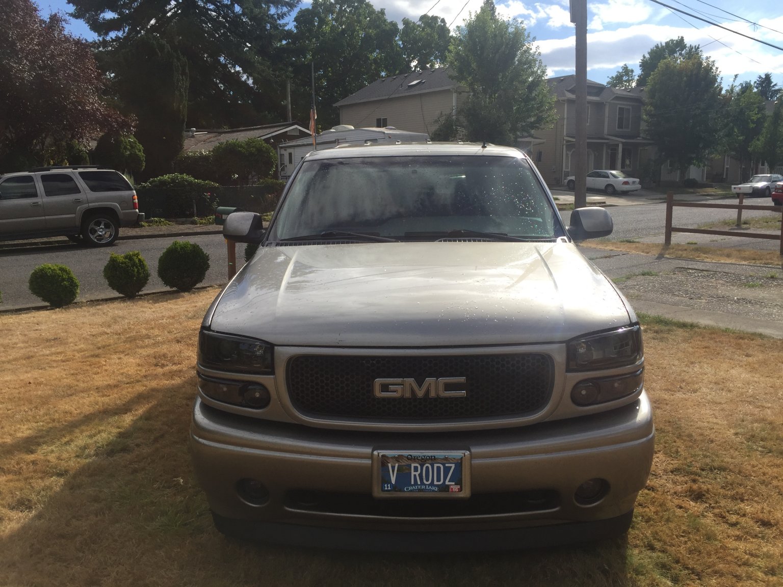

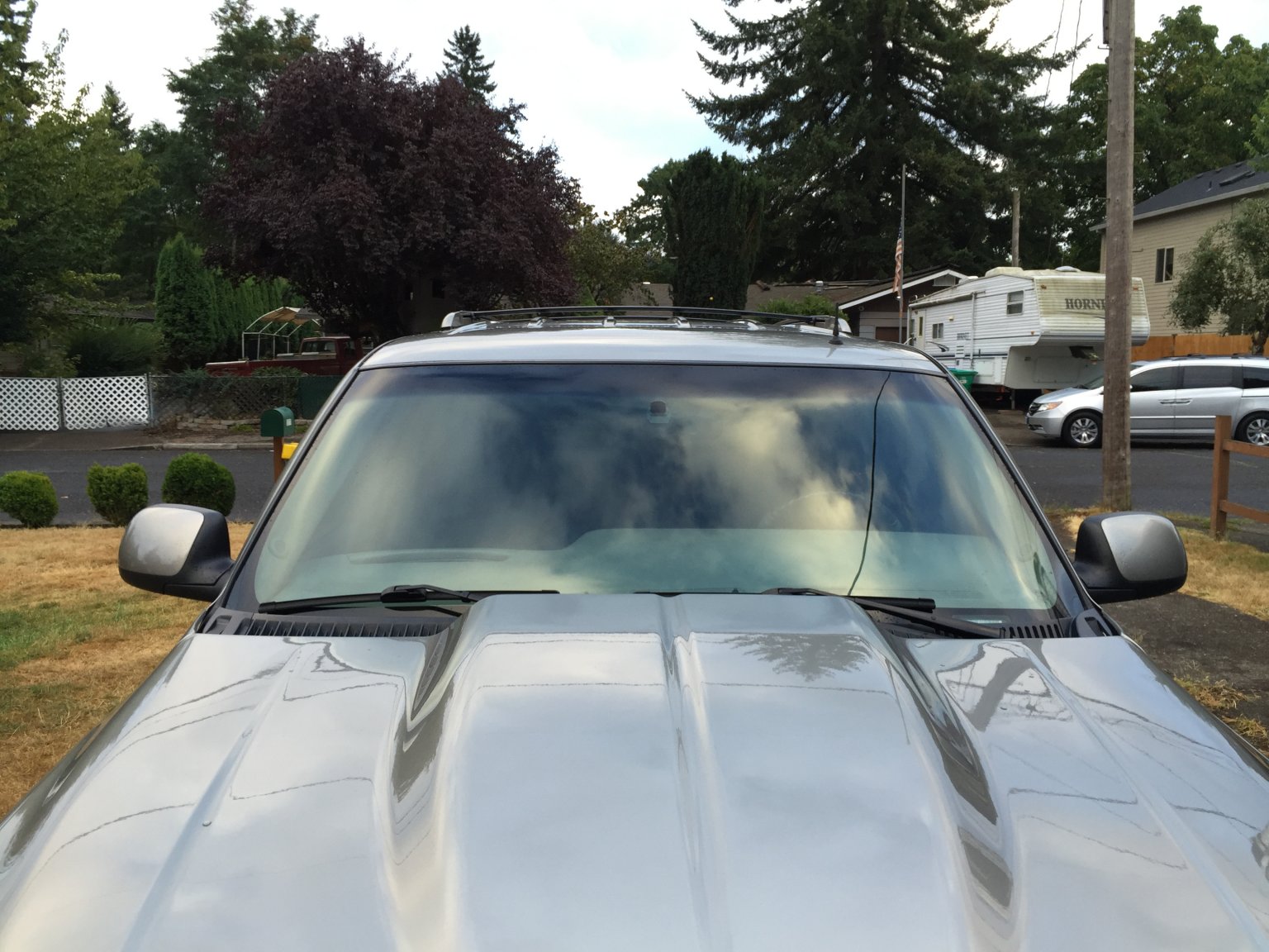

Got the Esky rack installed. Took me awhile- I had to figure out how to get the end caps to snap on right with no gaps. There was an adjustment that had to be made before I started attaching it to the truck. Of course I didn't figure that out until I already had it all attached. Anyway, colormatched is the way to go for sure.
52,954

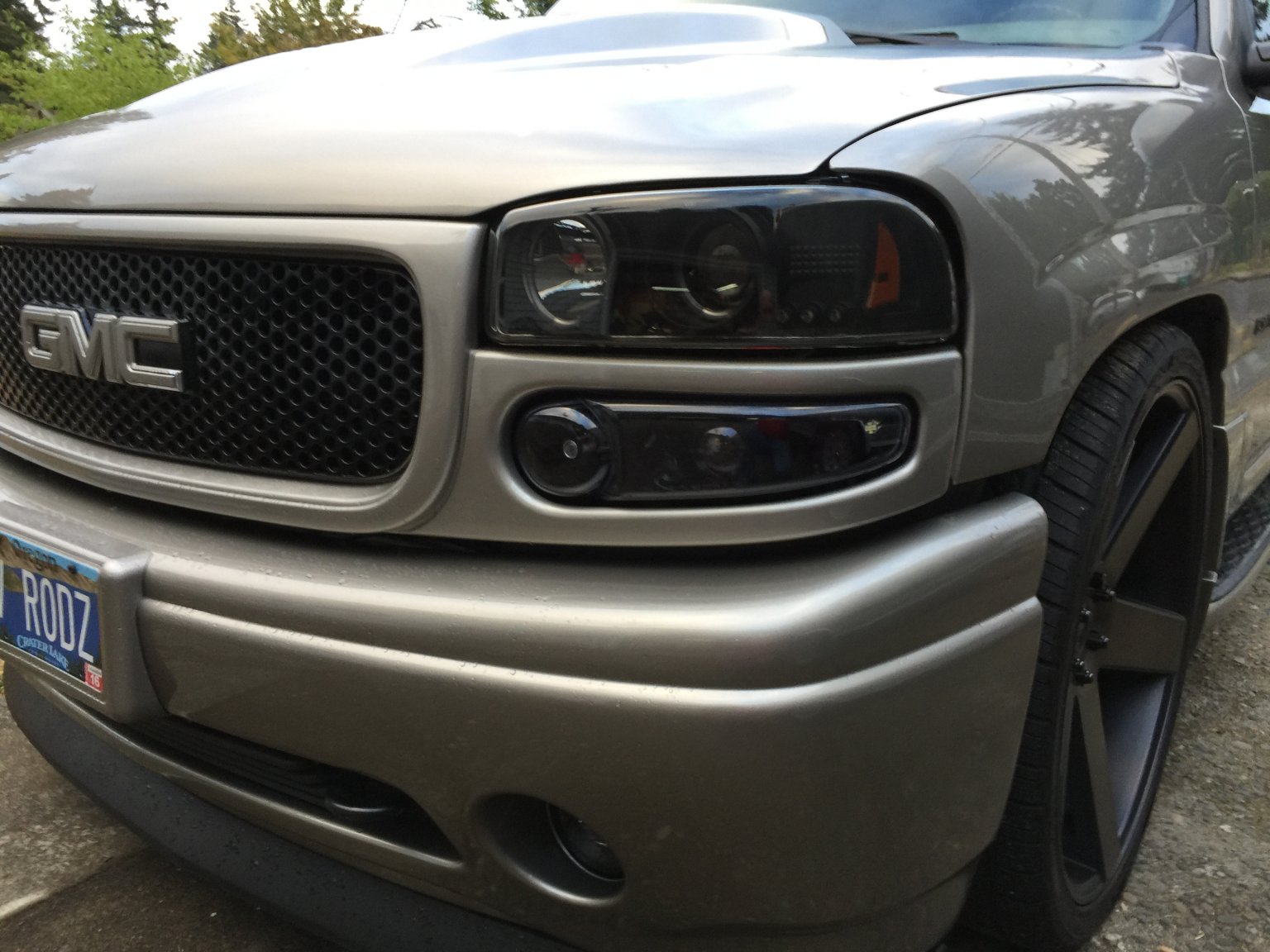

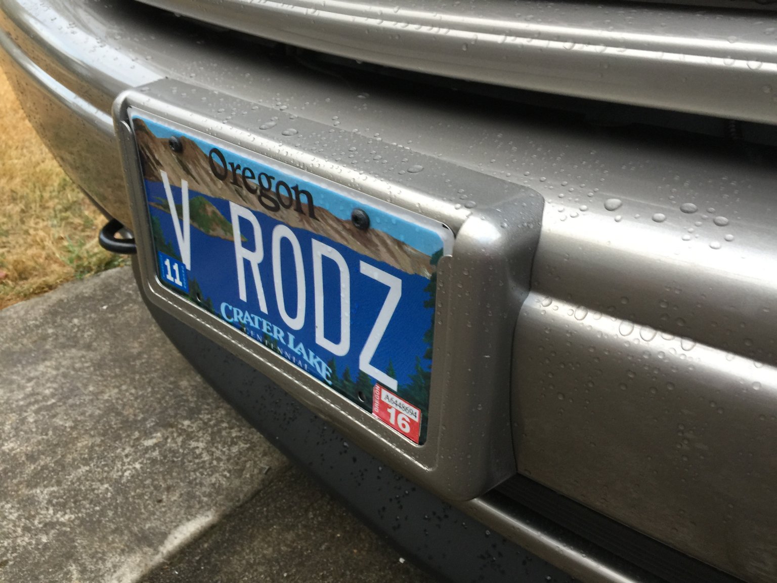

A few more shots of the paint. He repaired and repainted my license plate holder too, along with the complete front bumper and he blended and repaired the paint on both front fenders. there's one spot left that he found, and I had forgot about- a scrape on the rear bumper that he is going to take care of one day when I stop by. That will do it for paint, it will be pretty much flawless at that point.
