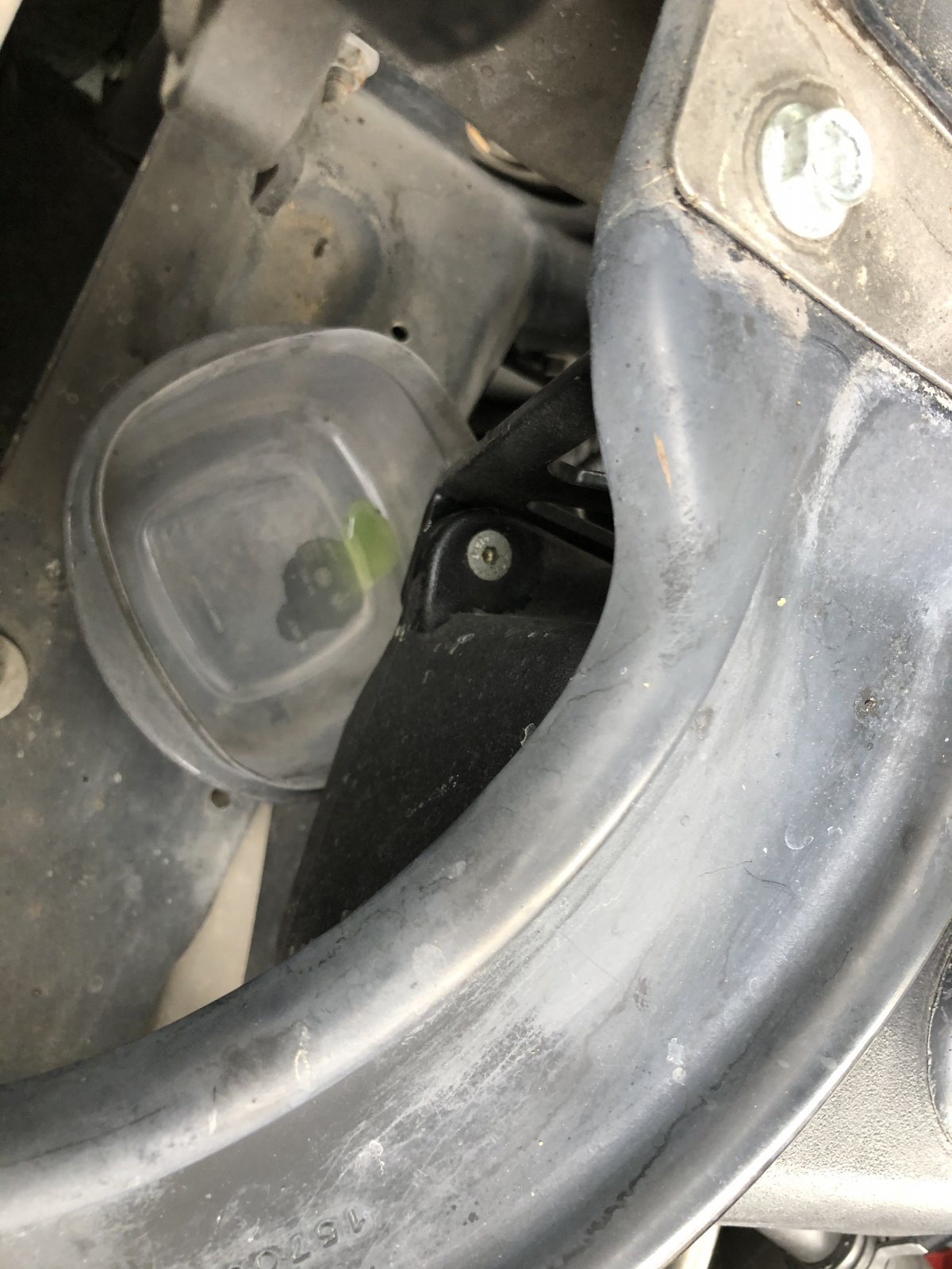

Thanks Chase. Well it looks like the reservoir tank for my intercooler has developed a leak. I don’t even know for how long, I haven’t checked the coolant level in it for at least a year, maybe two. I only thought about it because @Bombsquad85 saw it in my video and asked what it was which brought my attention to it. I added 1.5 quarts to the system and then noticed fluid on the concrete after a drive. It was nearly where the ac drips condensation on our trucks so maybe I didn’t notice the leak before because I thought that’s what it was. So I contacted Whipple to see about buying a new tank. And of course it’s been changed to a “Filler T” and to swap over it’s a measly $125. Plus shipping. I’m gonna pull the tank and see if I can fix it. It’s a slow drip so it might be hard to find or fix. I got 3 drips after the truck was running for 15 minutes.

Maybe you can soray the entire tank with Flex seal.

I have some Lord Fusor plastic repair epoxy, it’s the best stuff I have found. I found out about it from the bike builders when I cut my Harley fairing and raked it so my headlight wasn’t pointed at the sky when I raked the bike for a 28” front wheel. It had to be the best to hold that plastic together with the way a Harley shakes and vibrates. It never cracked or showed any sign of weakness. My issue I think is finding the leak, it looks like it’s coming from one of the mounting holes and only leaks, barely a drip, when it heats up and the system is under pressure. Whipple said it’s pressurized at 5-8 psi. I’ll know more tomorrow when I pull it off. I forgot to go pick up my 05 hatch glass today so I’m gonna do that tomorrow before I pull the reservoir.
